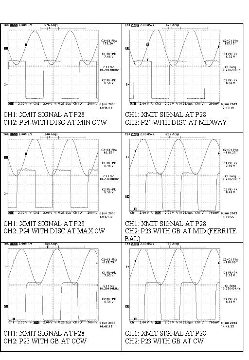

                  Hello Max - I saved an Oscillograph submitted by Goodrat that I believe was taken while scoping an honest to god working Bandito - although I can't say for sure - but it is very interesting.
                  Read the whole thread here:
                  http://thunting.com/geotech/forums/s...oto=nextnewest
                  From what you said about the direction of travel on your scope display, I believe your discriminate pot is wired backwards.
                  As the ground pot is moved Cw the ground reverence pulses should advance (move left). Turning the discriminate control CW causes the DISC reference to retard - moving to the right. (Thank you, Goodrat!)
                  Good luck
                      Good luck

                        Hi all,
                        I've substituted again caps...now I have again goodrat's values and now I get waveforms much similar to those present in the picture from him.
                        There are minor differences regarding initial phase but only in disc section. GEB section have the same timing of goodrat pictures.
                        I concluded (at least for now) that these are the right values.
                        I have also measured dc levels and now I get a maximum on disc analog gate output. I had inverted leads too on this pot, now is ok, and shift to right with cw movement.
                        fully ccw ---> -20mv
                        a bit cw ---> maximum of -25mV
                        fully cw ---> +25mV
                        Also geb dc signal pass through zero.
                        Seems everything ok now.
                        What to say...
                        Thanks to all,
                        Max

                          The information from porkluvr is very interesting. In fact, it has reminded me that the DISC on the Bandido is set so that ferrous targets are already rejected at minimum discrimination. In this case the maximum (i.e. max negative voltage) will occur when the DISC is fully ccw. This is confirmed by the first oscilloscope plot. The third plot shows that the DISC control has an adjustment range of about 45 degrees (pi/2). So all this makes sense now, and your DISC pot was definitely wired back to front.
                          The GEB control only seems to have a very small adjustment range, probably about 10 degrees. The Bandido design is particularly sensitive to the GEB setting (hence this small adjustment) and must be tuned very carefully as it also has an effect on discrimination.
                          Is it working as expected now with good discrimination?
                            Hi Qiaozhi,
                            yes now with goodrat's set of cap values I have better disc than previous (I already know this because I've tested before these values...but now I have diagrams too to compare).
                            Yes disc on iron is definitely better than previous. I've inverted disc pot leads and now I have right shift as expected. But have maximum not at one extrem but really close to it : at extrem I get -20mV where at maximum I get -25mV then turning cw signal increase till +25mV at other extrem.
                            So I have now a maximum in the inner range of pot, but really close to the left extrem position.
                            Yes, geb has only few degrees of movement much like in goodrat diagrams.
                            My diagram now like much like in the picture.
                            Yes, iron is rejected at minimum disc too. But with big masses happens sometimes it sound briefly.
                            Do you think I need maximum at the extrem for disc ? If so I need to sligtly modify disc cap, 2 or 3 pF I think.
                            Best regards,
                            Max
