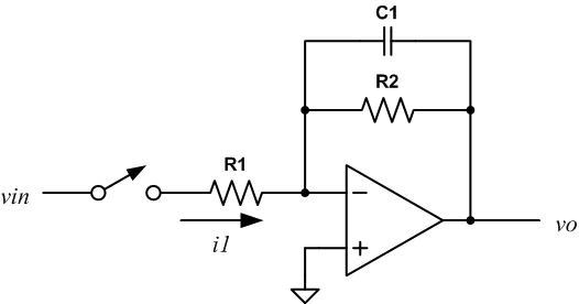

        The purpose of the integrator is to constructively add successive positive samples (resulting from a target) while averaging out everything else. That is, random noise (which is both positive and negative) will average to zero. So the integrator needs to have a charge rate that is fast enough (compared to the sample rate) to build up a signal, and a discharge rate that will get rid of the signal fairly quickly one the target is gone, so you don't get an audio response long past the target.
        So let's make up some numbers. Sample rate is 1kHz, so sample period is 1ms. Sample width is 10us or 1%. Let's say a weak target signal from the preamp is 10mV. A single sweep of the coil takes 1 second.
        We get 1000 pulses per swing, so as we go over a target we might get 10-20 positive samples. Let's say exactly 10. Without an integrator, this would result in 10 samples that are 10mV high with a 1% duty cycle.
        This is a time-averaged signal of 100uV and probably will never trigger the audio.
        Let's say we use a single-ended integrator shown below; R1=1k, R2=100k, C1=0.1uF. When the switch is closed vin (=10mV) is converted to a 10uA current (i1) by R1 and charges the cap. dv/dt = i/C1 which gives 10uA/0.1uF = 100V/s, so in 10us the cap charges up by a whopping 1mV. Wow, a whole millivolt? Yup.
        When the switch opens the integrator is left with R2 discharging C1, at a time constant τ = R2*C1 = 10ms. We have 990us of discharge time (sample switch open) so the signal drops to e^(-990us/10ms) = 90% of whatever the sampled value is. So when the switch is closed, the cap charges by 1mV, and when the switch is open the cap discharges by 10%.
        We assumed a 10mV signal for 10 samples, so at the end of each of the 10 samples we have:

        6.5mV doesn't sound like much, but it's 65 times better than the average 100uV without the integrator. And the integrator is usually followed by a gain stage so if it has a gain of 100 (e.g., HH) then the final voltage applied to the audio is 650mV. That's much better.
        Finally, when there is no more target signal, the integrator cap will discharge in about 3τ (95%) so a time constant of 10ms means the integrator output dies off in about 30ms.

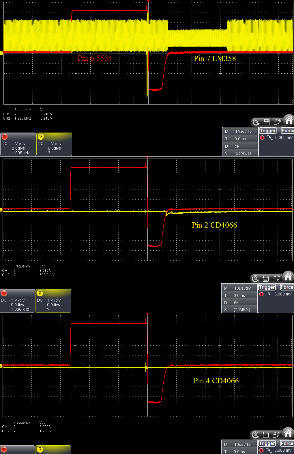

                  I ran into a problem with just that - experimenting.
                  Hope this is the right place to post this.
                  I replaced the 1M resistor at the front end (5534) with a 100k resistor.
                  So far so good. Less sensitivity, but much less noise.
                  Changed the resistor at the output stage U3A LM359 from 100k to 330k
                  and the capacitor from 100nF to 33nF.
                  I cannot adjust threshhold anymore and have substituted the 33nF with 22nF, 47nF.
                  Nothing changes.
                  Something seems amiss further upstream looking at Pin 7 of LM358.
                  The inputs/outputs of 4093 & 4066 appear to be working fine.
                  I have substituted all IC's and I still have the same problem.
                  Here is the oscilloscope picture (Pin7 LM358, Pin2 4066, Pin4 LM358 and Pin6 5534 as reference)

                    I think you shouldn't see the oscillation on pin 7 of the LM358. Trying to drive a capacitance load can cause an OP amp to oscillate. Don't see one on the schematic. Driving a length of coax can be enough capacitance.
                      Hi polymer
                      Wondering if you solved the oscillation on pin 7 of the LM358. Couple things to try, add a .1uf ceramic on the power pins 4 and 8 to common, remove the 1uf capacitor on the output to see if the oscillation changes. Haven't played with a Surf PI, just curious why the oscillation.
                        Hi polymer
                        Hello Green,
                        Thank you for your tips!
                        Yes, I have solved the problem But none the wiser
                        I do routinely put in ceramic decoupling caps where they should be.
                        I removed C7, no change.
                        Removed C6, no change.
                        Removed R16 ... Bingo ... Oscillation gone.
                        R16 was "jumpy" when measuring the resistance.
                        Put in a new one. It now works. Dunno what was going on inside that somehow defective resistor.
