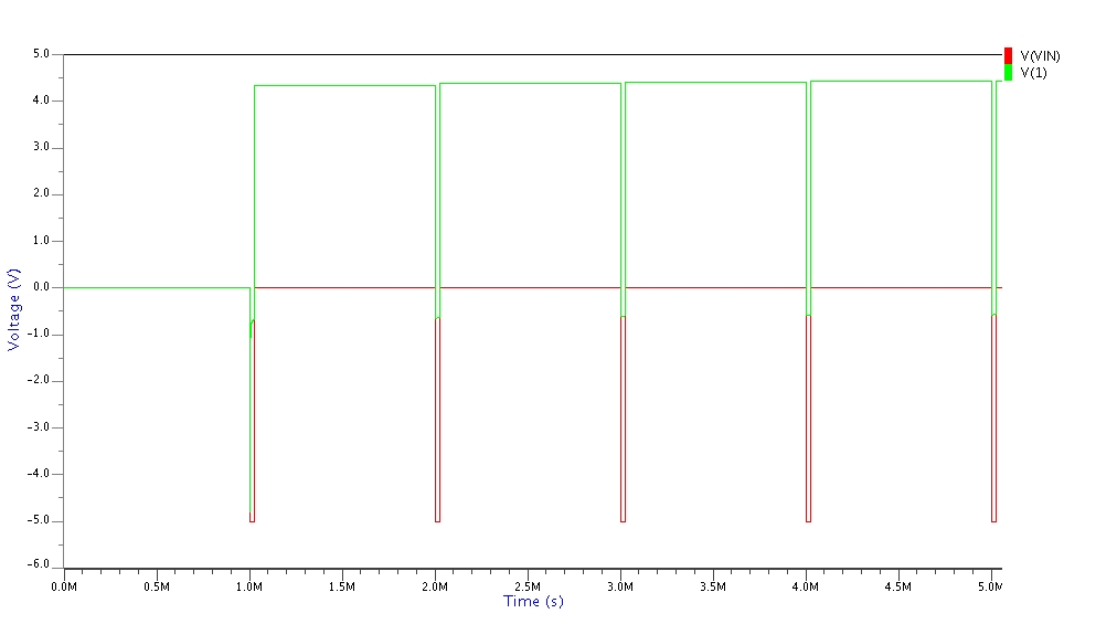

    • Originally posted by sisco View Post
      i have a problem in my schematic . see picture , must use one level voltage between atmega8 and 4051 so use CNY17 but CNY17 out pulse is with delay and not clear , i busy for this.
      can somebody help me , i need negative voltage converter like GS4 power.
      GS4 converter voltage is good but this is positive and i need negative.
      Hi Sisco,
      This is the simplest circuit I can come up with that will do the job.
      Please see SPICE netlist attached and waveform file.
      If the 4051 cannot handle the waveform going negative by about 700mV, then simply apply an offset voltage of 700mV to the anode of the diode.
      Hope you can understand the SPICE netlist. If not, I'll create a quick schematic.

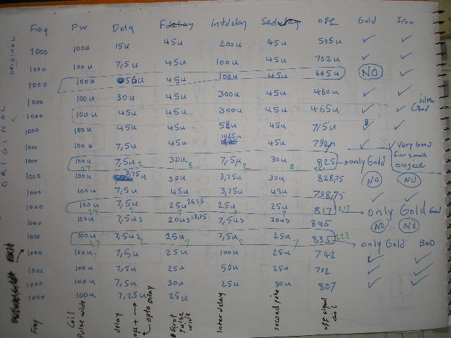

                about : r42 and r49 this only for LCD setting (chracters lighting)
                X15: for LCD inside light diode (you can don't use)
                about "function about each element" , this is Physicochemical object.
                example : best delay for detect gold : ~ 18us after off pulse coil
                but in this delay can't detect iron
                or best delay (max sensivity) for detect silver : ~ 55us
                but in this delay can detect gold and iron
                see this picture (this is for 7 month ago):
                you must follow this method if you have free time.(this is very easy if you can work with AVR)

                      • broken diamond , see this example .
                        can help you.
                        in this example :
                        freq = 1Khz
                        coil pulse wide = 200us
                        delay = 19us
                        samp pulse wide = 38us
                        inter delay = 75us
                        ground pulse wide = 38us
                        off pulse = 630us
                        for freq 1000Hz = period is 1ms (1000us) so =>
                        200+19+38+75+38=370us-1000us=630us
                        important in these timing is "delay"
                        you can programming your minipulse with this program and work.
