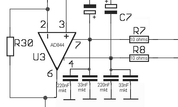

IF YOU HAVE MAKE , TRY THIS .
    Hi Geo ,
    In home , I can only use small coil (home armature , metalic desk , chair
    leg , .....) .
    try this , I test yesterday and work very well.( with original minipuls-3 ,
    (12 volts battery and one V-mos):
    1- use AD844 for U3
    2- replace R7 & R8 with 10 ohms resistors.
    3- connect 33nF MKT and 220nF MKT (parallel) capacitors between pin 4
    U3 and GND and between pin 7 U3 and GND (two capacitors parallel with C7
    and two capacitors parallel with C8 .
    you can test with this change and see yourself this metaldetector with
    small coil can detect 50*50 cm metal plate morethan 120 cm distance .

                            Best adjustment
                            For find coin more at 30cm you must do these :
                            1-first do anything I told in my post (about AD844).
                            2-use 100 ohms trimmer and connect two heads of trimmer between pin 1
                            and pin 8 AD844 and middle heade of trimmer connect to pin 7 AD844.
                            3-disconnect coil and remove microcontroller ( ATmega8 ) and remove R6.
                            4-turn on meteldetector . use ossiloscope and connet to pin 6 AD844
                            and adjust trimmer for zero out.
                            after do these and adjust RANGE and TRESHOLD potentiometers (my
                            POWER and GAIN potentiometers always is last degree) you can with
                            small coil detect small coin more at 30 cm.
                            be successful.
