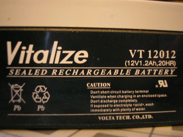

                  Hi Sisco,
                  The Volta Tech Vitalize battery is a sealed lead-acid battery. According to the manufacturer, it is an absorbed glass mat battery, not a gel cell. This battery uses special baffles to keep the electrolyte from spilling out rather than adding a gelling agent. Also, the Vitalize battery uses special lead/calcium alloy plates and catalysts that recombines the gases generated. This battery is advertised with very good specifications, but the charging requirements are not given. http://www.peesinc.com/battery.htm
                  The printed information on the battery (12V 1.2Ah, 20HR) means this battery will deliver 1.2A-hr when discharged over a period of 20 hours. This means this battery has a capacity to deliver 60ma for 20 hours before discharging the battery. If you run it at higher than 60 ma, then you will get less than 1.2 Ah from this battery. For example, 600 ma will not give 2 hours running, but lucky to get 1 hour.
                  You would be safe to charge this battery at C/10 for 10 hours or 12 hours. There is no advantage to charging at a lower rate for 20 hours. The optimum charging would be to charge at 25% or C/4 for about 80% of its capacity, then switch to a slower rate, or "float" for the final 20% of capacity, preferably C/10. This battery should not be charged at higher rates because fast charging causes them to heat up excessively, which causes the release of hydrogen and oxygen. This release causes the electrolyte to dry up. While the Vitalize battery claims to use special chemistry that recombines oxygen as it is produced, I would stay on the safe side and use C/4 or slower, like maybe C/10. One way you could determine if this battery is fully charged is to detect when the vent hole begins to discharge a small amount of gas. This indicates the battery is fully charged.
                  You can get longer service life from your Lead-acid or gel cell batteries if you do not allow them to discharge to low voltage. The worst damage is caused when a lead-acid battery is left in the discharged condition for a long time. The best practice is to recharge the battery when it is partly discharged, using a C/10 charge for the calculated amount of time needed to restore full charge. The Vitalize battery can probably be charged for a longer continuing C/10 for trickle charging as long as 18.8 volts is not exceeded.
                  If I owned this battery, then I would charge at C/10, and I would calculate how much charge time is needed depending on how much discharging power was consumed. Also I would look at Nimh replacement. I believe you can use NiMh for less weight and more power (10 Sanyo Nimh AA cells give 2.7Ah and total weight 300g).
                  Best wishes,
                  J_P

                    Hi JP,
                    http://www.peesinc.com/battery.htm is not the website of manifacturer.
                    Website is: www.voltatech.co.kr
                    Is a korean manifacturer that made gel-type also. I'm not sure that the VT12012 is lead-calcium. I think could be also gel-type, sealed battery.
                    Even if it has the "Vitalize" stamped over.
                    Anyway, this is not big difference... cause both have the security valve system for the excess pressure (10psi) due to H2 release... so lead-calcium plates are not so safe if one charge e.g. at 1/4 or more of capacity.
                    Battery manifacturer is based in Korea, but factories are located actually in China.
                    VT12012 data are:
                    voltage 12V
                    nominal capacity 1.2Ah (20H)
                    capacity 20H 1.2Ah (60mA)
                    capacity 10H 1.1Ah (120mA)
                    lenght (mm/inch) 99/3.90
                    width (mm/inch) 43/1.69
                    height (mm/inch) 52/2.05
                    total height (mm/inch) 58/2.28
                    weight (kg/lb) 0.60/1.32
                    Charge is the same for both types, as explained.
                    Constant voltage (13.8V) + current limiter.
                    1/10 current limit is good.
                    Best regards,
                    Max

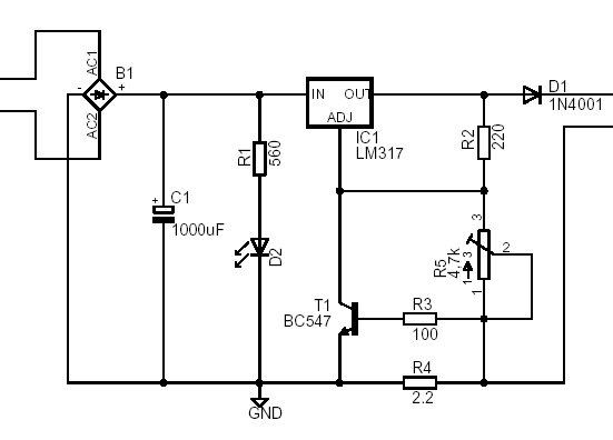

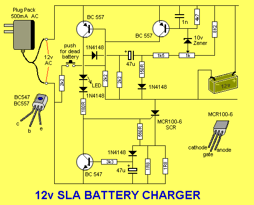

                      this is 2 good battery chargers for lead acid battery like your battery SISCO
                      • #71
                        another charger

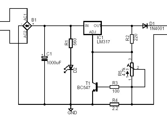

                        I have another good and simple schematic too:
                        Just set the trimpot to read 13.8V at the output leads.
                        - NOTE : the 2.2 ohm resistance fix the current limit
                        that is 1.25/2.2 = 0.568 Ampere that is big
                        It's good e.g. for bigger batteries... e.g. 4Ah or more
                        But for smaller ones I suggest use always the 1/10 limit so putting a right value.
                        It's very important do so cause a big peak current in initial charge phase could seriously damage the battery (could also explode etc).
                        So use 1/10 ... find value as always 1.25/Ampere-limit
                        example:
                        1.2Ah -> 1/10 * 1.2Ah -> 120mA
                        +3% and round -> 125mA
                        1.25/0.125 -> R = 10 ohm
                        Best regards,
                        Max
                        PS: you could leave the battery attached as you want with this type... keep battery always in charge as voltage at its leads drops.

                              Hi Great_alex,
                              Those are nice circuits for charging batteries. I presume the 500 ma 12 vac transformer is provides 12 volts when connected in the circuit under load, and has a higher voltage at no load.
                              The two circuits you show are for SLA and for Gelled lead acid, which require two different charging voltages. We should note that the Vitalize battery, according to the manufacturer is an absorbed glass mat type sealed lead acid battery, not a gel cell. So this battery would use the first circuit shown at the top of your post. The Gelled electrolyte batteries require a slightly different voltage to prevent damaging them.
                              Best wishes,
                              J_P

                                current mistake...
                                I've made a mistake in previous post about current calculation.
                                LIMIT IS
                                0.6/R ---> 0.6/2.2 = 272mA that is always hi for e.g. 1.2Ah battery
                                Good value for 1.2Ah battery is 4.8 ohm (limit at 125mA).
                                Sorry for that...was in a hurry.
                                Circuit works perfect with both gel-type or adsorbed-glass-mat.
                                Just rotate the trimmer to get 13.8 V at output.
                                Use an AC 18+V transformer with it.
                                Kind regards,
