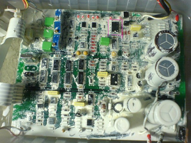

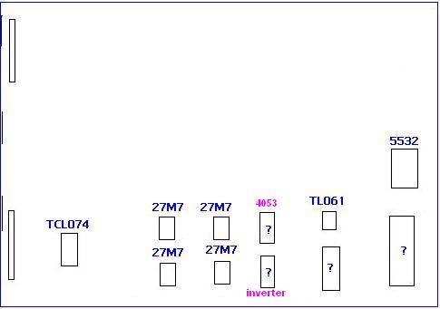

    A few people have worked out most of the chips on the Minelab SD2000, can others fill in the blanks? The SD2000 is still the deepest detector of the Minelab range. The one thing that im sure is worth modifying is the P & N channel FET front end, the next IC in line that is a matched transistor pair.

      Just done some more measurements and found that the front end is a P @ N channel J fet long tail pair feeding the LM394 dual NPN current mirror setup.
      Minelab made a poor effort designing the front end but maybe that was cutting edge back in 1994.
      All the front end can be improved 100% just by changing to newer components. The one IC that has be stumped is the 16 pin chip in the audio stage, is it a designated audio IC or is it a VCO? The SD2000 has very low audio output maybe 200mw so it could be an opamp arrangement ...more detective work required.
        Hi Woody,
        About SD2000 chip part numbers. Had problems with the MOSFET on the input to the main preamp. Was able to fix this and know actual part number. Will pull covers off box and confirm part number and location as per your layout schematic. Will do it over the weekend and post reply. At least one chip less in the puzzle.
        Stefan
          The front ens fets are P Channel ZVP4105 abd N channel VN2410 and there must be better versions of these J fets around now.
          I have the chips numbers for the other board as well and I will post it except for the 16 leg audio stage device.
          I also have nearly finished a track layout for this detector as well.

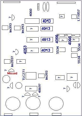

                Here are the chips from the other SD2000 board, soon all will be revealed, there really is not that much difference in the newer detectors except for a micro controlling timing and clock functions, no wonder Minelab grind off the chip numbers, must be scared somebody might reverse engineer their circuits.. lol

                    I have not traced out the FET area but I have done the Matched pair in the second stage and the input on pin 2 connects to the reverse connected diodes.
                    If the J fet is just a gating device then there are better fets with just as high voltage rating and lower RDS values. I will need to sus out that part of the circuit.

                          Possible chip
                          Woody,
                          The 16 pin chip maybe a LM13600 or a cd4046, both can be configured as VCO circuits. Keep up the quest.
                          Mark
                            well done
                            this is great stuff
                              The audio chip vco/opamp?? 16 pin dip still has me stumped except that pin 5 is Negative and pin 12 is positive pin 9 and / or 13 are inputs ... That must narrow the field down a little.
