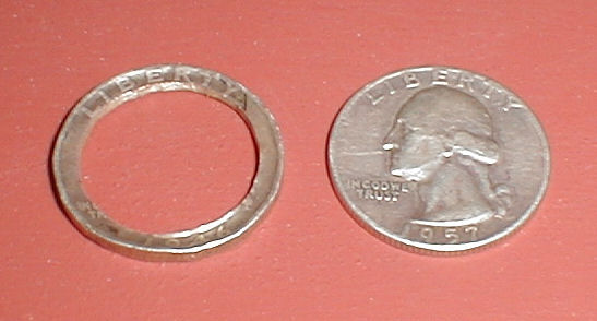

          • Here is what I originally used to test coin vs ring response. I like the idea of making variable-sized holes to see where the best response is. Another idea is to machine a series of aluminum rings that will snuggly nest inside one another.

                Broken or open rings are notorious for their weak signals.
                One interesting test to add to the series, would be a full coin but cut to the center.
