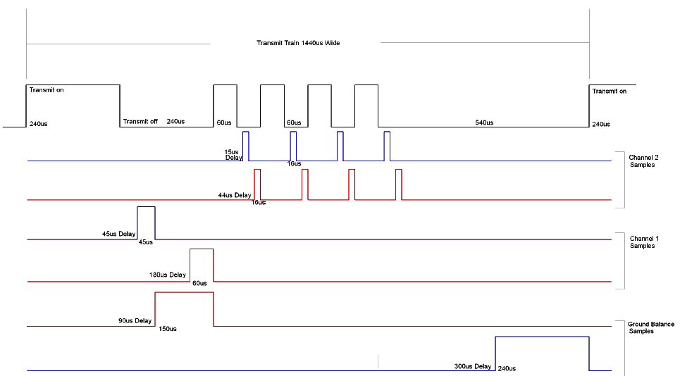

    Hi bbsailor,
    your proposals needs to be investigated deeply. And I see therein much potential to increase the signal-noise-ratio (SNR) and the stability of detecting.
    I have allready planned a computer simulation about the amplifier and demodulator stage of the PI and the implementation of the lock-in amp.
    Do you know the timings from gate 52 to 57 (on page 1)?
    window 1:
    gate for non-inverting signal: 52
    gate for inverting signal: 53
    window 2:
    gate for non-inverting signal: 54
    gate for inverting signal: 55
    window 3:
    gate for non-inverting signal: 56
    gate for inverting signal: 57
    Unless I don't know the timing behaviour, I can not say, if there is more potential to get. This is necessary for me to analyse, how the "lock-in" in the demodulator stage is implemented and whether there is room for further enhancements.

      Aziz,
      I don't believe that Bruce Candy mentions all the timings in the patent but I believe that the long pulse on figure 2A is 240us long (Bruce states this and .25ms) and each of the four short pulses is 60us long.
      Figure 2B is 50us wide or maybe 60us?
      Figure 2C is 60us wide
      Figure 2D is 60us wide
      Figure 2E pulses are each 15us wide aligned with the TX flyback pulse.
      Figure 2F pulses are each 15us wide and delayed until after the TX pulse.
      You should be able to figure out the timings between the pulses.
      Go to the following link to see a schematic of the SD2000 which looks like an implementation of the patent. http://thunting.com/geotech/forums/s...ad.php?t=14001

        Hi bbsailor,
        yes, I found the timings and there is definitely room for enhancements! As I can see, the SD2k does not really implements a true lock-in amp. It is an approximation process to lock-in amp only.
        On channel two with four sampling windows, this gets more like a lock-in amp. This is necessary, to increase the SNR and making the detector stable.
        Channel two is very likely for short time constant targets (gold) and channel one for long term (iron). The SNR can be increased by increasing the number of sampling windows.
        I will implement a simulation on the timings (see below) and will compare this to a real lock-in amp.

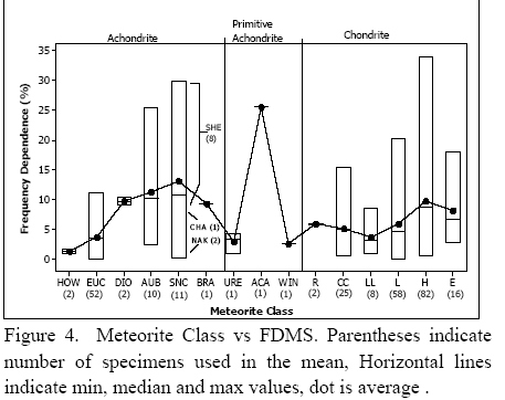

                        Demagnetization by air gap
                        TNX B^C,
                        I need help from you and your old technical Bible, because designing meteorite locator, I have problems with the magnetic properties of soil and meteorites.
                        I'm experienced in QRP radio. In our "Q code", the term QRP means radio communication with extremely weak signals covered with noises. There exists and such one odd hobby.
                        I have build a meteorite locator using as platform a Bulgarian Mine Detector MT66 (produced in 60-es). My machine can locate small stones sticked into soil if they have magnetizm or conductivity, very slight different from emvironment. Now I have a useless collection of near tausend stones, none of them is meteorite.
                        It is known that iron meteorites have very weak magnetizm – relative permeability is faintly above 1. Unfortunately the dry soil here has near the same permeability. The problem is how to iluminate environment with magnetic field in order to make response from meteorites different from those of sand. My radio colleagues think that should be difference in demagnetisation. The hysteresis cycle of soil and stones should be different because of a phenomenon named “air gap” or “nonmagnetic gap”. There is more air gaps between grit in sand than between magnetic domains in the stone. Please, browse your Bible for information about demagnetisation. I stop here because this is unimportant information for other participians, and because I should write a posting for Aziz. Hi again uses a wrong term.
                        Regards Mike.
                        • #57
                          I meant with XL (w*L) the reactance of the coil of course.
                          I will write only X in the future.
                          Aziz
                          Dear Aziz,
                          X is not "reactance of the coil". This is reactance of the target seen by sensor. If the sensor has TX and RX windings, they both "see" the target. If our target has a timeconstant, that means it has a "coil" connected to a "resistor" but how our sensor sees their reactance? It is not reactance of the eddy coil.
                          The reactance X of single eddy current target is
                          Oops, I can write formulas. To be continued in other formats.
                          • #58

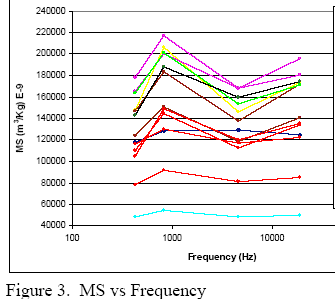

                            It is known that iron meteorites have very weak magnetizm – relative permeability is faintly above 1. Unfortunately the dry soil here has near the same permeability. The problem is how to iluminate environment with magnetic field in order to make response from meteorites different from those of sand. Regards Mike.
                            Gday MIke,
                            I have given your comments considerable thought--sleepless night & searching for related information to your question which is a good one.
                            Your comments on the soil there having the same permeability as the meteorites your looking for i found very interesting. You said that the metereorites have very weak magnetism with relative permeability faintly above 1.
                            Of course i am not sure on what Class of Meteorite your after.
                            I may be wrong--again, but it is my understanding that the meteorites Magnetic Susceptibilty--MS is "Frequency Dependant--FD" & the MS is increased with the correct inducing Frequency. This may be an avenue to explore because the MS of the surrounding Matrix would surely differ than the meteorites correct frequency for higher MS.
                            The frequencies i have read about are :
                            465Hz, 825Hz, 4650Hz & (19000Hz but i'm not sure you want to go there.)
                            825Hz seems to give some good results & i will attach a couple of graph's to look at.
                            If this is right maybe you could try some of the different frequencies & make them variable +/- 100Hz to experiment.
                            I think the first thing to do is run some frequency tests on your Matrix conditions to get some MS figures & then isolate the meteorites for some comparitive testing.
                            This may help, or maybe not, let me know?

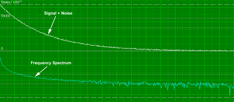

                              First Test:
                              The signal decay function has a quite broad band frequency spectrum. As the signal has to be modulated for the lock-in amp, the lock-in reference frequency should be synchronized with the PI timings.
                              First quick & dirty hacks shows, the windowed integration of the signal can be improved by using the lock-in amp. The noise will be reduced and the SNR will grow.
                              Now it makes sense, to analyse this deeply and to write the software for this.
                              It will be not easy to use a real lock-in amp in PI's. Particularly the modulation of the signal must be done properly to avoid additional noises.
                              Attached: Frequency spectrum of the signal decay function.
                              Aziz
