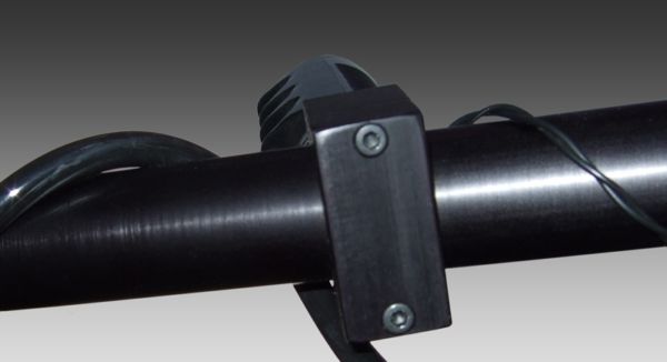

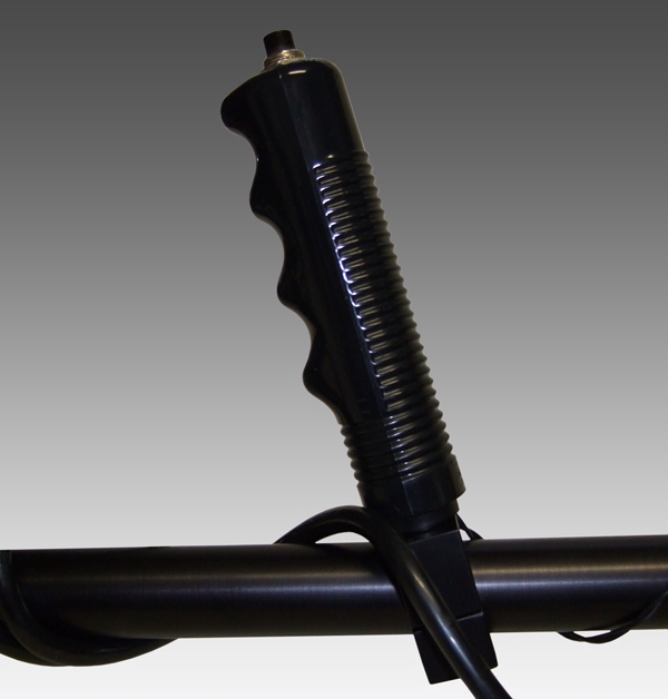

      Don't want to be negative so will be careful here,
      but those little wires that come from the hand switch
      look a bit fine for a clod like me who would probably hang them
      on some bush or something and rip em in two.

        I think you understand it wrong... It's clearly a prototype of the analog version.
        The thin wires you see are probably a power cord from battery to the electronic control box, with yellow panel...but this is sure a proto. Maybe in definitive version would be some spring-loaded extensible cable... like old phones have.
        I think the battery had to be carried hip-mounted or under arm... but not inside the control box like in other designs that are really heavy cause of battery inside.

            so , as I see, the thin wires are for button on the handle... and battery must be inside the box... thing that I don't like much.

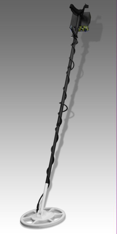

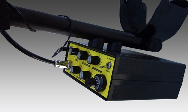

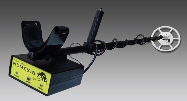

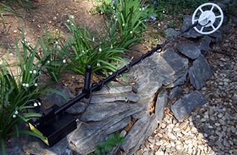

              Nemesis pictures 72 hour copyright removed.
              The attached pictures are of the Nemesis.
              bugwhiskers

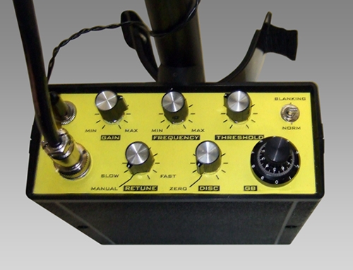

                much better
                Hi bugwhiskers,
                Thanks that is much better !! now I can see the 10 turn pot they were talking about.
                I was like Huh? no controls, anyway not sure thats the best place for them because
                of dirt everytime you set the machine down to dig up goody.
                Hi Max,
                Yes it is for the button, seeing more I guess they could be replaced easy enough
                and some duct tape could maybe help. Ok, it looks more like a detector now.
                Though I guess the "perfect" detector would be Turn On and Go.
                Auto ground and everything.
                But then no endless discussions about how to best adjust the things,
                and if someone calls and complains, just say you don't have it adjusted
                correctly.
                  Hi JC1,
                  Deep large targets produce a signal that is broad. Auto ground balance will very happily null out such a target treating it as a slow change in ground.
                  Notice the knob called RETUNE, it has fast to slow and Manual.

                    Hi Bugwhiskers,
                    It depends on how fast the auto ground balance is running whether it will
                    null out or not a deep large target. I do like the names on the knobs, the names
                    make sense to me and I could probably run it without reading the directions,
                    which is how things should be.

                    I also like the 10 turn pot knob, I use four of those on my homebuilt units.
