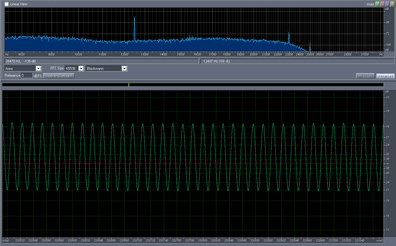

      Attachment is signal filtered only with RC...

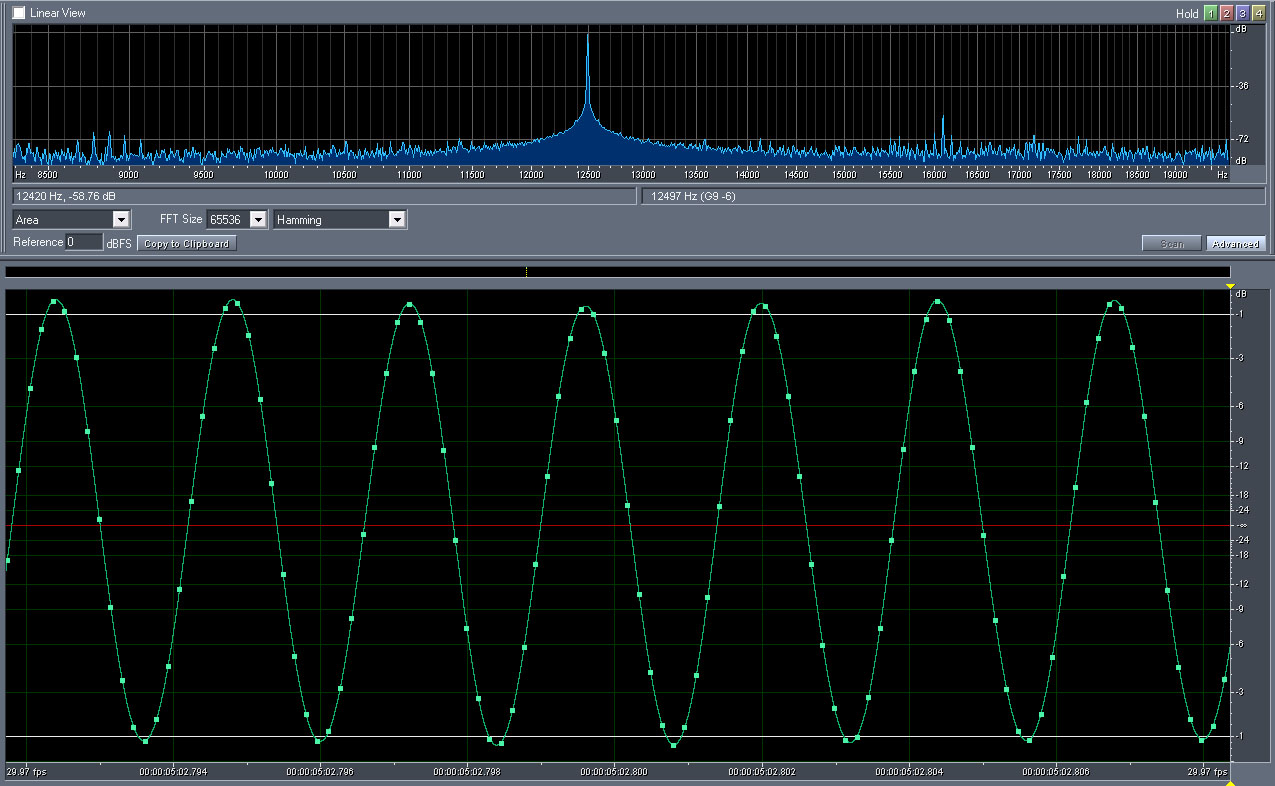

          Coil (unknow) not tuned for resonanse...
          First harmonics at -40dB,
          Sample Rate harmonics at -72dB
          (soundcard records and graphic)
          Now the question is: Parallel or Serial resonanse?
