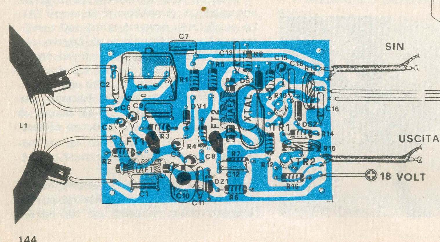

    Before some days i read a thread about an old BFO metal detector. It uses a rf choke with name AF-555.
    Does someone know something about it? I am interesting for the inductance of the choke. I remember that before 20.... 25 years we used this choke at AM transistor transmitters.

    Geo , Some old BFO'S were high as 500. khz, could this choke be around 555. khz ? And some chokes were used with I.F. Frequency 455 khz for a.m. radio Band. Maybe was for a Russian BFO ? I saw a post of an old russian detector looked like there were some big chokes on the circuit board , I am searching for that post again . Maybe Between 80. u.h. or 2.5 m.h. Sorry for all the maybe Please show some photos............Eugene
      Hi Eugene.
      I attach the pfoto of the pcb and you will see the JAF1 and JAF2. It works at 1Mhz!!!!! but it dont interesting me
        help
        glad you posted that schematic, pretty sure it is exactly 2.5 millihenry choke

          I believe that don't exceed the 1mH......This is the reason that i am looking for the choke data
