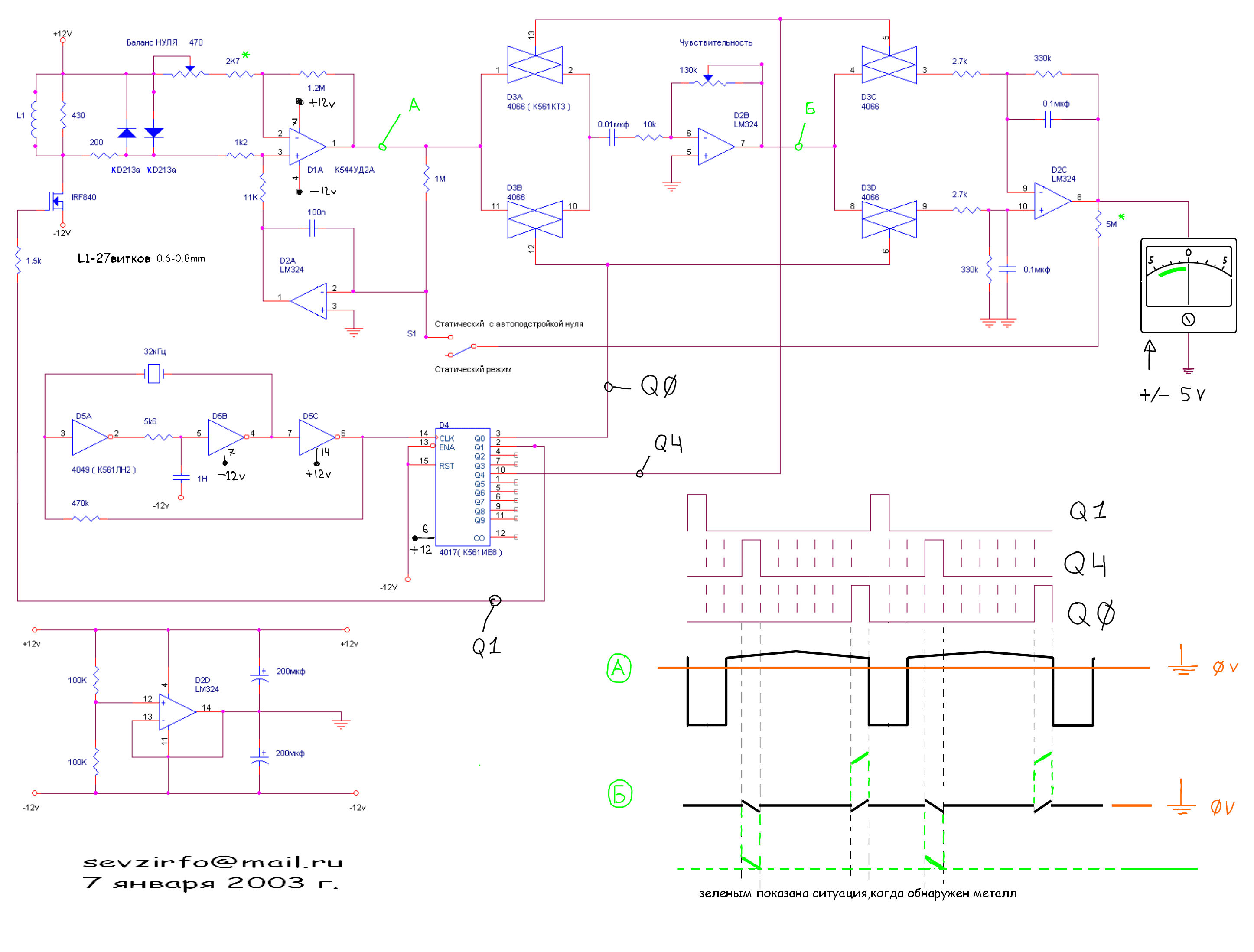

                Hi eugene. It is 95% the same chematic.
                There are a lot of the same schematics with only modyfications at the power suply!!!
                  Also you can make it.....

                      GEO ,You right 2 times !!!!! 1. About the proscan and ...2. The schematic from Sevzirfo is the best one , so far !!!......I will stop searching and take a Break !!!!! ...Bye for now......Eugene

                        You have right but i have not pcb for Surfmaster.
                        I am sure that if the unregister will looking for at the russian sites he will find pcb for the Sevzirfo's PI detector.

                          I have found the tiny, seems much easy one to make me, the electronic members are easy to find. Me study the circuit and I begin the assembly well.
