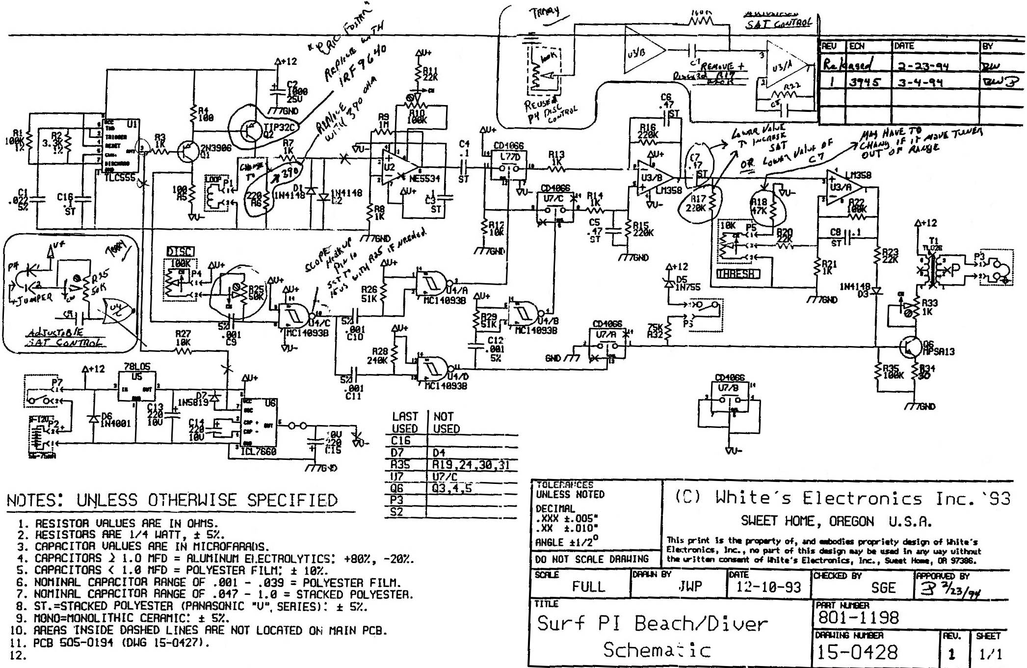

                    after to have studied the several circuits, I have decided to make the surfmaster, indeed much easy, only problem with the TIP32 does not work because much hot and does not find the metals, l' I have replaced with IRF9640 and works enough well, sin that does not go much deep one, 10 european cents 10-12 cm depth in air, with coil from 20cm and 27 turns.
                    exist a way in order to increase the performances?

                      10cents at 10-12cm is no good... is not descent performance for it on 20cm coil...but something like 60's BFO stuff...
                      You can push it well above... say on the 25cm range for 10cents.
                      Reduce the 1st delay and increase the TX on time.

                        unregistered, keep us in course of your project stages. schematic with all updates of gurus you'l find here attached.

                          I have replaced R6 with 390 OHM and IRF9640, the other modifications I cannot make them because I have already developed the board.
