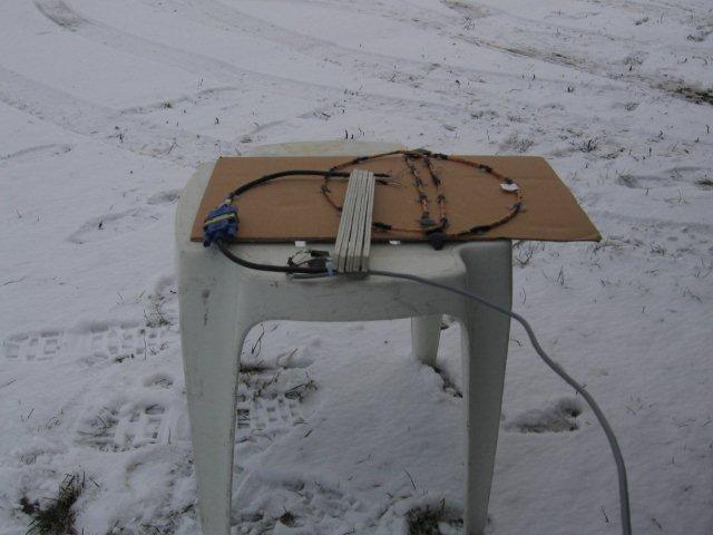

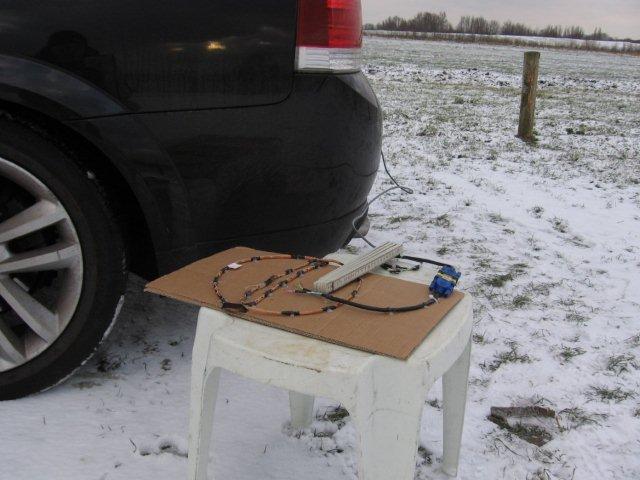

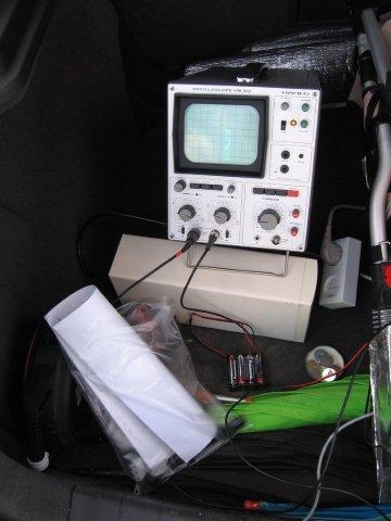

                          • Noise Fieldtest
                            Inspired by someone who went to the mountains for a field test ( I guess at boiling temperatures ) and someone who went to the beach ( same temp ? ), I've decided to make my own fieldtest ( only at freezingpoint , must be out of my mind) due to lower detection depth as should on my TGS : 1 eurocoin > +/- 20 cm , probably caused by noisy workshop and sometimes 'motorboating' due to this noise.
                            The average workshop noise measured on the output of the LM308 is 40 - 60 mV ac
                            So gathered everything from my checklist : coils ( not potted yet but glued with hotmelt ) , borrowed a computer PSU ( 12v DC > 230 v AC ) so I could take my ancient scope in the field , batterypack for clean powersupply and Arctic Equipment etc etc.
                            The only living soul who passed was a shepherd with his herd of sheep and me arriving from the east ( is this a kind of christmass carol ?)
                            With great expectation I've started my test and got really disappointed by the results :
                            the noise in the middle of nowhere was even higher as at the workshop and continues 'motorboating' / falls detection - fals alarm .>> 70 mV ac
                            Even with the other set of coils ( shielded and unshielded ) same results, no matter the nulling ...quite a cold turkey
                            Back home ,after I was melted , reconnected everything for further investigation and guess what ....
                            noise at workshop about 30 mV and stable with a great detection depth : I've got about 29 cm on a 1 eurocoin in air .
                            What he heck is happening? It seems that somewhere internally noise is generated causing all these unwanted side effects.
                            Anyone with a clue ?
                            What should be considered as a normal noise average ?
                            Does the TGS operates below freezing points with windspeeds at 5 Bft ?
                            Can sheep cause side effects ?
                            The leads from the pcb to the commands at the front of my housing are quite long but shielded ( audio cable ) , is that a problem ?
                            regards ,
                            Dennis the Mennis

                              29cm isn't too far off. I was getting just over 30cm until I came up with a mod. Now 36 to 45cm depending on how noisy the environment is.
                              http://www.geotech1.com/forums/showt...=14655&page=10
                              Question: Can you advance your sensitivity to the point where it chatters or does it motorboat?
                              The only times I have seen motorboating is when I get the coil too close to the speaker or I get close to 60Hz power.
                              Divide and conquor! Maybe we can try a different coil. Where do you live?
                              My experiments have grinded to a halt lately. Gone hunting (relics) and have been using mine lately!!
                              Don
                              • Hello Dennis,
                                Long leads can give problems, keep them as short as possible! For screening take care that only one side from the screen is connected to the pcb ground, do not twist wire's that go to the pots.
                                In the past I made a lot different teso's, at high sense they can give some noise but not at a level that it is a problem..
                                Koud hé...
