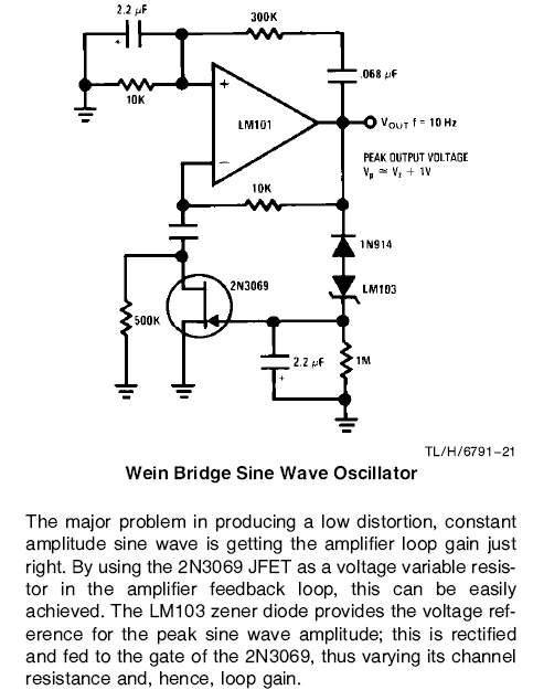

        I think referring to JFet in oscillator... it depends on JFet. JFets have very different cutoff voltage, completely changes behavior in TGS oscillator.
        I made prototype TGSL with JFet in oscillator -- it has perfect sine wave but very low voltage, about 10V p-p. I don't think JFet works as switch there, more like variable resistor. I can change the oscillator voltage gradually by changing the zener diode. I'll bet a JFet with different cutoff voltage would change it also.
        Now, that circuit has very nice waveform... but terrible depth! -- so removing JFet is good idea for depth, get maximum oscillation voltage/current. But everything must be just right I think to keep it under control -- because that oscillator is now crazy beast, bigger than Tesoro expected. So one wrong step and... you get hoisted on the horns.
        My philosophy is maybe a little mod will keep the beast in chains, make it easier to build coils, not need to be so perfect. I have not found the perfect mod, but I think maybe if we use only fraction of the voltage to drive the discrimination and ground balance, then we don't worry about coil and oscillator so much. We still need good null of course, but not worry so much about oscillator.
        The little blip in the sine wave doesn't seem like big deal but there is one case where I think it may cause some trouble. If the blip moves further down the wave (instead of being near top), then you will see some worry at the output of the LF353 pin 1. It makes a "level" section near 0 volts, like a step. This is not good for stability of discriminator -- you want the waveform to cross zero as vertical as possible for stability.
        I found with very low resistance coils (7 ohms in my case), the blip does move down the sine wave and creates this worry. I'm not sure yet how important, but something for crazy people who make wild coils to think about.
        So TGSL is very good if you make coil just right, no doubt. I am also looking for small mod that allows some more extreme coils to be used also. Maybe will be successful... or not.

                  I use only J107 so far -- and looking at spec sheet, cutoff voltage can be from -.5 to -4.5 -- big difference for some circuits, especially TGS oscillator. Almost like using different components.

                        (So...than, must be the way coil was made and nulled, directly determines importancy of this stabilisation stage)

                          Yes, I think so -- if coil just right, OK without JFet.
                          If coil not perfect.... mod that will help???? I'm looking ...

                            Right now i am reconsidering option to put back on pcb that fet and the rest of components... Simonbaker, if i do so, than it would be your "guilt"!
