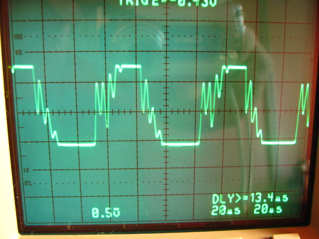

          First: I am surprised that you still get double frequency at G of TR4 with JFet installed. Maybe it is not regulating correctly? Is it still installed?
          Here are some questions I'm interested in:
          1) What is the peak-to-peak voltage of your TX signal at 2907 collector with JFet installed?
          2) If you turn the discrimination pot from one end to the other, does the voltage on capacitor C15 (on source of JFet TR4) stay postive always? Same test with ground balance and C12?
          2.1) What are dimensions of coils? (probably not that important).
          2.2) Is your sensitivity pot turned for max sensitivity? Are there any chatters?
          2.3) Does your ground balance control affect the depth?
          2.4) How did you shield your coil?

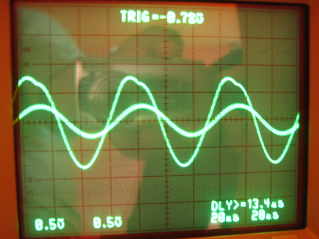

          If you have patience, it is time to get the oscilloscope involved, see photos.
          3) Need to see TX signal.
          4) Then signal at LF353 pin 1; is it clean signal, or clipped, or raggedy? Does it cross the zero line cleanly, or with bumps?
          5) Then check square wave at gate of TR4 (in discrimination mode).
          A) Is the square wave symmetric, or is one half longer than the other?
          B) Is there an extra pulse in it (probably is, which makes double frequency)?
          Those are some basic questions.

              Yes,TX JFet is still installed.Ugly but I just solder missing parts.
              Around 15V peak to peak
              27DD used last former PDF posted in TGS thread
              Sens at max all the time.No chatters.
              little.
              Like Ivconic show on the pictures in TGS thread.With Al tape.
              Ok you have it
              Looks rely ugly.But why?
              Ok
              Lower are longer then picks!
              Nope just lower parts are little longer.
              Will post this too.
              Hope we find it))
              Left is LF353 PIN1/Right is TX vs RX when adjusting

                    Thanks for the excellent data!
                    1) From looking at your TX waveform, I can see the JFet is not regulating the oscillator much... are you sure you have the correct JFet and diodes installed in the right direction? I can tell because your TX waveform still has the "bump" in it.
                    However, I think it has reduced your TX voltage, is that correct? If so, you may just need to increase the zener diode voltage some more -- I sometimes just add regular diodes to get the voltage I want. LEDs can be added also, they're more fun. Just make sure to orient them same as the 1N4148 (I think).
                    By the way, the "nulling" signals you show in the photo look like they would make negative voltage at C15 (bad). Normally you null on the "other side", more like 180 deg apart. Just make sure voltage on C15 and C12 are positive.
                    4) Ugly signal is very typical -- I see it too on mine. I'm quite sure it is because the TX signal (without JFet) is larger than on original TGS and exceeds the input limits of the LF353. The jagged part is because the LF353 with feedback has a resonance at very high frequency (this appears in LTSpice sim also) and any sudden change (like exceeding input limits) causes small oscillations.
                    The JFet, if operating correctly, should be able to make this signal cleaner, by lowering the TX signal. However, it will cost you some depth that way.

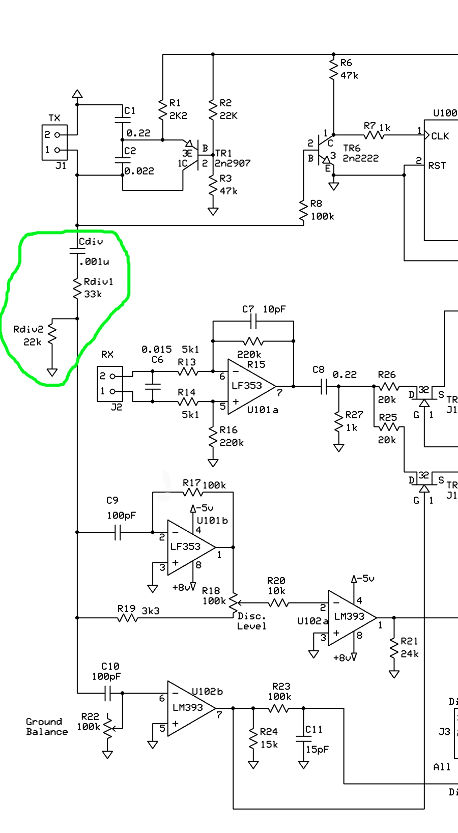

                    I am trying to solve the problem by using a voltage divider to take a smaller fraction of the TX voltage, without using the JFet. But if not done right, it can add a little phase shift and I want to avoid that. A small capacitor in parallel with the feedback resistor also can get rid of jagged part, but that also makes a phase shift, so not recommended by itself.
                    This ugly signal definitely messes up the discrimination signal at TR4 gate when the disc pot is on that side.
                    I think we can fix the bad disc signal, but will it help depth??? Maybe not much, but still important to get fixed.
                    It may help a little, because if square wave at TR4 gate is not symmetic (equal length up and down), your detection is losing a little gain. But probably not much. For example, when you turn disc knob to reject certain metals, you lose some gain but for some reason not too noticeable, although the math says it should be.
                    Will post this too.
                    Put scope on gate of TR4 and move disc pot back and forth slowly. Does the square break up sometimes?
                      Now I saw this.
                      When I put scope on G TR4 again.There is extra pulse.And shape is strange.
                      When I turn disc signal brake sometimes.
                      I am shore that added Jfet and the rest of missing parts.
                      I respected original schematic.Disconect 47K R and add other parts.I am using 4V3 now.Not much change.Bumb in TX signal is because TRs are not perfect devices.And its normal.

                        Ok. Wanted to doublecheck.
                        I agree, bump is usually not a problem itself, but indicates the JFet is still not reducing the voltage much. I have one TGSL circuit with the JFet and extra diode and there is no bump -- but very low TX voltage (10 v p-p) and hardly any depth.
                        So I think problem with disc is TX voltage so high. I am trying to find best solution but not sure yet.

                            Attached is the circuit mod I use to make clean(er) discrim signal at LF353 pin 1 when no JFet in oscillator.
                            It is simply voltage divider with an additional capacitor that compensates for small phase shift. This stops overloading inputs and gets rid of small oscillations. There is still big "notch" due to bump shape in TX signal, but not a problem I think.
                            Resistors chosen for compromise. If make larger, introduce more phase shift. If make smaller, they suck voltage from oscillator.
                            This does not help depth for me -- just clean up discriminator.
