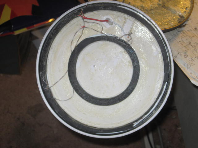

          Coil: Round concentric co-planer ~9.5" (receive coil in the center w/bucking coil). Made from 28awg 7 strand Teflon. TX = 350uH @28T / RX = 432uH @~50T Bucking coil at ~8T or so, tuning resistors for Rd - TX/RX are in the coil housing. The coil is shielded on the bottom only atm.

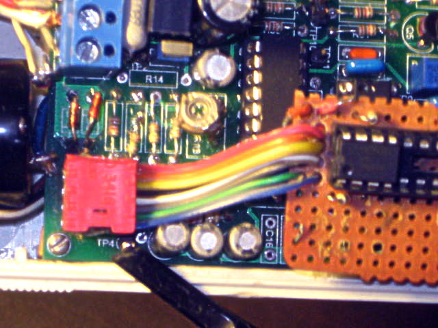

          Pre-amp (IC6 NE5534): Replaced with the National LME49710 - Main specs: GBW= 55MHz Slew= +/- 20V/uSec Noise= 2.5 nV/root(Hz) THD= 0.00003 %
          No gain mods, still the orig 1000 gain.
          Integrator/post-amp (IC8a/b TL072): Replaced with the National LM4562 - Main specs: GBW= 55MHz Slew= +/- 20V/uSec Noise= 2.7 nV/root(Hz) THD= 0.00003 %
          Have tried a 122k for R29, seemed to adversely affect auto tracking, though sensitivity seemed better (subjectively).

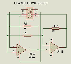

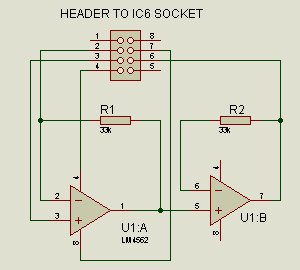

          This chip set drops in seamlessly and I would like to take advantage of their specs by playing with the gains in the different stages.
          So...let's start with your first suggestion:
          "If you add a FET to eliminate the flyback on the preamp, you can increase the gain on the preamp considerably"
          I don't understand how to do that. I thought that the dual coils did most of eliminating the flyback problem. If there's a way to tweak it a bit more with the FET idea, I'll give it a shot. But as I said, I'm not sure what you mean. I'm still working on understanding the simple gain resistors atm. For example, is the gain of the pre-amp dependent on both R13 and R16? Or just R13?
          So what say we start here and then see about the integrator/post amp? If you think I can get away with it, I'll push the front end gain. What say the specs above?

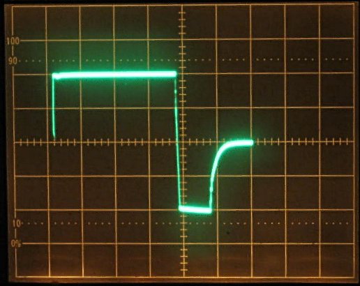

            Could you post a picture of the output of the preamp?

                  I see no bucking coil. With a well balanced IB coil, things look quite different than a mono coil. Please post a scope screen shot of the TP 4 output.
                  For a simple explanation about IC 6:
                  IC 6 is in the inverting mode. If you decrease R13, you decrease the gain.
                  If you decrease R12, you increase the gain, but you also change the damping at the same time.
                  Or opposite when increasing.
                  Increasing the gain of IC 6 also increases the saturation of the Opamp. This increases the delay to the first sample.
                  When the Opamp is in saturation the gain of 1000 from 1M\1k, is not really that gain anymore.
                  Another important factor is the sampling point.
                  With a gain of 100 in the next stage, the difference between sample 1 and sample 2 will be amplified by 100. Therefore if you sample too early, when the decay curve is not close enough to 0V, the detector becomes unstable when the second stage saturates.
                  R 16 is a level adjust. The 5534 has provision for adjusting, however, Carl added this universal adjustment for the event when somebody changes the Opamp to a type that does not have its own adjust pins.

                      GBW is usually spec'd at unity gain. As you ingrease gain the effective BW decreases (as near as I can tell, it is proportional and inverse to gain). To not extend the decay time for fast tagets (or even switching transients from blocking MOSFETs being stretched to make them apperar as targets), my experience has shown that a band pass of at least 1.5MHz provides the best results. My best results to date have been with a AD797 w/gain x20 (protected by blocking MOSFETs), followed by AD600 VGA with -6 to +73 dB dynamic range (max usable for good S/N is currently 47 dB). The no-target signal has returned to 0 baseline within 5 usec (I am currently sampling at 6 usec). The gain of the AD797 could be increased to ~x74 and still provide the 1.5MHz bandpass. With better coil design, I can improve on that.
                      Also: a reasonably fast coil, with shielding and cable, might have a self resonant frequency of 500kHz. I look at this as an LC tank circuit that resonates at this frequency.
                      My two best coils (a DD and a Fig 8: TX ~290-300uh) resonate at about 850kHz (w/shielding & coax). The Rx of both coils have a higher inductance (~420uh) and slightly extend the decay time of the flyback to >1.5usec. I plan on making a new DD with both TX and Rx <= 300uh to improve that.
                      To answer your question: In my opinion, as high as possible. I do everything in my power to minimize capacitance in the transmit circuit. And I watch capacitance in Rx also.
                      How can we design the preamp to make best use of this resonant frequency?
                      (1) use higher bandwidth, low noise ICs (as BW increases, I have noticed that current drain seems to somewhat follow).
                      (2) use dual pre-amps stages with gain reduced in each stage so as not to limit BW to < 1.5MHz.

                        So here's what the coil looks like:
                        Now to mix Tinkerer's thoughts with those of J.L.King:
                        I have kludged together the following with an LM4562 and a dip header and I think both gains are now at 33, correct?:
                        From the following 'schematic' (R13;HHvD1 disabled):
Name:	dual front end test2.JPG
                        (Back to Tinkerer's question) the result is the following wave form at TP4 - volts/div=.2, time/div=5uSec (HHvD1):
                        So now my question for both of you...how can I improve this? Am I on the right track?
                        The wave form is cleaner (noise wise) and seems to be the same as before (except for that slight dip just before the climb back to zero, though MUCH quieter). Anyone else have any thoughts on this?
                        Thanks folks, GTB
                          Actually, no. The gain of the first stage is correct and is 33. To set the gain of the second stage configured as a non-inverting, you must also supply a gain resistor between pin 2 and ground. I would use a 1K between pin 2 of the second stage and ground. That will give you a gain of ~34 for that stage. I think ground is pin 3 of the header in your schematic.
                          J. L. King
                            Thanks J.L.!
                            Thanks for the help J.L.,
                            I'm a bit confused as to "I would use a 1K between pin 2 of the second stage and ground. on the second stage".
                            I'm assuming that you mean between Pin 6/IC1-b and ground. Since pin 6 on the amp is the inverting input of the second stage and Header Pin 3 is VB.
                            Of course everytime that I assume something.....
                            Thanks, GTB
                              is this what you mean?
                              Hey there, J.L. King,
                              Is this what you meant? It's what I'm trying now and the gain is definitely better.
                              Would a cap across the 2nd stage gain resistors R2 or R3 help?
                              Thanks again, GTB
