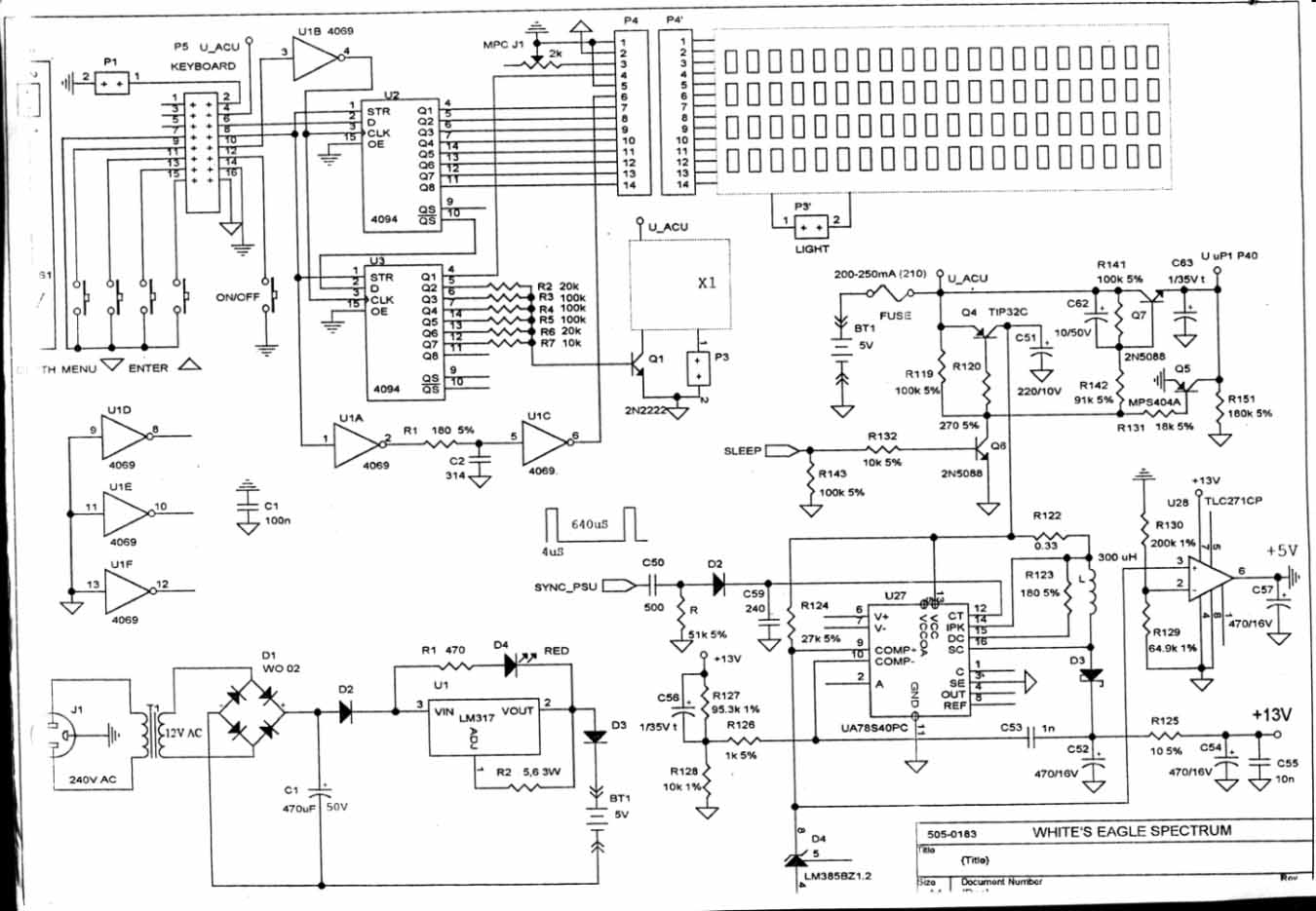

    Geo or Carl , What is the correct operating , dc supply voltage of the whites Eagle , 4.5 or 6 volts dc ???? The rechargeable pack says 4.8 d.c. volts , and the other pack I have uses 4 "c" cells = 6 volts ?? I like to be very accurate on this , before I run my machine or buy other nicds........Thanks again..........I normally figure this stuff out , but I have no time to take this machine apart right now, and the spare time I have , I need to Metal Detect outside , and it is not raining right now......thank-you..........Regards...........Eugene

          I think the Eagle has a voltage boost circuit that takes the battery up to a higher voltage... yours might have a problem.

                      I bought rechargeable cells yesterday and the Eagle still does not turn on . But with fresh alkaline @ 6.25 volts total , the machine works beautifull !! I took it apart and found no cold solder joints , the circuit board looks brand new !!! I found one 3 pin regulator IC , a BUZ-71A , I suspect it is the problem . I think correct "D.C. supply voltage" for the Eagle I , must be 4.5 volts but it is 22 years old so it needs over 6 volts to drive it ...........I am in a hurry to fix this machine , so I do not get frost bite outside under the Palm Trees ..................Regards.........Eugene
                        Hi Eugene. Try to see if it is the same schematic as Eagle spectrum.....

                          Wow , Thank-You Geo !!!!! A nice clear partial schematic !!!! Also , you are welcome to send more Eagle schematics to my e-mail address amtech2005@yahoo.com .... GEO , just in case my wireless "internet signal" gets lost , You and your Family have a Great Christmas and a Healthy , Happy , Prosperous New Year "2009"........ I should be back on soon , I hope............Take care.........Regards.........Eugene52 / amtech2005 / stalni-Clan
                            Hi Eugene. Schematic is from Eagle II but it is the same (95%). I checked the pcb of II series with mine (1987 or 1988 model, series I), and it is exactly the same except that there is a small IC more (as 741). Also maybe software has differences but this is not problem. I will send you the files.My wishes to you and to your Family for Mary Christmas and a Healthy and Happy New Year "2009".
