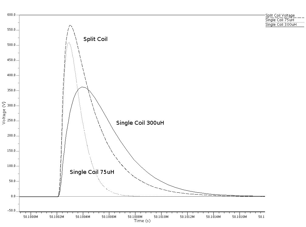

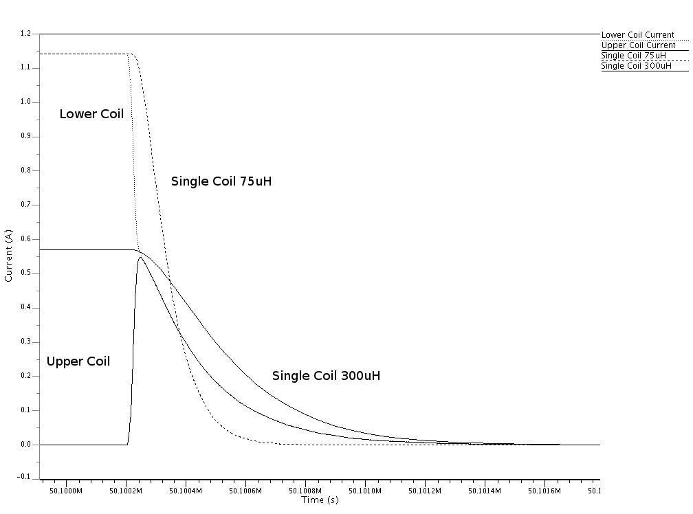

      • The result of some further experiments:
        Since I remain to be convinced on the potential benefits of this split coil approach, I decided to run a simple simulation to compare the decay times for the standard mono coil (300uH), the split coil (which is essentially the mono coil, but with a center-tap), and a single 75uH coil (i.e. one half of the split coil).
        The first plot below shows what happens to the current in the various coils when the switch opens. It is interesting to note that the single 75uH coil has the fastest decay.
        The second plot shows what happens to the voltage across the various coils when the switch opens. Again (as you might expect) the 75uH coil has the fastest decay.
        The conclusion is that there is no advantage whatsoever to using the split coil arrangement over a single coil. The faster decay time is attributable simply to the reduction in coil inductance and coil capacitance. The disadvantage is the increased power consumption required to drive this coil.
