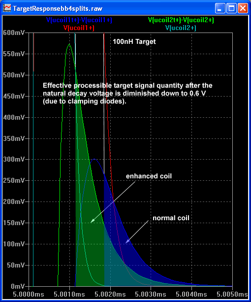

                            thanks for your effort. It's looking very interesting. I think, the ringing of the CT coil could be lowered, when the lower side of the half coil is not reaching the avalanche breakdown voltage of the MOSFET and diode. So the current dissipation on the coil halves could be the same (balanced dissipation).
                            We also need not much amplification of the front-end. This will increase the S/N (noise amplification gets less relevant). The effective target signal quantity is higher, the earlier we sample.
                            The picture below visualizes this. The surface area of the net target signal gives a higher potential for the enhanced coil (MONO coil).
                            Aziz
