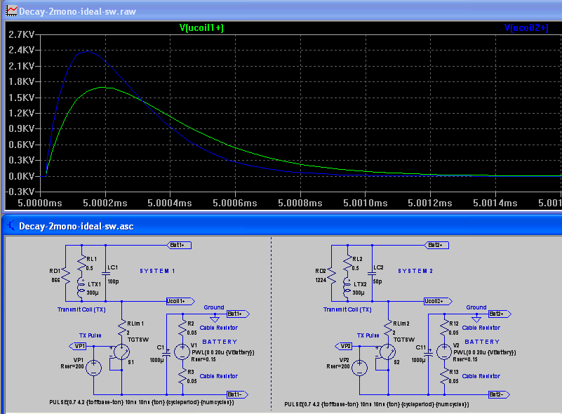

just compare two ideal MONO coil decay curve simulations (without any mutual couplings and ideal inductors):
Same conditions, except the system 2 (right side) has only 50 pF coil capacitance instead of 100 pF (left side).
The principle is lowering the effective coil capacitance to increase the effective damping resistor. This will lead to higher flyback voltage.
It is obvious, that at reduction of parasitic capacity, speed of attenuation increases. It is old, as the world. But at what here "New PI technology" ?
The result is obvious: taking benefits of higher flyback voltages without clipping them. Then a higher magnetic field energy can be dissipated into heat. So the difficulty is the breakdown voltage of the MOSFET:
either increasing this by selecting a higher voltage fet and diode or decoupling the higher flyback voltage from these parts.

All that you are doing is counter to this claim. You don't want to put the flyback energy back into the coil, this will slow down the coil. The ideal arrangement would be to have the damping resistor isolated for the majority of the flyback and then connected at a predetermined time prior to the flyback voltage going to zero to damp the coil. By doing this you generate high flyback voltage potentals but no current through the coil. This will give a very fast collapsing magnetic field to excite the target and earlier sampling.
you forget, we have two energy conserving elements: coils inductance (resulting in magnetic field energy) and coils total capacitance (+parasitic, resulting in charge voltage).
A current must flow through these energy storing elements. There is no need for switching the Rd and it minimizes additional noises. Switching on a high voltage isn't so trivial.
Important is: the stored energy should be converted in resistive elements to heat: damping resistor, coils resistor, ..
It is more efficient, if you can achieve a higher current through these resistive elements during the flyback period (P=I*I*R). As the damping resistor can not be changed arbitrary (for critical damping), one approach is to increase the voltage on these resistive elements (P = U*U/R). The latter one is more efficient. All the idea is based on increasing the flyback voltage.
