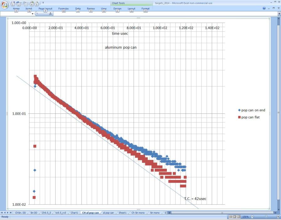

I remember that aluminum coca can bottoms made from thin aluminum but creating unbelievably strong signal because of big diameter.

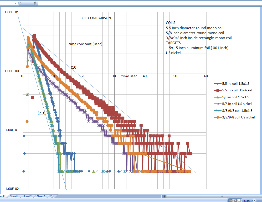

I've been using some small coils trying to plot the time constant of a hypodermic needle. Wasn't sure if the coil has an effect on time constant. Plotted some data comparing three different coils with two different targets. The nickel plotted 10 usec the same as I've gotten in the past with other coils. The aluminum foil plotted 2.3 usec. The coil slopes are the same for each target. I didn't get the amplitudes the same except for the 5/8 round and the small rectangle with aluminum foil, they plot the same.
Interesting.. . I read somewhere that target orientation to the coil has an effect on t/c.
Dan
Thought I would try with the targets rotated 90 degrees, edge not flat. The 3/8 x 9/8 rectangle coil was still hooked up. Rotated the 1.5 x 1.5 inch aluminum foil inline with the 9/8 side. Watching amplifier out there was no visible target signal with the foil centered. The signal time constant changed as I moved it to either side, getting longer as I moved it away from center. The nickel was similar except I couldn't get a zero target signal with it centered. Didn't try the other coils. If target position makes a difference I think it would be hard to compare time constants with different coils with the targets not flat to the coils.
