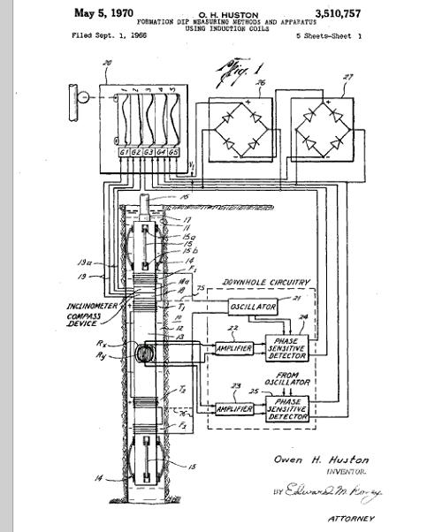

        Some patents on Google patents search can help you for go ahead on your project. These patents can give you more ideas. For example:
        4,019,126. In some part I have this patent that uses on oscillator Nuvistor tube.
        http://www.google.com/patents?id=ET41AAAAEBAJ&dq=4019126
        2,167,630
        http://www.google.com/patents?id=0Q5QAAAAEBAJ&dq=4019126
        3,068,400
        http://www.google.com/patents?id=zkFqAAAAEBAJ&dq=4019126
        3,187,252
        http://www.google.com/patents?id=m15TAAAAEBAJ&dq=4019126
        3,388,323
        http://www.google.com/patents?id=2DdqAAAAEBAJ&dq=4019126
        3,510,757
        http://www.google.com/patents?id=rIdzAAAAEBAJ&dq=4019126
        3,609,521
        http://www.google.com/patents?id=nH51AAAAEBAJ&dq=4019126
        These patents has reference to other number patents, so you can found many infos in Google patents.

              Esteban,
              Thanks for the info.
              However, all these patents are related to bore-hole applications and I only have archaeological survey application in mind for my project.
              Willy
