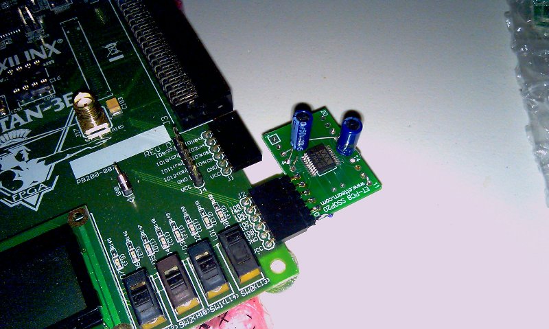

IBGold is working on a coil to use with the TMPI / FPGA .... thanks Ian. I have started looking more closely at the Tinkerer and/or Aziz descrimination method and one thing becomes very clear ... the current system has a 14 bit ADC however in order to get sufficient sensitivity the gain is set to 100. This is good for sensitivity but is bad for dynamic range. At a gain of 100 the dynamic range is reduced to about 12 millivolts with a sensitivity of a few microvolts however this is not really able to handle the sampling requirements when you want to resolve microvolt levels on a several hundred millivolt waveform.
So the ADC input for the DSP system now moves to 24 BITS
The internal bit length of the DSP code in the FPGA is 32 bit so this fits in with no code changes.
This enables the system to handle an input of 2 volts but still resolve down to uVolt levels. The base sample rate is approx 6 MSPS. Because the resolution of the ADC is now 1000 times higher than the 14 bit ADC ... the gain can now be minimised or dispensed with. The 24 bit ADC has dual differential inputs so no changes are required to work with the differential front end.
Below is a pic of the board ( 1 inch square ) and fitted to the FPGA board.
There arent many pins because the data is clocked out serially by a 40 Mhz clock. There are separate supplies and grounds for the analog inputs on the 24 bit chip ... not connected in the pic yet.

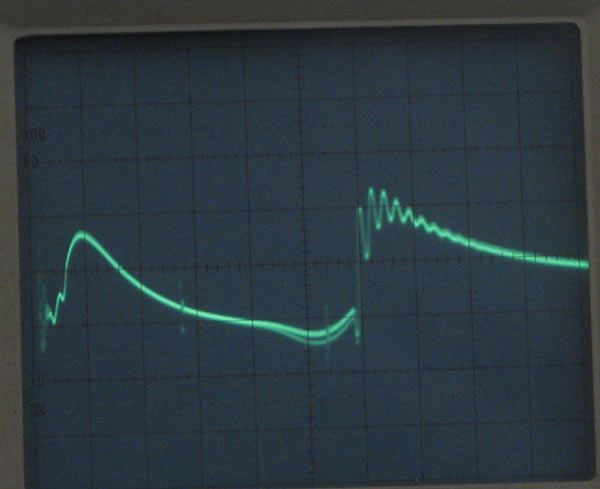

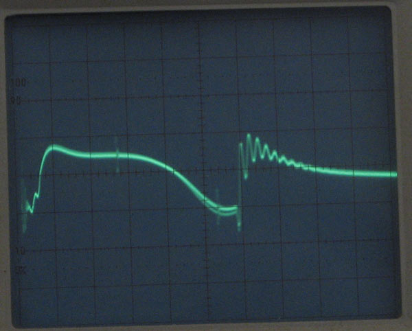

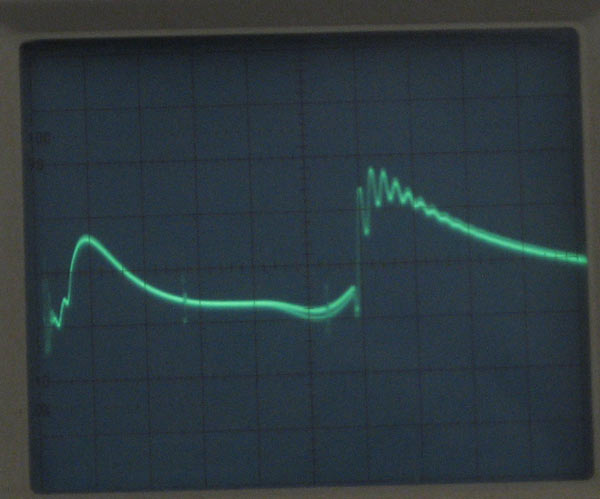

I have been improving on the S/N a bit. More signal amplitude to start with.
Attached are 3 scope pictures of the RE_PI Coil # 5 output NO AMPLIFICATION.
Settings: Vertical 200mV, Horizontal 5uS
Pictures:
No Target
4"x4" alu foil
4"x5" 1/16th steel plate.
Targets 60mm above the coil.
The coil is sitting on slightly magnetic red fire bricks, 35cm above the concrete floor that contains re-bar mesh. This serves as simulation of iron mineralized ground.
These targets can be considered near maximum range.

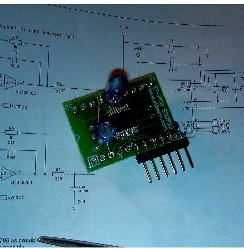

Good work Tinker ... the 24 bit ADC is up and running ... only took 10 lines of code .. could not believe it ... The 14 bit chip was more like 100.
So I now have two fully differential 24 bit channels at my disposal. The chip was only $8.
The protoboard, caps and pins added another $2 ... so a fairly cheap investment at $10 for 24bit goodness.
The input voltage limit is 2.8 volts +/- ( tho I will limit to +/- 1 volt ) and the real sampling window is 5 uS though the internal rate is several Mhz. So your screen shots are at the optimal levels for input to this ADC.

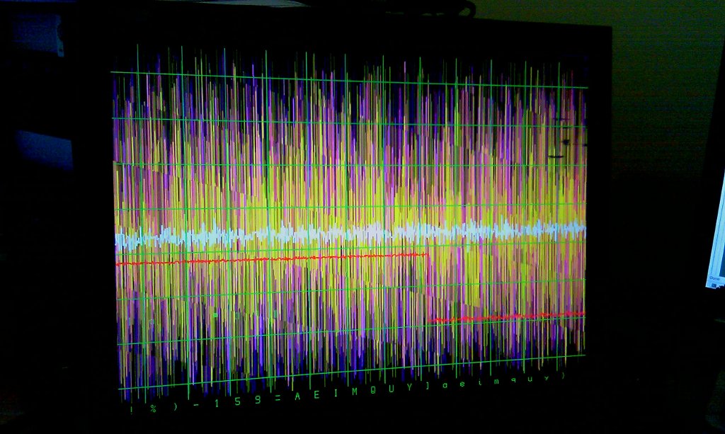

The pic below shows the 4 channels purple, yellow, white and red running on the VGA display output from the FPGA engine. I have not put a real signal yet as I tried this with the first chip and spiked it .... some flyback from the coil must have leaked ...
I am sure a liberal sprinkle of diodes will fix this.
The display shown is at maximum resolution 64 uV per division. Equivalent to a few hundred uV peak to peak. The Channel 1 an 2 input are open so we are just looking at noise and EMI hitting the ADC inputs. Did not need to touch the DSP code.

The input is rated at 2 volts RMS ... 2.8 volts pp. Filtering is what the DSP does naturally ... amplification should not be needed that is why we are using 24 bits .... uVolt sensitivity with filtering by DSP. so if the signal is 1.000000 volts and it moves to 1.000001 volts ... should be able to detect it.( more complex than this but you get the drift )
I clock them at a 200x oversample for an effective external sample at 200 Khz = 5 us
I was reviewing the datasheet for the WM8786, and it looks like it can only be configured for a maximum sample rate of 192kHz. In master mode, the oversampling ratio can be set to 128fs or 256fs. If you don't mind, can you please explain in more detail how you have the WM8786 configured?
Thanks.
Hi Hobbes .... a long time ago I read an article how you could overclock microprocessors by tuning up the voltages and the input clock ( we are talking Z80s here so more than 20 years ago ) I have overclocked every computer I have ever had since then ....
To cut a long story short I dont particularly pay too much attention to data sheets ... you can clock the chip at whatever will work.. This chips specs the maximum master clock at 40 Mhz however to adhere to digital audio standards you must use the specific clocks ... but hey ... I am not doing audio here so I use whatever does it for me. This particular chip will clock all the way up to nearly 50 megs but starts to miss a few conversions ... this is equivalent to approx 380 Ksps
I was clocking at a higher frequency because I had not bothered to code the FPGA clock for the required clock ... so I just used the nearest.
However I am now using the correct clock ... as I realised there is no need for overclocking.
The input clock is set now to 24.576 Mhz for oversample of 128fs where fs is the desired sample rate of 192 Khz.
So 128 x 192000 = 24576000 ... ie 24.576 Mhz
However 192 Khz is plenty fast for this application this equates to a time BETWEEN samples of 5.208 us .... The sample and hold window is much faster than this ... so we only need to slide the phase of the ADC clock to sample at precise points on the RX waveform. The sample window is well under 1 us ... it is the conversion time that takes up the rest of the time till the next window.
This means we can use these cheap chips in place of much more expensive and faster ADCs because we are controlling the point at which a sample is initiated by controlling the phase of the clocks ...

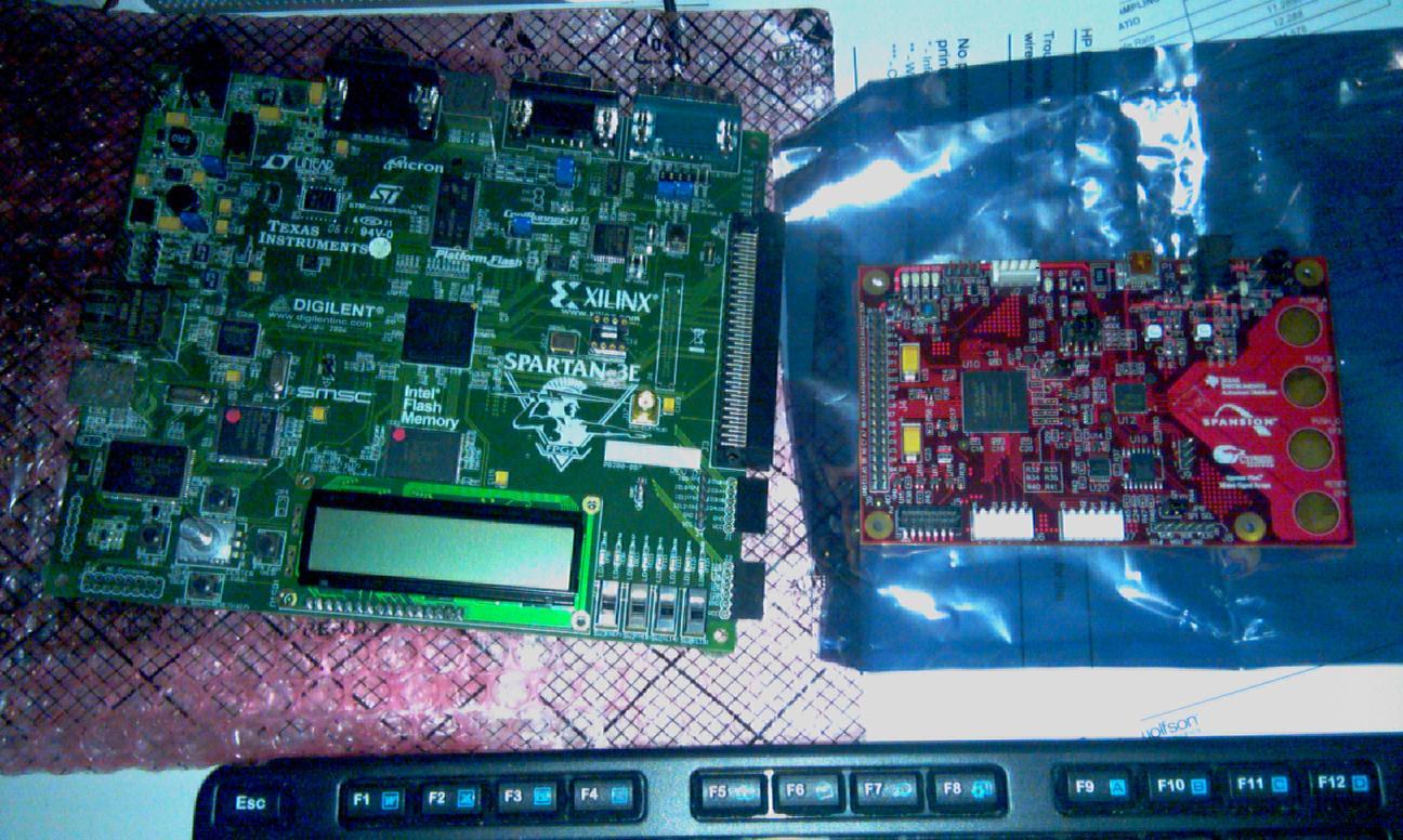

the FPGA project has split across two boards now ...
The new board is much smaller .. sucks less power ... but will still have the same horsepower in the DSP department ..
The larger green board is the current development system. The smaller red board is the new development system split. This board is $US 50 which is a 1/3 of the cost of the larger board. It will still have the VGA waveform output capability.
Shortly I will post a block diagram of the system as I know some of you are having trouble following what we are talking about.
The min power is very hard to peg ... for instance the big board draws about 220 ma at 5v which is just over 1 watt. The smaller board draws half that. However you have to consider that the power consumed by an FPGA is related to the complexity and how fast the clocks are. Similiar to a CPU the more you work it the more power it consumes. You can however design to turn off clocks in unused parts etc. Because this design is a PI I would expect energising the coil to consume the bulk of the power.
