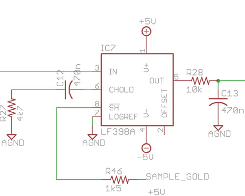

                                Aziz,
                                I have been using the circuit below (found on the datasheet) for the S&H of the TINKERERS IB-PI. I wonder how it compares with an ordinary Integrator.
                                Would you be so kind and give your opinion?
                                Tinkerer
