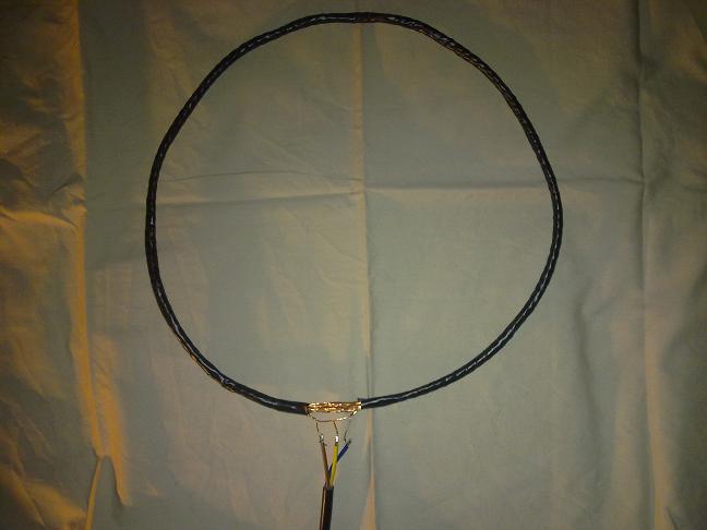

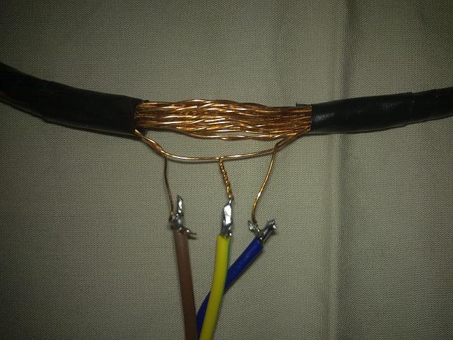

      Differential coil pics ...
      You can see the twisted pair in the coil binding.
      Centre connection is NOT a centre tap.

          Regarding the "bifilar coil", I'm wondering if there is a subtle issue.
          First, for me, center-tap is very appropriate description because with flat coils especially, the physical layout of the wires is normally not a big deal with regard to the basic coil parameters. So if it's scramble-wound, bi-filar wound, or incremental wound, the topology is very similar -- by sorting through the windings you could convert one coil type to the other without rewinding.
          Having said that, I'm wondering if there is an important subtle difference, specificially capacitance. With bifilar wound coils (connected like yours), I think the voltage between adjacent windings is about half the voltage across the coil. With incremental wound coils, each adjacent winding is at a much closer voltage, hardly any difference at all. Would that not effectively make the bifilar wound coil have more capacitance than the incrementally wound?
          Or does somehow it all work out the same?...
          -SB

            Hi Simon ... you have a point ... I have an RF background and in that space coil geometry is very critical. A center tapped coil and a bifilar coil are different beasts. Your point about the capacitance and connection options are also valid .... The sort of frequencies we are working with here would certainly be seen in an RF engineering environment. ( though we would probably be trying to suppress these type of pulses not amplify them )
            The same configuration could physically be produced with two separate single wound coils ... I have not tried it. The twisted pair would be more transmission like in nature due to closer coupling and distributed capacitance.
            moodz.

              mmm ... I did a spice model and get the same result but no modelling of transmission lines etc ... just the mag coupling ... so maybe two coils connected the same way would work also... dunno have to try it.
              moodz
