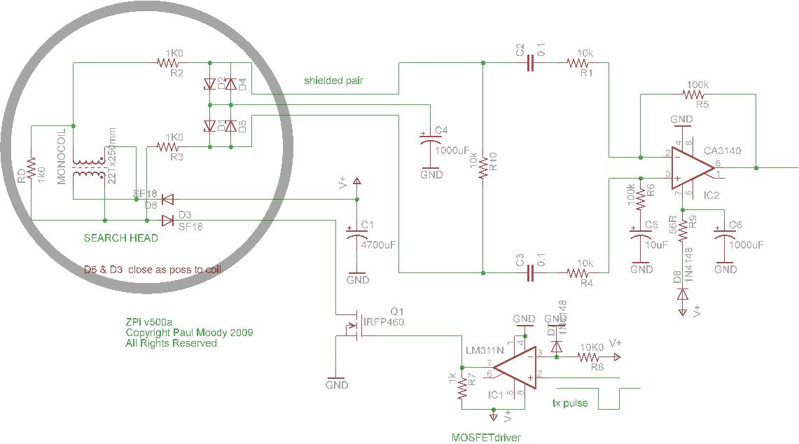

          version 5
          More changes ...
          0. Renamed from moodzPI to ZPi because the idea really started with Aziz so the Z is common letter to our names.
          1. MOSFET driver turns on soft but shuts off harder. However now must invert tx pulse ... oh well .. changed one line in dspic code.
          2. Got a separate drive cable and balanced receive cable from search head ... I think you can figure out what the big circle is The TX circuit and the RX circuit can now live in separate places on the PCB .... no naaasty volts and amps near the rx actives.
          3. The two diodes D3 & D6 'float' the coil away from the cable / mosfet capacitance during the decay .... take one or both out and see what happens to your decay time ... and your noise.
          4. Obviously dont put the coil head components on a PCB .. well not a PCB with big areas of copper. Suggest you air wire then pot in epoxy. Keep all leads short as poss. Place outside edge of loop.
          This circuit provides excellent noise and hum resistance whilst providing good sensitivity and improved decay.
          here it is ....

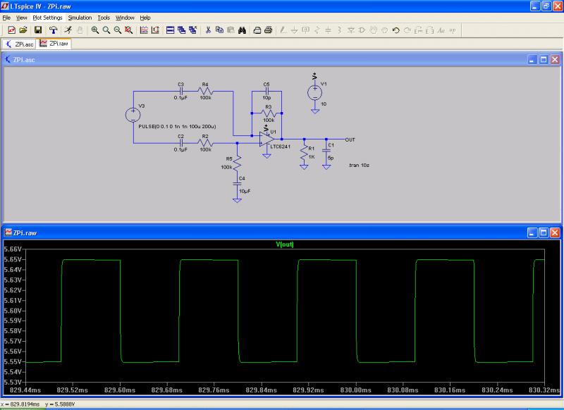

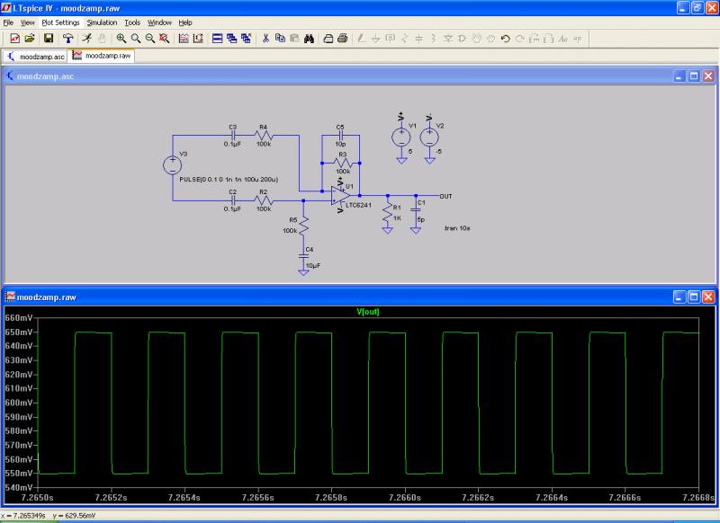

                Well ... I did a quick sim on LTspice ... and it works OK. The amp self biases to mid supply range ... in this case near 0 volts because of + / - 5 volt supply ... and it handles AC no problemo. ( There is a small DC offset in the ouput however if I feed the next stage through a cap this will be removed.) In this case a 100 mv pulse at 100 uS ... unity gain. The caps are all ideal ... no leakage simulated. Only the amp is not ideal.
                I am pretty sure this type of amplifier is used in biomedical applications where there must be no DC path to the patient ... I just cant seem to google an example of it apart from some stuff I have built.
                note this is just an amp I picked from the LT lineup ... nothing special ... GBW = 18 Mhz.
                Any comments ?

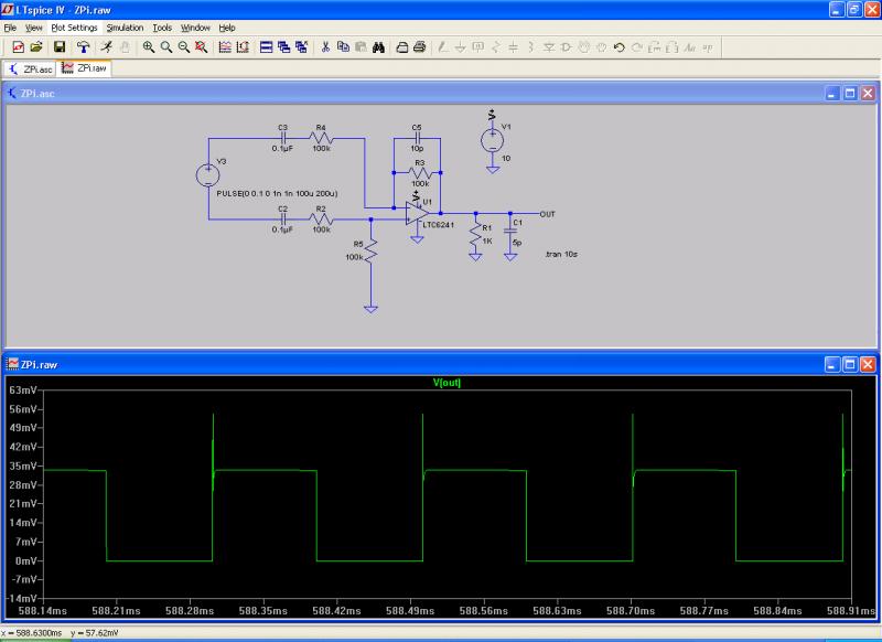

                  ... and with the cap removed the amp no longer self biases but clamps the output to average ground ... which would not be good in a single supply amp as half the waveform would be below ground so to speak ... thats why I have the cap.
                  moodz

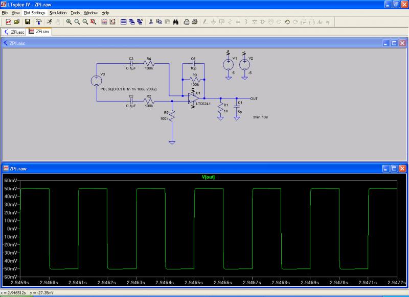

                    now with single supply and NO cap .... doh lost half the signal on the o/p
                    moodz

                    • ... and now with single supply 10 volts ... and cap .... and the o/p self biases to approx V supply ( ie 5 volts ) and the pulse train looks OK.
                      ... any comments welcome.
                      moodz.
                        moodz.
                        That should read ... and the o/p self biases to approx HALF V supply ( ie 5 volts ) ...

                        • v5 ommission
                          ...eek .. should be a 1k resistor from top of Q1 to ground. Play with the value a bit ... depends on your MOSFET capacitance ... will improve the decay some.
                          Will publish in next schem update.
                          moodz.

                            D1, 2, 4, and 5 are 1n4148 ... not schottky as illustrated.
                            moodz

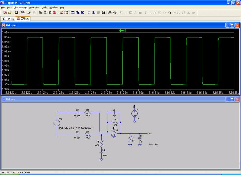

                            • amp with ideal op amp
                              .. amp simulation with single supply, cap on bias leg and IDEAL opamp. Notice that the bias point is EXACTLY vsupply/2.
                              Supply = 10 volts.
                              Bias point = 5 volts.
                              Pulse input = 100uS duty cycle
                              Period = 200uS
                              Pulse amplitude =100 mv pp
                              I am happy enough that this self biasing is a valid design technique for AC amplifiers.
                              real opamps will exhibit a slight DC offset but if everything is AC coupled ... no problem.
                              Any comments welcome.
                              moodz
