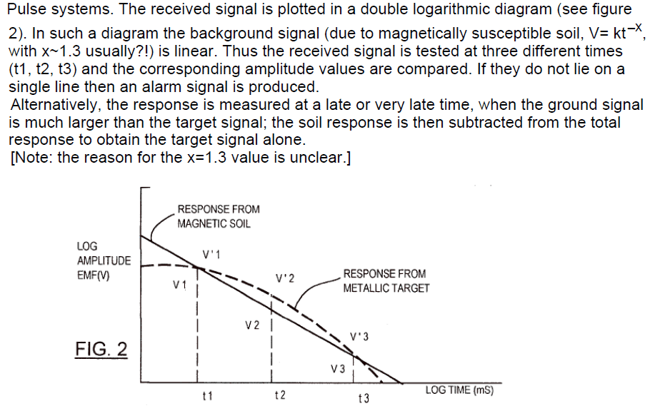

            Maybe any recieve signal that is Linear can be cancelled out automatically pressumed as ground noise, the response from magnetic soil would seem to be Linear where the response from targets are not.
            I have an old graph somewhere i will find it & post it, may spark some ideas?
              Heres that Graph.

                Thank you for that fantastic graph. Simple, understandable. If it's accurate then it means there may even be hope for a poor technician like myself to devise a system of ground cancelling that doesn't seriously affect sensitivity. (Yeah I like to dream.)
                Do you remember where it came from?

                  US Patent 6583625 - Metal detector and method in which mineralization effects are eliminated

                    jeeeez, thanks for that! Some really useful stuff there and I like the fact that the GB method can be utilized without sensitivity loss. The Fe ID sounds good too, a bit better than ours! Oh Dear....MORE R & D !!!!
