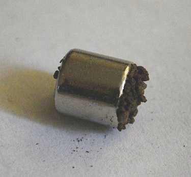

    The Tests are to show the strength of the magnetic field at the target & where & what creates the strongest magnetic field in realworld conditions.
    The tests are done in highly Magnetic Soil as you will see from the Magnet picture & this is the soil used.
    These are UNDERGROUND tests & the target is only a piece of 3/8" Ferrite Rod about 3/4" long with 10 turns of small insulated circuit hookup wire Wound on one end with the ends of the wire about 18" long out of the test cell.
    For ease of showing the signal strength at the target it is buried only about 3" under the soil, this is bad soil though. The metal detector coil is about 2" above the soil.

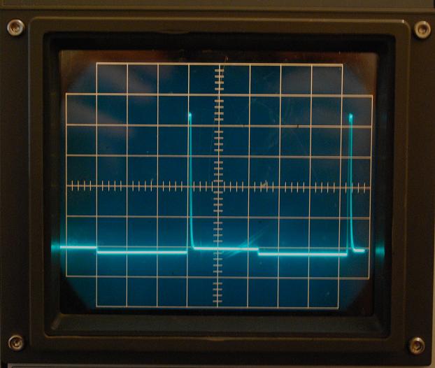

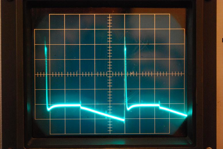

    The O-scope settings are the same for both shots, Probe Attenuation X1, the probe is connected to the ferrite cored coil wires.
    As you will see it is the Flyback that creates the strongest magnetic field & is the reason i have been on about it. This also verifies Aziz's LTspice Sim & what he mentioned about this also.

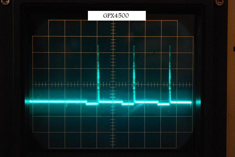

    The 4500 is using higher voltage than what i have on this little circuit & hence the target signal is a little under the 4500 but not much & especially considering this basic circuit cost me about $20 & took me 1hr to slap it together & it can take a lot more power which i will do later, it's not to bad.

    The first O-Scope picture is the basic circuit coil voltage for the test.

        On your picture of the setup, the Flyback is a clean spike. On the pictures in the soil, the spikes do not look the same. Could you post pictures of the Flyback with the scope set at 1 or 2 uS/div. ?

            Yes, that's what i had in mind, i will add some more shots today of what you mention & more, all this is just a preliminary warm up.
            I will not add shots of the GPX4500 current etc though as this is rightfully Mr Candy's business as we can all respect & is the reason i just knocked up a quick basic circuit with similar signals for these tests.
            I just added the 4500 signal picture to show we are looking at something very similar for the testing which is a good benchmark seeing they are the best there is.

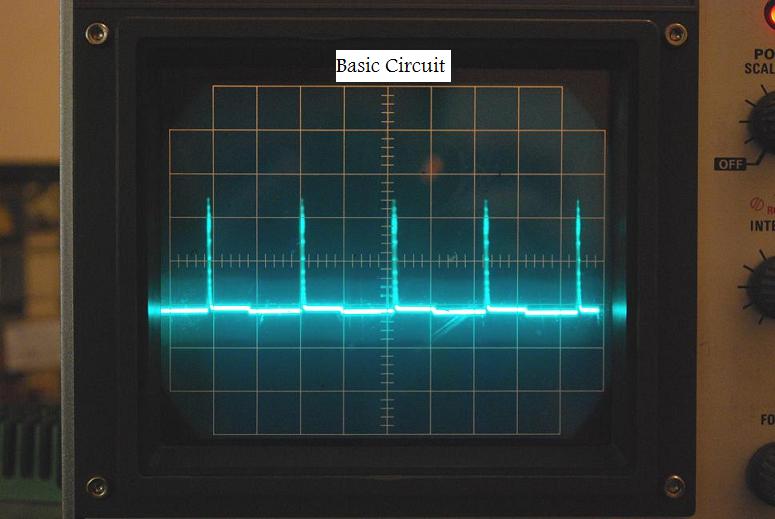

                    I have taken a shot of the output directly from one of my hall detectors which is now buried, the pulse is from the basic test circuit above.
                    It clearly shows the magnetic field, it tells a great story also---well to me it does, hahaha!
                    See what you think.
                      Well ... that is interesting ... there seems to be a sudden sharp flux reversal at flyback. Is this your circuit or 4500?

                        The picture is from the basic circuit i put together for the testing purposes.
                        No other pictures of the 4500 will be added as mentioned previously, just that first 4500 comparison picture at the start of the thread.
                        The 4500 does however show the same magnetic field characteristics as will anything with a good Transient spike.
