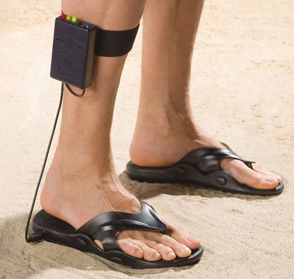

    Or you could simply buy these ->
    http://www.geeky-gadgets.com/metal-detecting-sandals/
      Thank you very much Qiaozhi.
      I like this! But instead wire I prefer using blouthooth better. The indicator can be head set or even pda.
      As I see there is usb connector on the slipper. Is there active part inside slipper using usb standard or just the coil(s) inside?
      Is it PI or IB design? Or some things else?
      Regards.

        I have never seen these in the flesh (so to speak) but this reviewer gave them the thumbs down -> http://gizmodo.com/5332083/metal-det...ning-review-no
          Thanks again Qiaozhi,
          It seems to me people are not really happy with this toy.
          Anyway I'm not seeking for big found, I hope some fun during construction and in the beach.

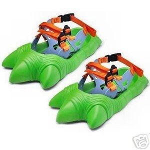

                  What abot this Slipper & Excavating Claw combination? Nice for sand digging?
                    I thing the snowshoe and the dinofoot are too striking. I will use simple plastic (hard foam) slipper.
