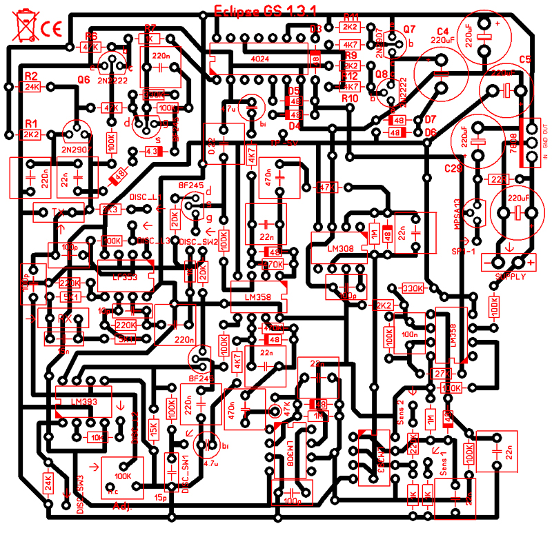

          • motorboating experiment
            My PCB "motorboats" when you turn the sensitivity up high enough (I have the dfbowers mod installed for more sensitivity range).
            I did some tests. To make the sensitivity range higher, I jumpered the 220K resistor R39 with a 47K resistor.
            As I guessed, the motorboating occurs in a narrow sensitivity range. Below the range, it is normal chatter or quiet. Above the range, it is constant tone.
            In the critical range, there is some kind of feedback. Now what is it? I don't know, but did more tests.
            I shorted the RX coil where it connects to the PCB. This gives the best motorboating effect; I guess because the noise drops very low. With the RX coil, the motorboating is more broken up and not as steady.
            So I'm pretty convinced that the motorboating is not magnetic coupling between the headphones and the search coil.
            I suspect more it is in the power rails because the speaker puts a heavy load on the power, and I have even seen the pulse in the outputs of the LM358s and the rails themselves.
            I tried a jumper from the speaker ground directly to the battery ground and lo and behold, it made a difference. The range of motorboating became very narrow and really a higher frequency screech that was not easy to stabilize.
            I was a little surprised because I had tried that experiment before with no results I thought. But this time it seemed to make a clear difference. I think previously that I had the RX coil active, and perhaps there was a noise signal that was partially responsible; or maybe that case did involve some magnetic feedback to the coils.
            Anyway, I am now feeling that it is desirable to use a PCB layout where the speaker ground has a very close connection to the battery ground, so you don't send all that current down a long and winding rail.
            In fact I have a new PCB where I have done just that, and I'm wiring it up right now (takes days with my boneheaded method).
            But I realize I didn't go far enough. Why not have the -5V supply ground similarly close to the battery ground? That supply makes notoriously wicked spikes on the rails (although there is no evidence they cause harm -- they just look alarming if you have a good fast scope).
            So I'm working on a newer PCB layout trying to get the speaker, the voltage regulator, and the -5V supply circuitry close together so the grounds go directly in a more "star" configuration.
            I think Eclipse (haven't heard a peep from Eclipse lately) might have had a layout somewhat like that. Yes, I just checked. It looks like a very good layout, worth looking at again. He did some interesting experiments with a big "ground plane" around all his wires that didn't work out, but interesting idea anyway. I think it's a very worthy layout though. It is I'm sure based on one of Ivconic's layouts, so he maybe has very similar one too.
            -SB
            (P.S. top and bottom copper layers merged in photo, jumpers not clearly distinguished)
                -SB
                Nice observation! This may be worthwhile looking into. I see a lot of sloppy things going on in the circuit that don't really affect the basic functionality of things or do they!?
                As far as the motorboating symptom. I have only seen this twice with mine.. When I hook up a huge speaker and get it oriented wrong to the coil, or when I detect around the corner of the house where the service entrance is..
                  Simon.
                    Yes, I suspect several ways to cause motorboating. Maybe this last effect is peculiar to my dystopian wiring techniques -- thicker buss wires could help. I'll keep playing with the layouts just in case -- although it's something I am particularly slow at.
                    -SB
