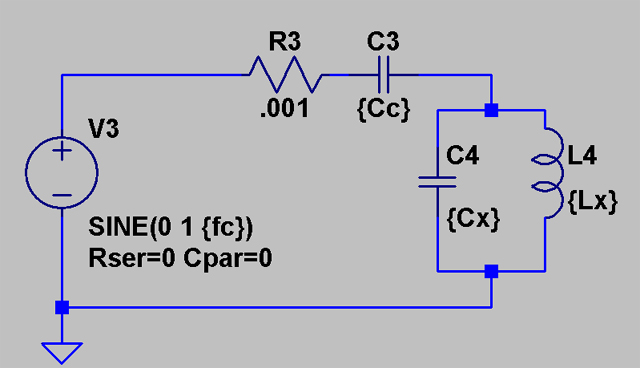

          • Thanks Aziz
            On thinking, I realize I don't know a simple electronic equivalent of nudging a pendulum, so maybe there are practical limitations on my quest for a super underdamped coil... I'll keep thinking...
            -SB
            Aziz's latest circuits for his laptop VLF showed me the simple circuit that is like nudging a pendulum that I was looking for.
            Well, close -- it is not part of an oscillator, but is driven by any oscillator output (with low impedance I assume).
            What's important, if I'm not mistaken, is that it takes advantage of high-Q TX coils, where the TX voltage rises way above the driving voltage, and I assume that provides a higher coil current accordingly.
            Of course the issue of whether such a high-Q TX coil makes more difficulties than advantages remains (ref: mikebg), but it is at least a simple circuit to play with if you can find a nice way to drive it (relaxation oscillator?) -- or build it into an oscillator.
            On the other hand, maybe the easiest way for us to utilize high-Q coils with the TGSL is a center-tapped coil.
            -SB
            • Hi Simon,
              quite impressive this simple LC pendulum. I took a higher Q TX coil (R=0.9 Ohm, L unknown) and the TX coil voltage went up to 45 Vpp with only 1 Vrms input voltage (@29.812 kHz). The source impedance is around 30 Ohms I think (from the sound card). But such a configuration is sensible to reactive and resistive responses. So the source impedance should be quite low and the coil could be damped a bit to make it less sensible to such responses.
              I can measure the losses of the TX coil and its frequency shift. So the ground delivers a lot of useful information here at the TX coil.
              Well, the RX coil isn't processed yet.
              Aziz
