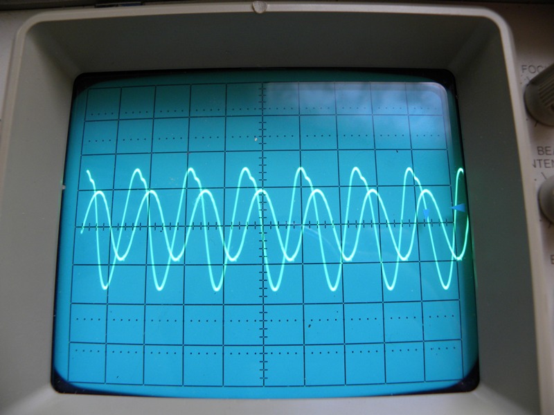

              • Phase shift vs residual voltage?
                I just count the turns in my head. I made a third one, wound it around the former made of nails. The nails were bent at 90 degreeangle, so the thickness of the coil was much like yours: 3mm. I guess it's of no use to make more of them before knowing what to look for in the nulling.
                I wrote the following in the "main" TGSL thread, but I'm not sure if anybody reads it anymore.
                I have a request for all members who have a TGSL which has detection distance of 30cm or more for a (1 eur) coin in the air.
                Would you be so kind and measure:
                - the phase shift between TX signal and RX signal (at pin 7 of the LF353)
                - residual voltage at the preamp output (pin 7 of LF353)
                I'm trying to figure out what kind of combination of the abovementioned I should try on my TGSL to get it beyond 20cm.
                I can get the phase shift of 20 degrees or residual voltage of 450mV, but only one at time. Having either of them "as it should", the other jumps far away.
                All results appreciated,
                Andy
                • Andy,
                  I did not think about it much as performance was acceptable from the first coil that I built. I measured phase difference of 3 coils that I made. In the one below, the Rx lags Tx by maybe 40 degrees, and the residual voltage is about 1v p -p measured at pin 7 of the LF353, Another one, the phase difference is something less than 20 degrees and distance with 1e is even better, but it tends to be a little unstable. Maybe because it is closer to resonance? The only odd thing that I have noticed with my TGSL is the all metal mode does not work quite right. Iron has to be oriented just right to pick it up, unless it is large , but the disc mode works perfectly. I'm thinking of building a second circuit just to compare.
                  Don
                    I'd say this to be around 90 degrees, but doesn't matter. The important is to be able to understand what is the more desirable phase and/or whether it is important or not. In this sense I think Mullihaka's question was quite right.
                    • Now that you commented, yes, it's probably closer to 90 degrees. Now as I remember, I had everything all set in the enclosure before I filled it with epoxy.. When it hardens, it changes things a bit. The GEB trimmer is still set at nearly midrange and rejects a ferrous rod just fine and can still pick up a thin silver coin.
