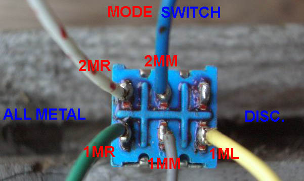

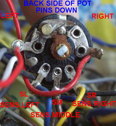

              • MODE switch. I did specially color wire accordance with marking at the schematic Click image for larger version
                • Thanks again, kt315
                  • Legaucho, you are welcome.

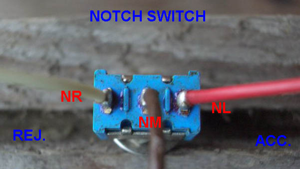

                    same for NOTCH switch. Click image for larger version

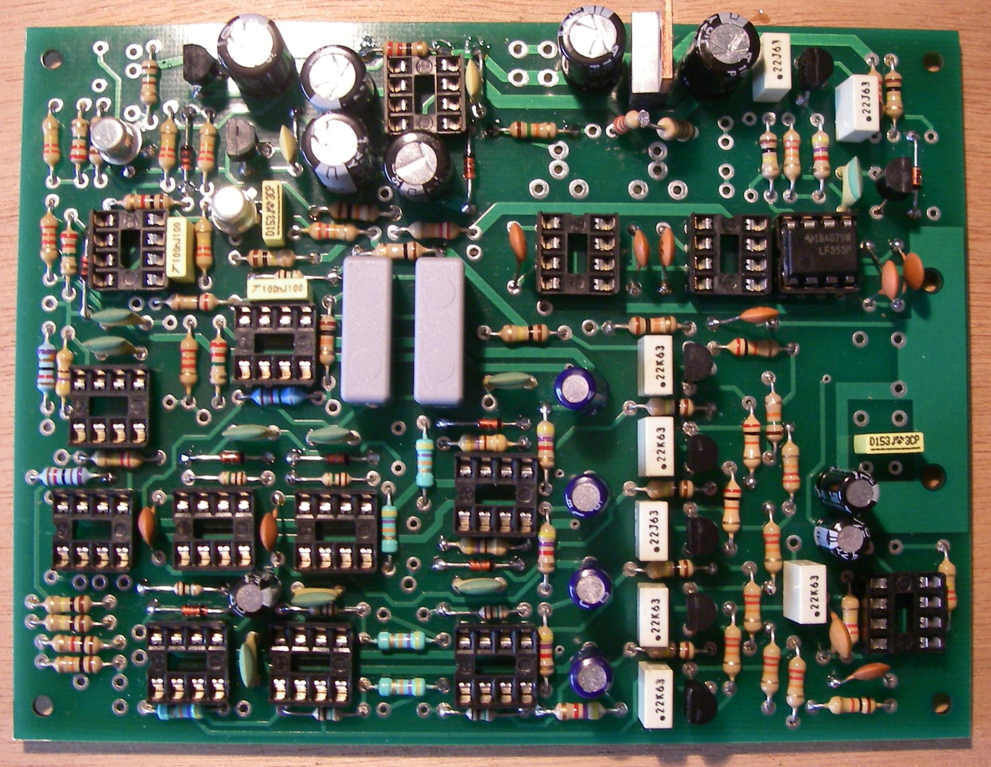

                    • Hello kt315,
                      Some news from me, I'm waiting for some components, I realize the front and back panel of the King Cobra box.
                      Kind regardsClick image for larger version
ID:	333464Click image for larger version
ID:	333465Click image for larger version
                      • wow! nice work . I see C41 and D5 are not in polarity, turn them over.
                          You are right, big mistake . I don't check my job that is no good...................

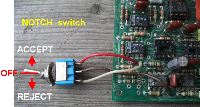

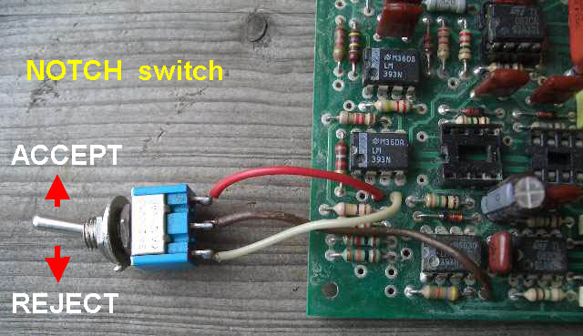

                          • NOTCH trigger connecting at the PCB. In middle position is OFF. Click image for larger version

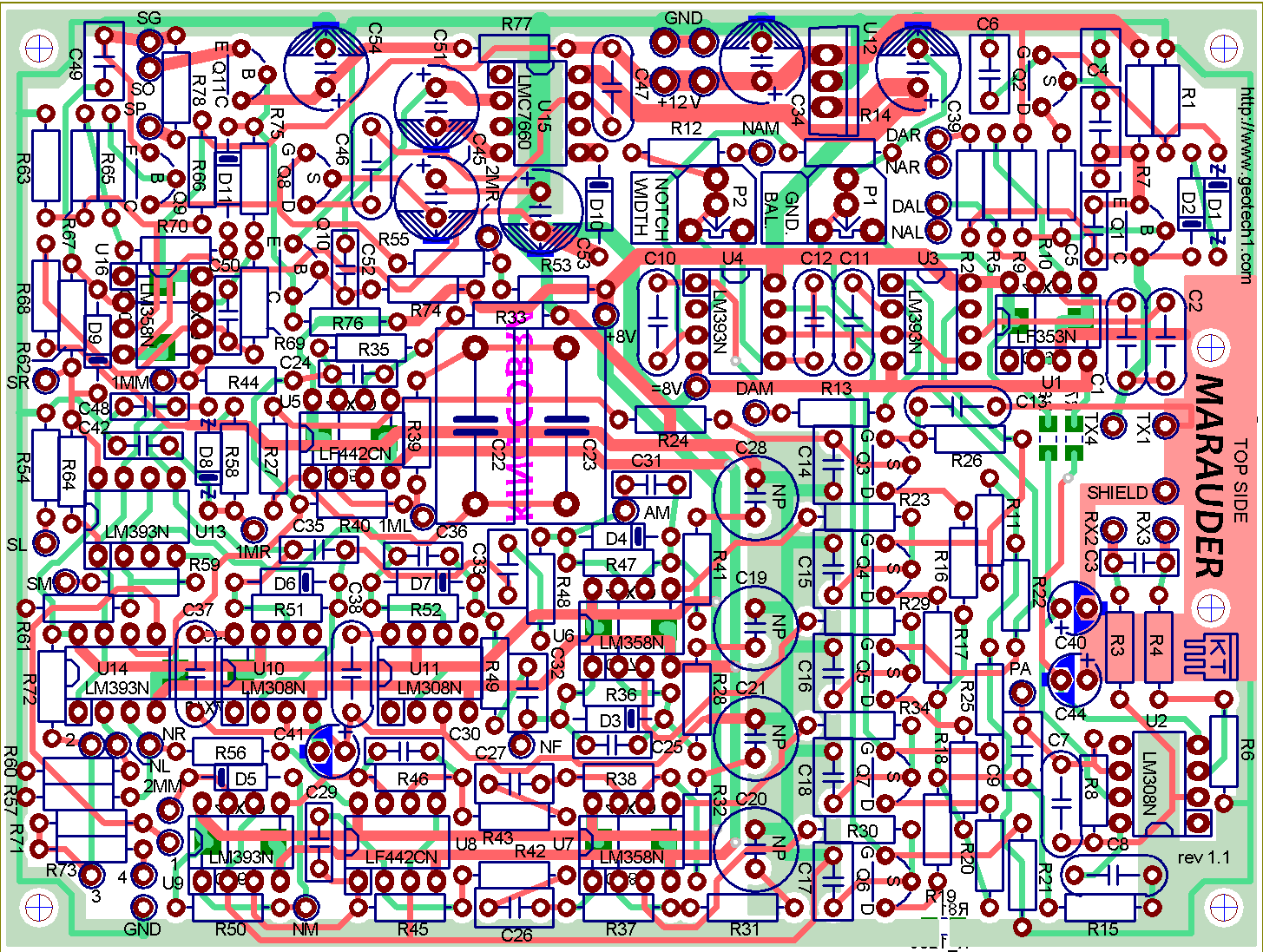

                              • refreshed Click image for larger version
