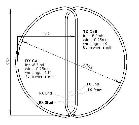

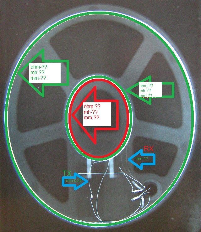

            • How do Coil
              • do not ask me more
                many times answered on this matter.
                Cobra was choiced by me TO COVER ALL TESORO models be cause the pcb is looking optimal and perfect, Cobra has 2 tones and NOTCH filter. so all tesoro coils with 6mH RX TX will fit Cobra.
                Tesoro concentric
                Tx 1,5 5.7mH 22 ohms -- Rx 3,4 6.2mH 22 ohms
                TGSL_DD coil.pdf
                TGSL DD Coil Making.pdf
                • silver sabre - I found in a dutch book of metaldetectors :
                  tx 100 turn of 0.5mm copperwire and a diameter of 200 mm and
                  rx 170 turns of 0.5mm copperwire, diameter 80mm
                  DD_255x137.pdf
                  coplanar_decrypted.pdf

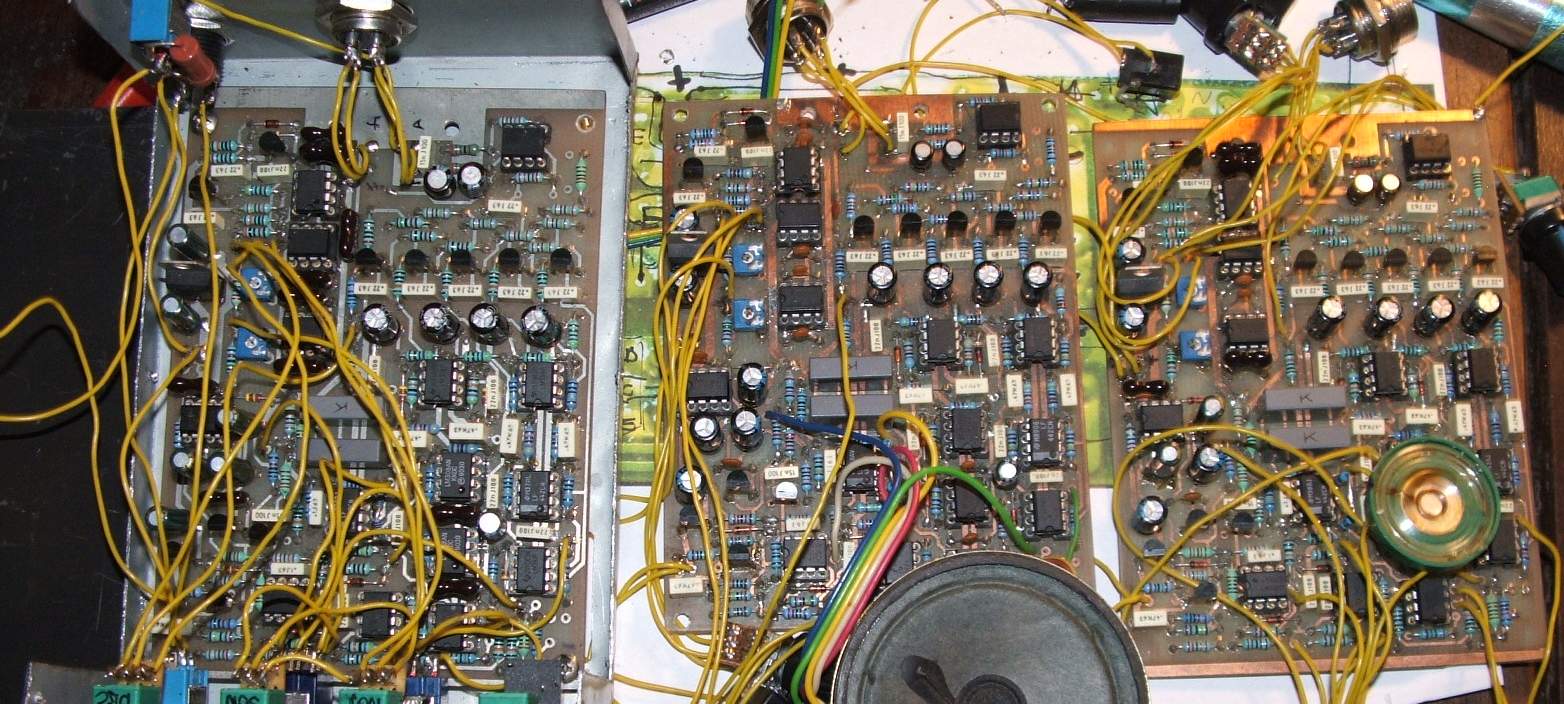

                    • Do You want to know why was noisy my cobra?
                      Because it is not the original IC kit was used.
                      Instead L308 NE5534
                      Instead LF442CN TL082
                      The NE5534 is too large load will be driven to a negative voltage.
                      The TL082 something strange insensitivity causes. The nearby things do not see but a far things see.
                      Who have problems with noise, try to replace the original type ICs.

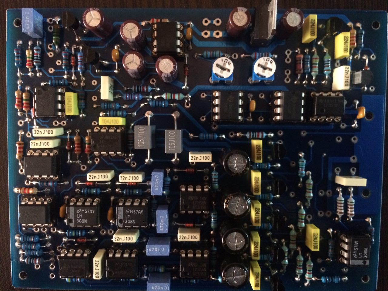

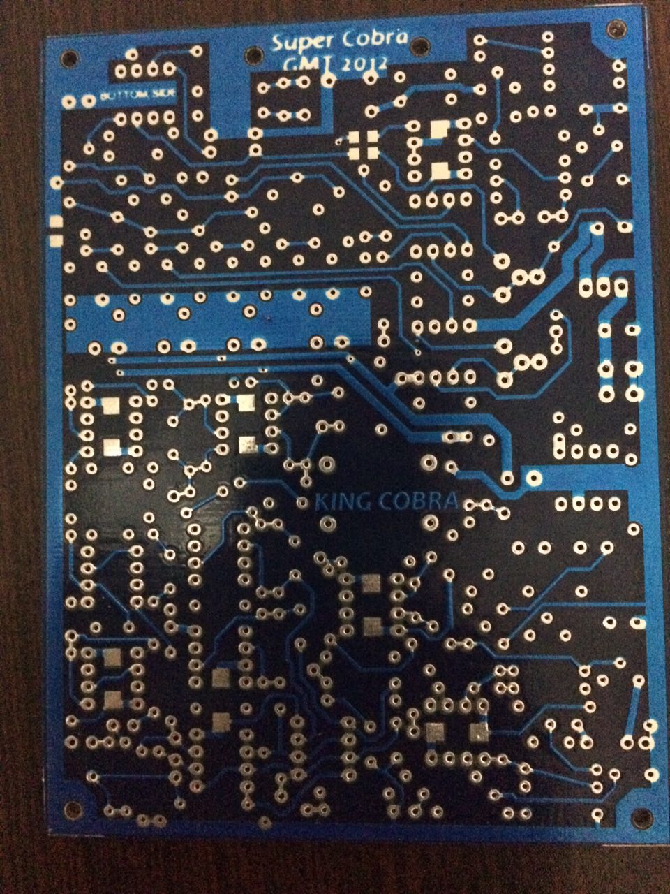

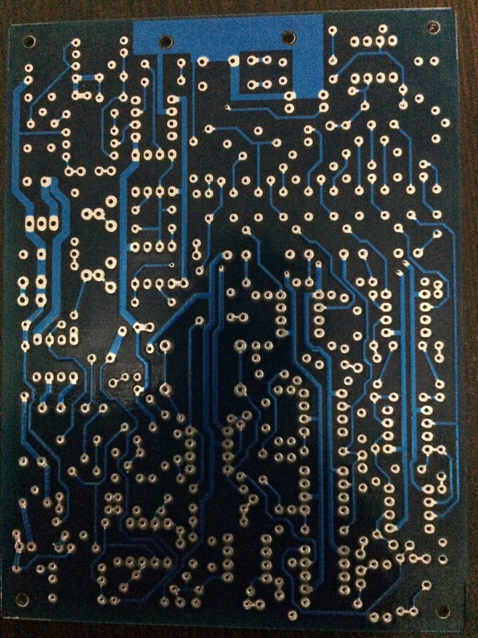

                          • Hi friends Does anyone have or ready PBC circuit cobra in his hand
                            Thankyou
                            • Work will also state the full cobra
ID:	345668Click image for larger version
ID:	345669Click image for larger version
