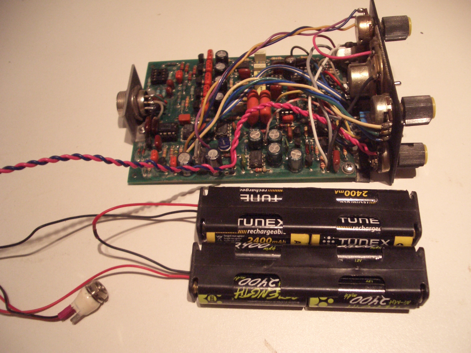

  • from all pics i choiced those

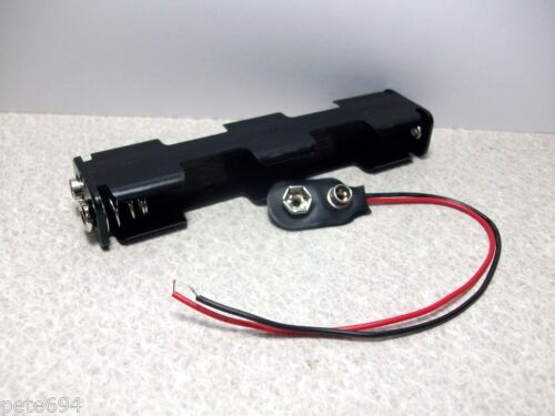

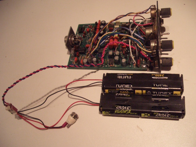

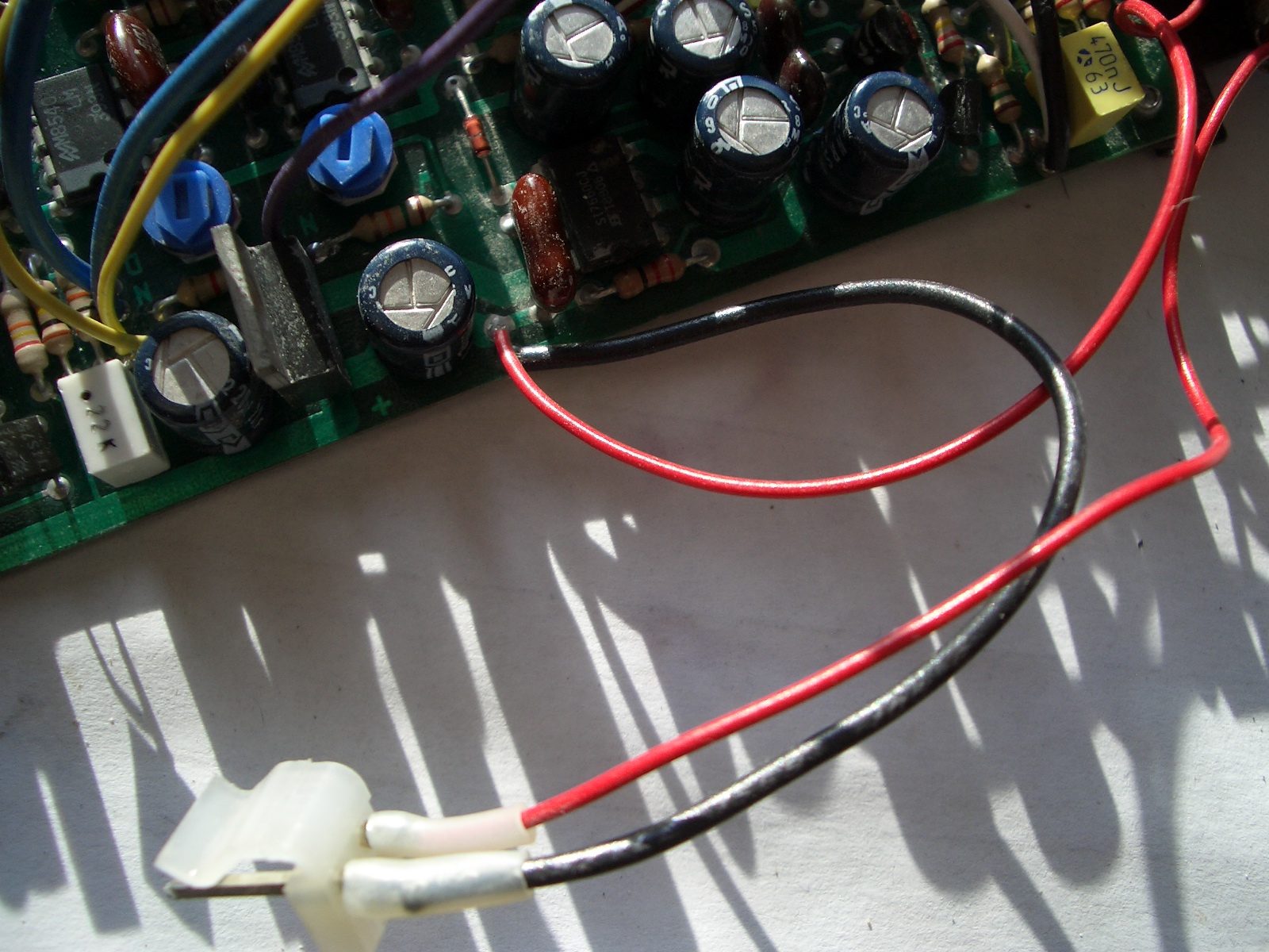

    • Is it the plastic holders for the AA cells that have broken or the wires to the PCB? Those holder area available.
      https://www.ebay.com/itm/6-Volt-DC-B...kAAOSwT6pVxow1

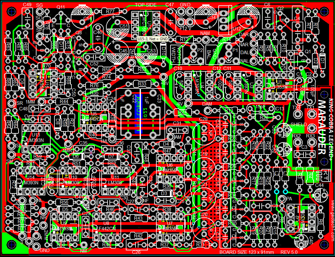

      • Friend i make king kobra not oregenal . The other pcb . I well make it again please witch of them making the oregenal or simple king kobra.
        anyway you can give pics. my name not Yeshua Ha-Nozri to see at distancy what you do there. i'm just kt315.

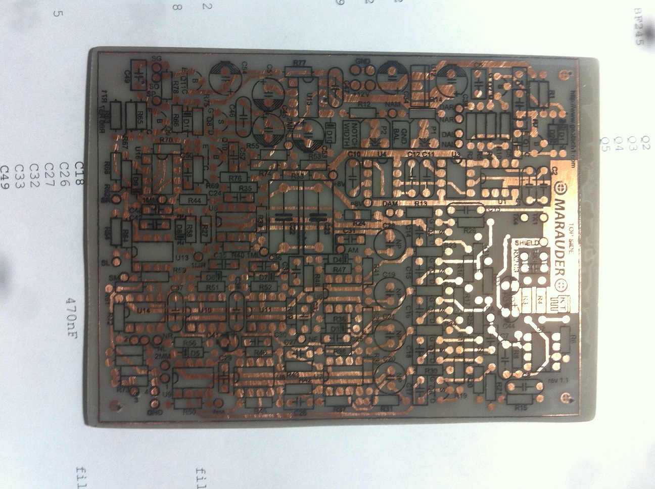

        • Hi all friends ennyone here help to give me the right pcb for print king kobra i just finish it but it dosent works with me it give the noise please help .
          • Hi All
            file King kobr .pcbdoc
            pliease help

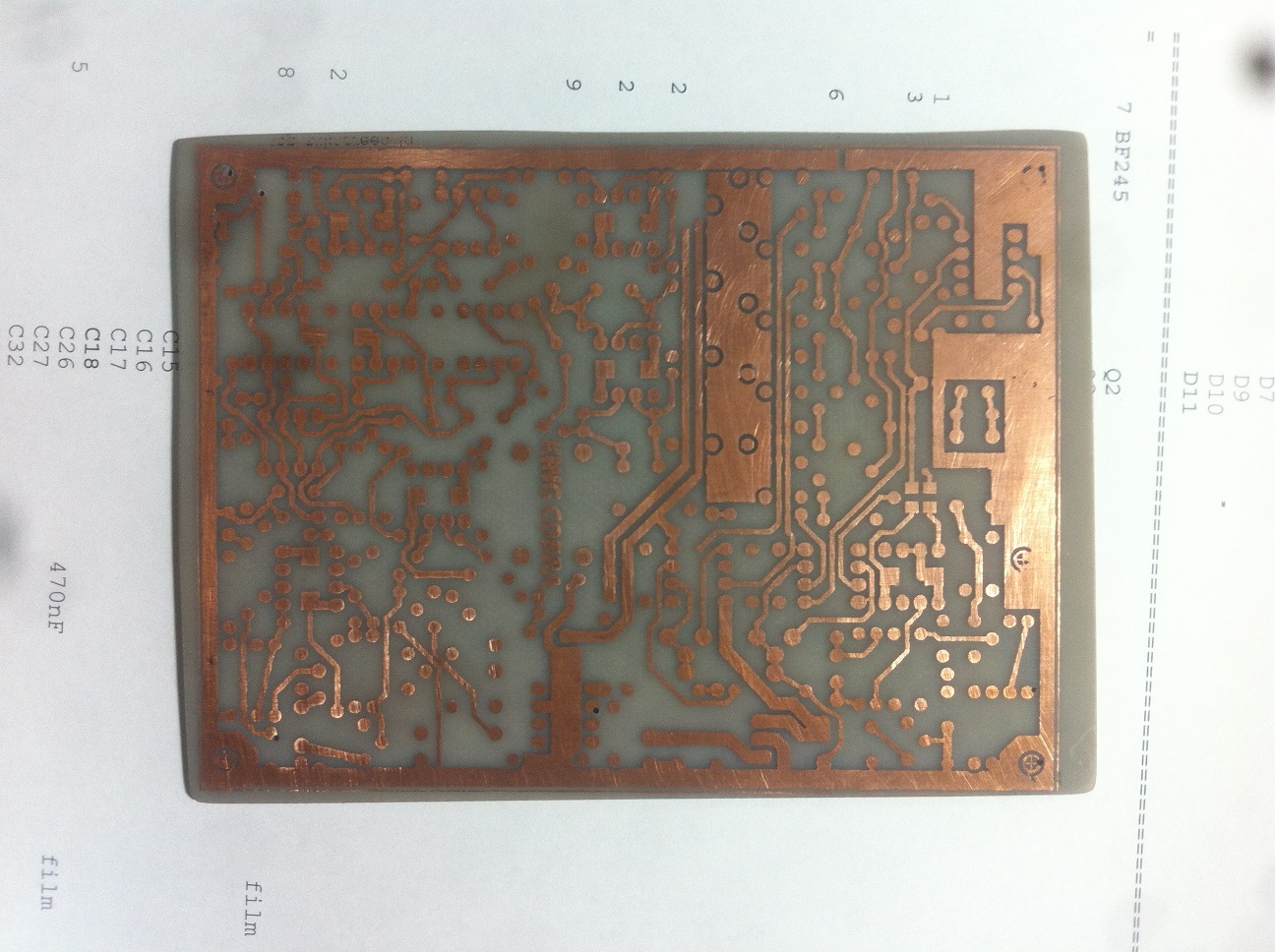

            • First experience
              First experience for beginners like me
              Thanks to everyone for this great forum and special thanks to "kt315" who advised and helped me
              This is my first experience on this forum
              I'm trying to make a "king cobra" metal detector.
              These are the first pictures of the PCB
              I will complete it this week
              • hi mouh i was alredy made this type king kobra but it doesent works with me .
                • Hello sbalio1
                  My friend, I am still working on this project
                  When you're done, I'll give you a result
                  • ok friends im waiting.

                          • Originally posted by -----
                            I WOULD LIKE TO ASK IF THE PCB FROM KING COBRA ARE IN STOCK ?? IF YES COST FOR 2 PIECES ??
                            whole batch was been sold. i am at end of refreshing of the layout now.
                            late i will order new pack.
                            pleasure

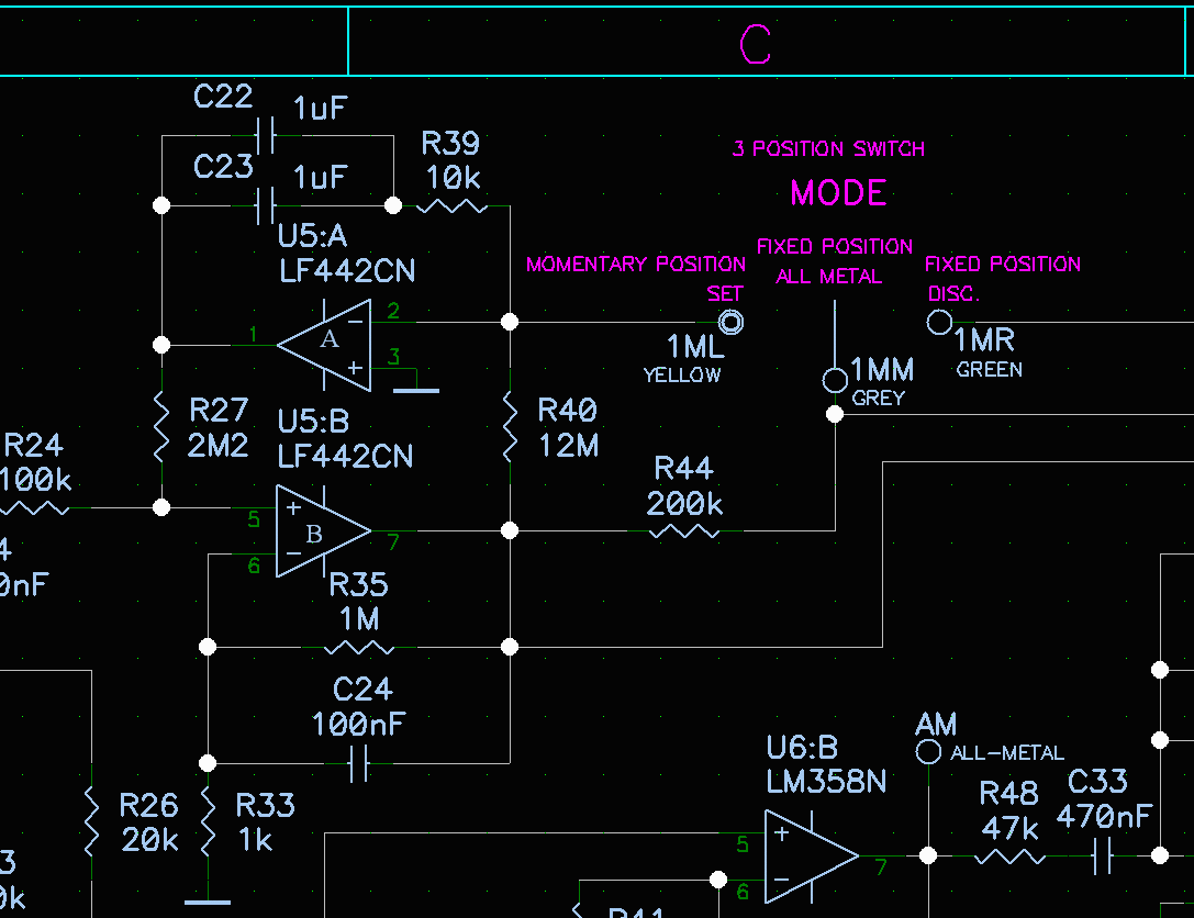

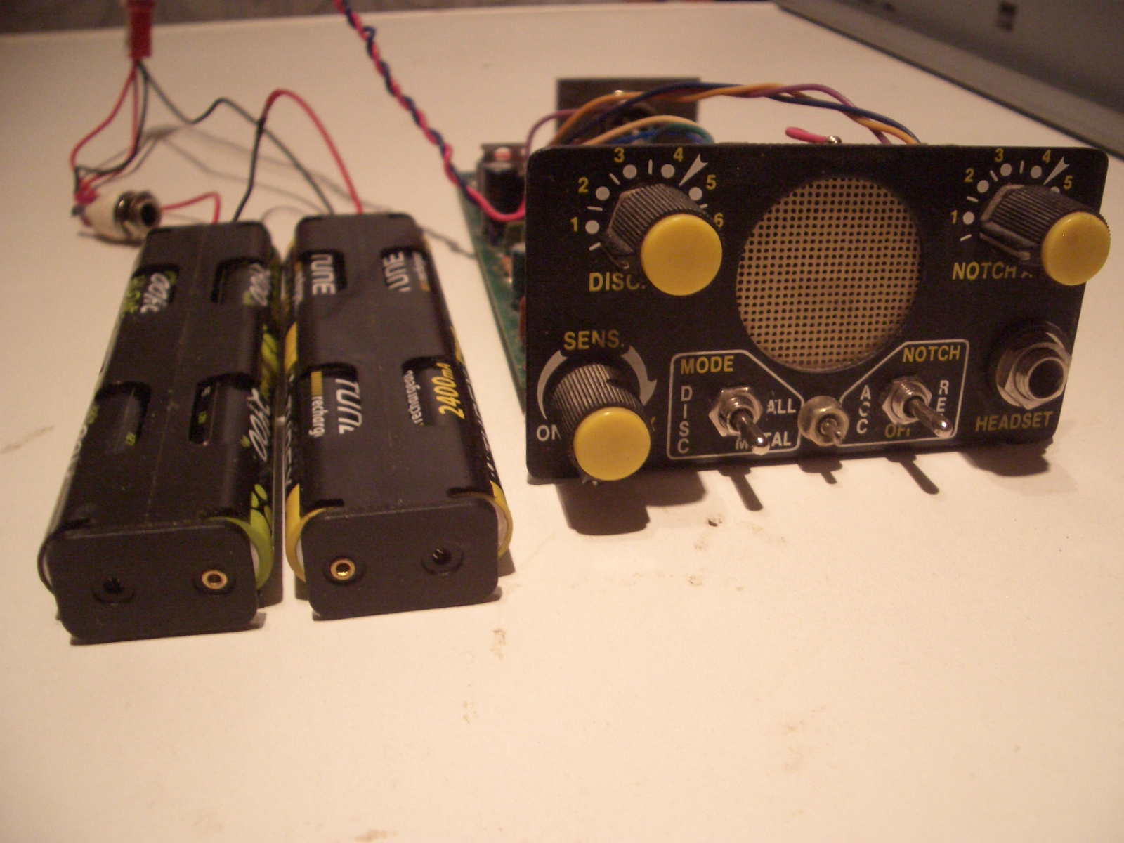

                              Yes, both switches are 3 positions of. This is seems from the photos I did put.
                              NOTCH - ACCEPT/OFF/ REJECT
                              MODE - DISC/ALL METALL/SET ALL METALL.This right position is NOT fixed, not fixedable, is only clickable. Althought you can take and use ordinary 3-P switch, but you have to remember to set the switch in middle position anytime (or fixed left one). SET - I mean you set the S.A.T. circuit to some zero, althought there is nothing new - you have to see this part in TGSL too and may be reading about.
                              Is the MODE switch an ON-ON-MOM type?
                              I have the PCB for ten years and now that I got the time I decided to finally build it. So far I found ON-OFF-MOM switches (MTS-213 DPDT 6-Pin and MTS-113 SPDT 3-Pin) that are apparently very rare, and some even more rare, and also very expensive, used ON-ON-MOM switches from the States (that will cost as much as a used metal detector to ship here).
                              But, if in the Parts List the NOTCH is a "3 Position" and that translates to ON-OFF-ON, then the MODE, which is a "3 Position with momentary" should be a ON-OFF-MOM, right?
                              However, in a previous post it is stated that a CMOS opamp for IC8 must be used in order to be able to use the ON-OFF-MOM SPDT switch. Is that integrated into the King Cobra PCB? Or it has to do with the switch type? Namely, ON-OFF-MOM DPDT is what should be used for the King Cobra, but a ON-OFF-MOM SPDT wan be used if a CMOS opamp for IC8 is also used?
                              (The MTS-213 DPDT 6-Pin is what seemingly what it is used in most builds, but I cannot make the markings from the pictures, therefore I cannot confirm.)

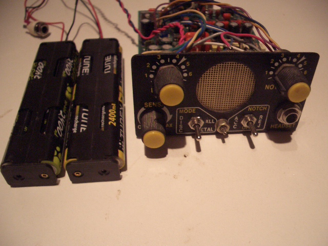

                              • i bought KING COBRA at ebay, for back-re-design, so this text was in owner-seller listing.
                                I have for auction my Gold Mountain King Cobra metal detector.
                                This has been a backup detector and has seen little use and is in excellent Fully working used condition.
                                This is a used metal detector and there are slight use age marks but as you can see from the
                                pictures its in way above average condition for its age. I am only the second owner of this from new.
                                I have taken photos of all angles so you can see the condition of all parts.
                                I bought it primarily as a backup machine, it has been very well cared for and all controls function
                                as they should. Please note the mode toggle switch is a 3 way toggle, left for discrim, centre for all metal
                                and right spring loaded reset. The notch toggle is just 2 way accept/reject.
                                No headphones come with the detector. The headphone socket fits standard 1/4 inch
                                headphone plugs. Battery is NiMh and gives over 20hrs continuous use. Charger provided.
                                The battery is accessed via a panel at the front with two button clips.
                                A VLF slow motion discrimination detector using an 8" concentric coil, the detector operates at 15khz. Weight 3lbs
                                Auto ground balance, All metal and pinpoint non motion with adjustable notch discrimination if required.
                                This detector when first released was top of the range and is quite sought after due to its simplicity and
                                excellent iron discrimination.
