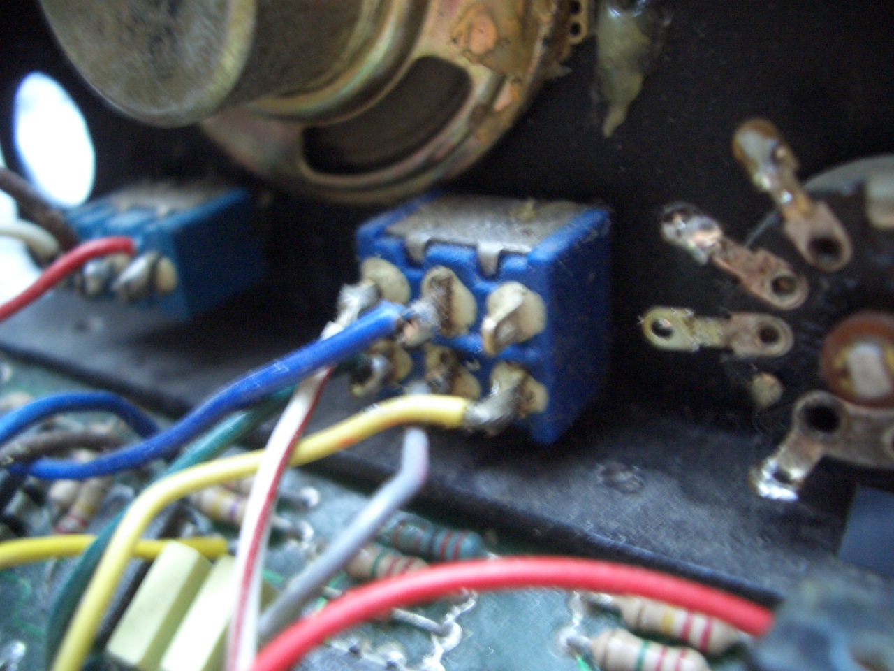

  • second section of the switch look on R53 R55
    • 'mode' switch on the panel. colors of wires marked on the circuit.

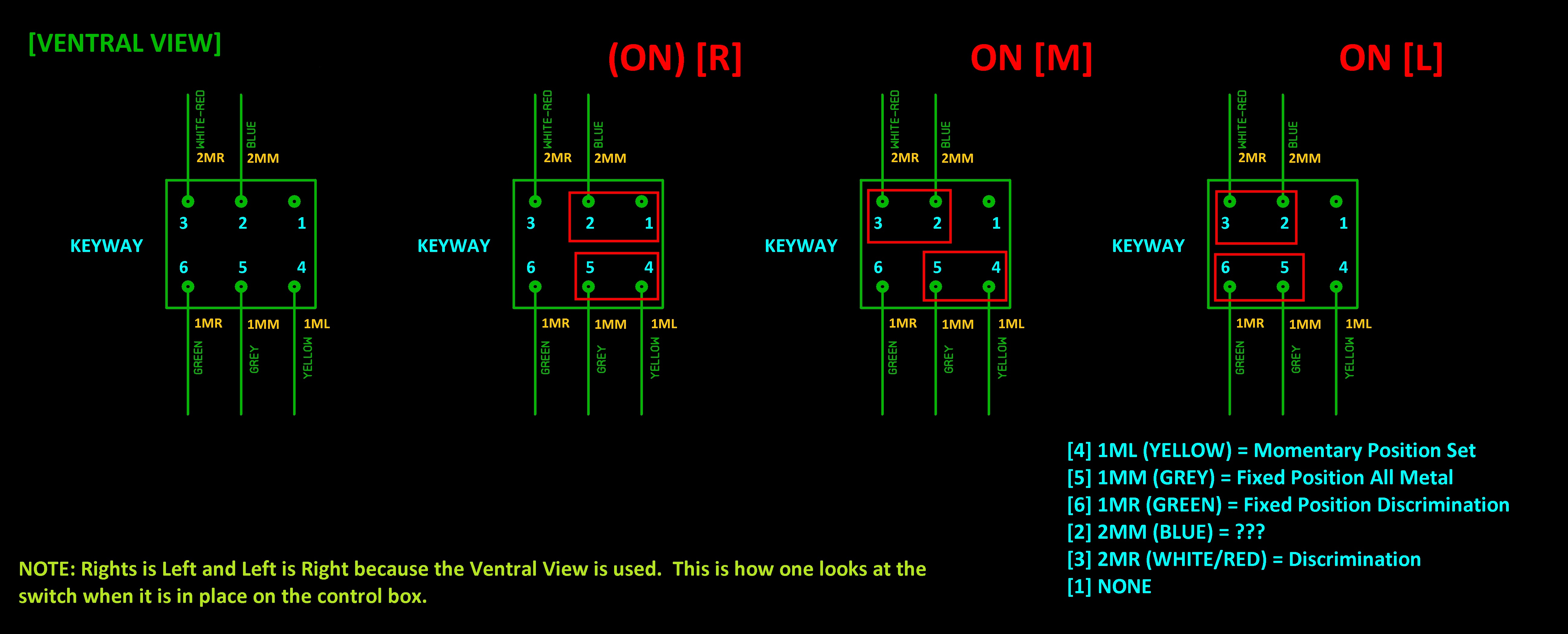

        Now every piece of the puzzle falls into place. The MODE Switch is of ON-ON-(ON) type. This way, when the switch is in the middle position, the Discrimination circuit is closed and connected to the Fixed Position.
        More precisely, the MODE SWITCH positions are:
        ON [Left] (DISCRIMINATION) = 1MM + 1MR , 2MR + 2MM (5 + 6out , 2in + 3)
        ON [Middle] (ALL METAL) = 1MM + 1ML , 2MR + 2MM (5 + 4out , 2in + 3out)
        (ON) [Right] (SET ALL METALL) = 1MM + 1ML , 2MM + NONE (5 + 4out , 2in + 1out)
        With the cables and poles
        [4] 1ML (YELLOW) = Momentary Position Set
        [5] 1MM (GREY) = Fixed Position All Metal
        [6] 1MR (GREEN) = Fixed Position Discrimination
        [2] 2MM (BLUE) = ???
        [3] 2MR (WHITE/RED) = Discrimination
        [1] NONE
        Also, if every toggle switch of this type follows the same principles as the T80-T Series I referenced, then the keyway should go to the right for the momentary (ON) position to be on the right.
        I also made a picture by adopting a picture from a previous post:
        Now, I only have to find one of these super-rare ON-ON-(ON) switches...

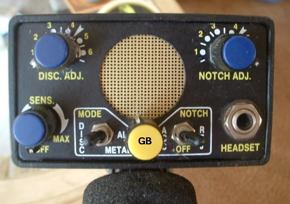

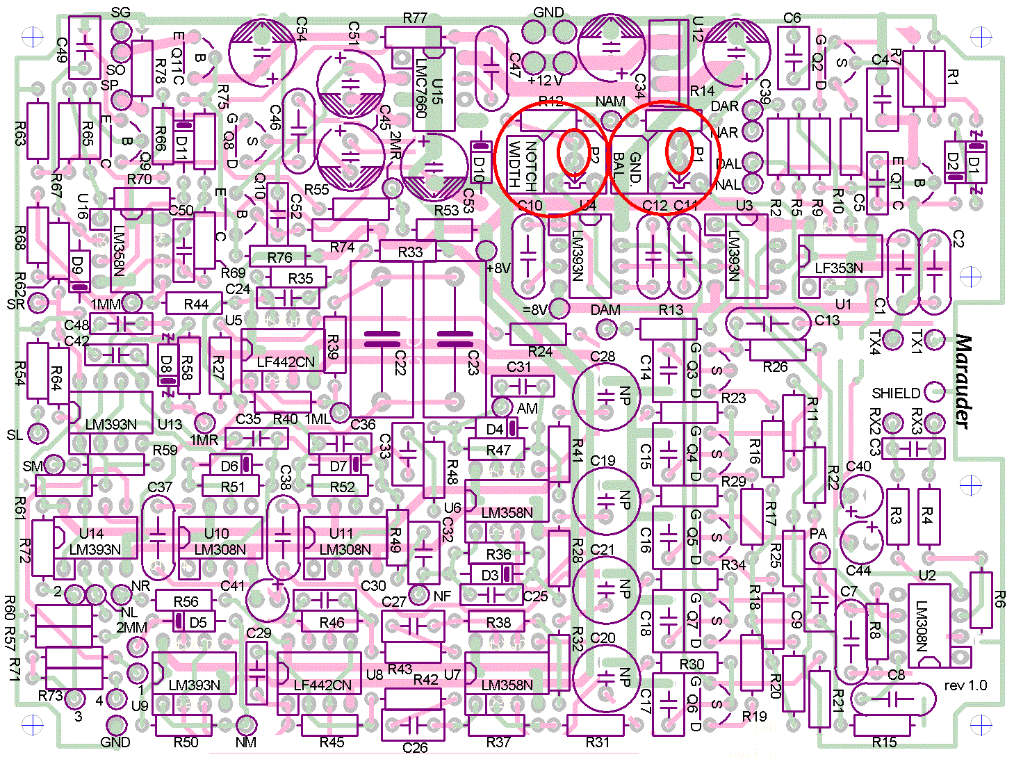

                      I am currently designing the Control Box. I want to have Ground Balance and Notch Width potentiometers adjustable by the user on the field.
                      That is easy to do with small cables soldered on the PCB, however, potentiometers have three connectors (1, 2, 3), but the PCB has four holes for the trim potentiometers (see picture below). Two of the holes seem to be on the same line, therefore, should these be joined?
                      Also, since the trim potentiometers are 100K, the normal potentiometers, logically, must also be 100K, but, should they be logarithmic or linear?
                      • Yes, the two holes should be joined on the PCB. The reason there are four holes is to use two different size pots. This is also known as a 'dual footprint' allowing a wider selection of parts.
                        Linear or Logarithmic depends on the pot's function. Most likely they are linear.
                        • waltr is sure accurate. thank you. use 3 turn pot for GB. '3T pot'.
                          • Yes, a multi-turn pot will make GB adjustment finer.
                            Good point kt.

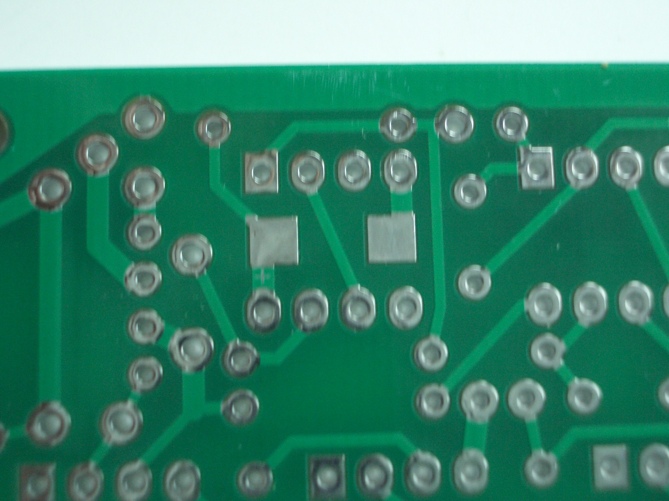

                              • tantalum place pads Click image for larger version
