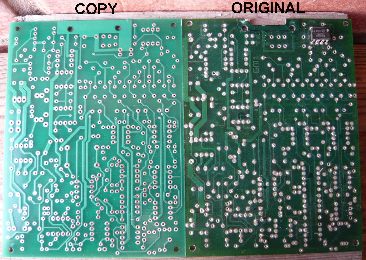

              copy vs. original

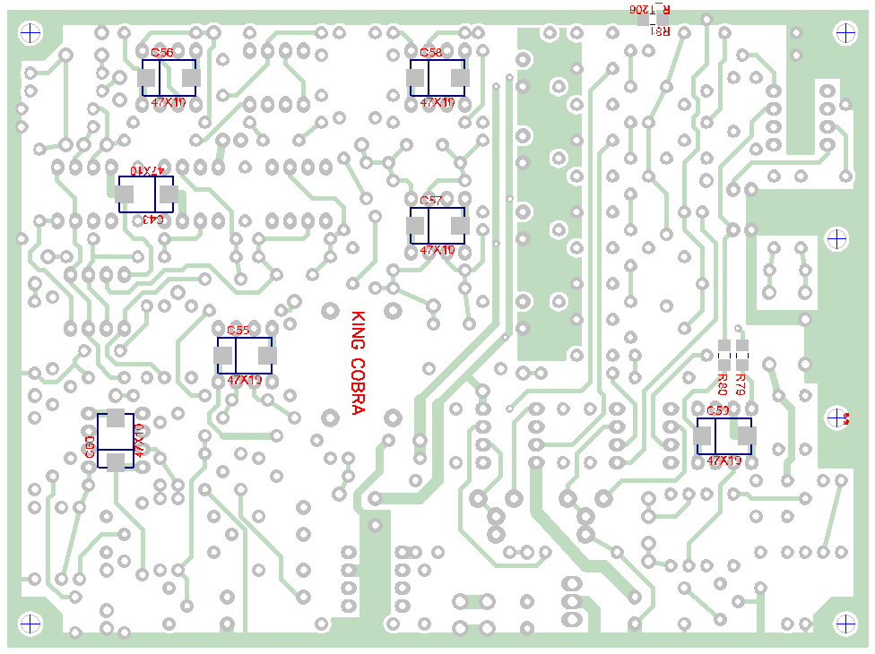

                You will get small expirience in SMD soldering too. It will be useful for you if you are a beginner (small bonus). There are a places at bottom side for SMD resistors and capacitors, I added especially them as a filtering-blocking in power supply lines to ICs.
                P-CAD Component Locations
                RefDes Layer
                C43 Bottom
                C55 Bottom
                C56 Bottom
                C57 Bottom
                C58 Bottom
                C59 Bottom
                C60 Bottom
                R79 Bottom 18-24 Ohm
                R80 Bottom 18-24 Ohm
                R81 absent, do not set it
                A type of the capacitors is tantal 7343 or 7343H, value is 47 or 100 uF (the more the better), 10 or 16 V. A type of the resistors is 0805, 1206 or/and 1210.
                You can find the caps in any oldie apparatus - motherboards, videocards, HDD boards, etc. Ie that you are able to find around - and set these.

                    smd parts as like you see them on bottom side.
                    • #85
                      ups! misleading. my mistake, sorry. right voltage in this list.
                      RefDes Layer Voltage
                      C43 Bottom 16V
                      C55 Bottom 16V
                      C56 Bottom 16V
                      C57 Bottom 16V
                      C58 Bottom 16V
                      C59 Bottom 10V
                      C60 Bottom 25V

                              do you mean original or mine? I did full copy from original, but in the process I speedy found out the layout is not optimal as I did consider it. thought there is not a road aback anyway
