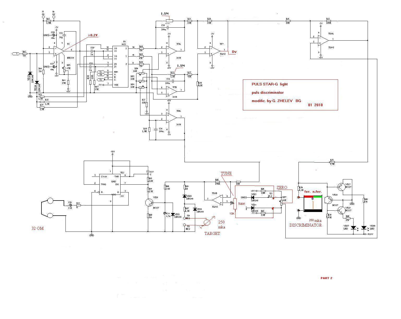

        Hi Georgi ,
        CAn you give information about how does this detector discriminates?
        I mean , ferrous or non ferrous or something more? and how it does?what is the difference at signal that are detected by circuit?

            As i see there are 2 channels with different delay. If so, it is able to reject metals with high or low conductivity, not ferrous - no ferrous.
            Georgi can tell us more...

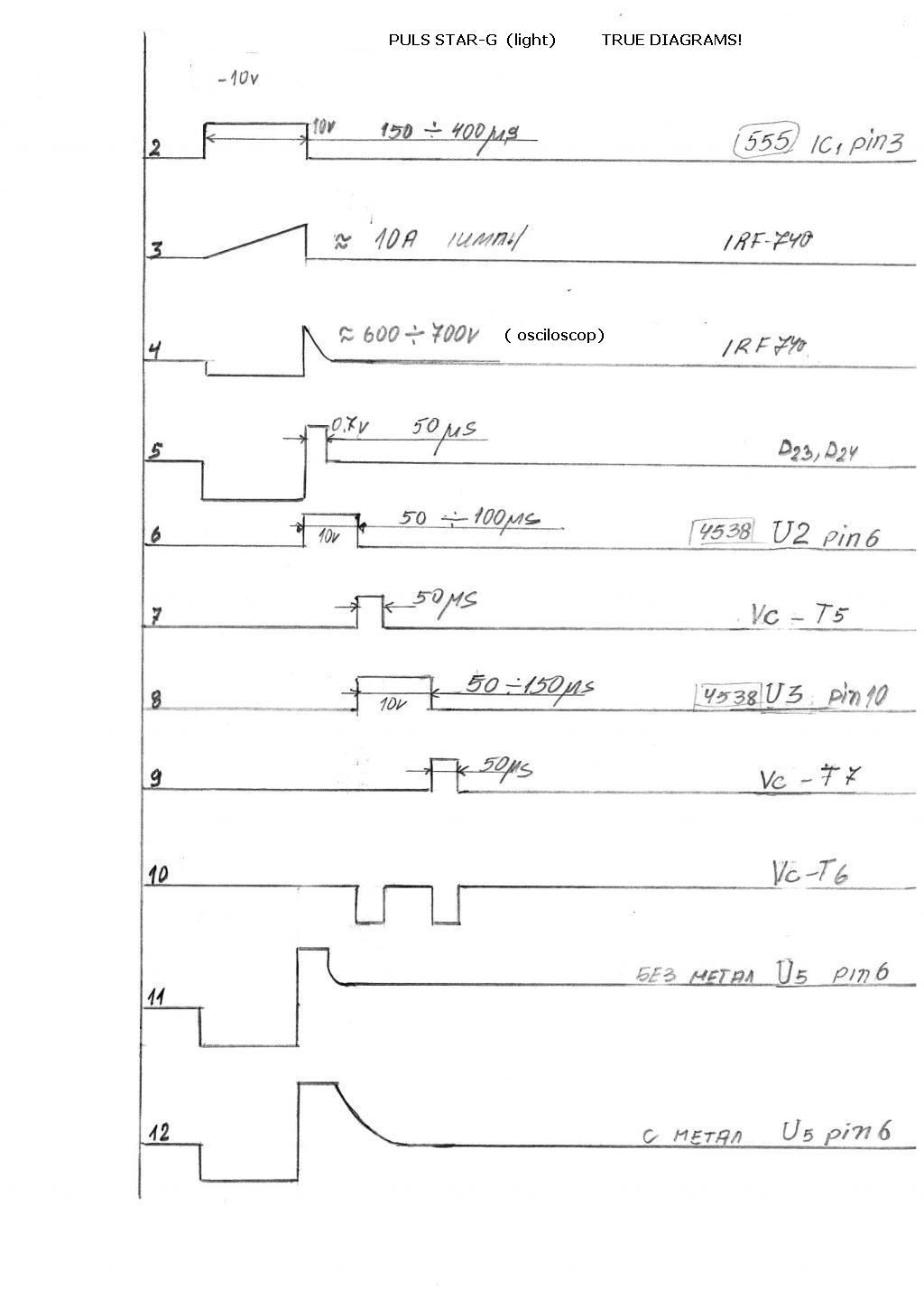

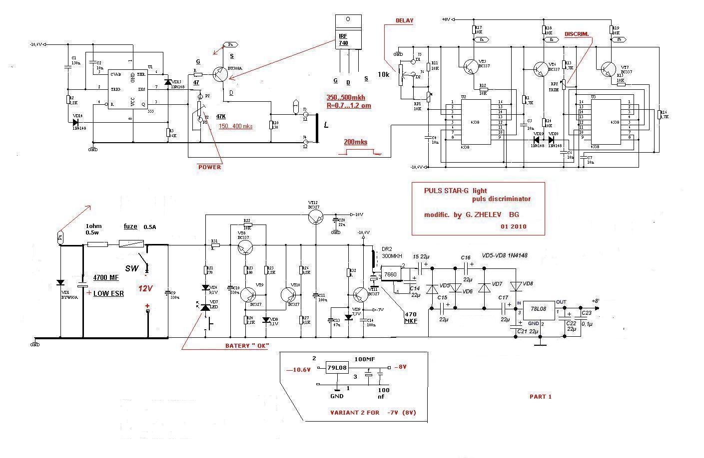

              Hi,first pleas excuse me for my very bad english. Pleas short questions.
              PS-G light TRUE DIAGRAMS !
              The diagrams are not true from bok !

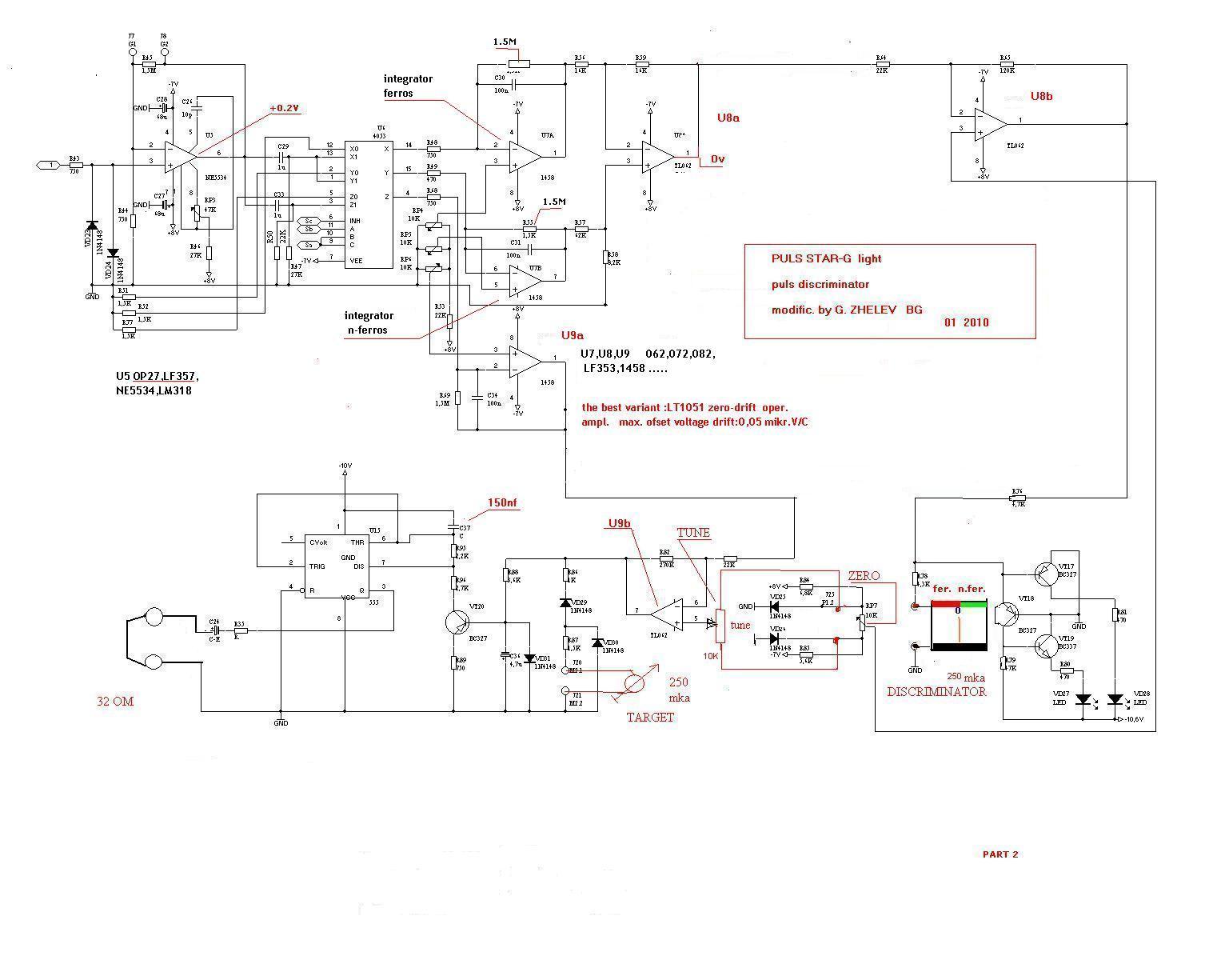

                            Hi Georgi,
                            excellent work. Thank you.
                            Some data (part value) on schematic are unclear. Can you post schematic in better resolution or maybe part list?

                              PS-G light
                              Tank wm6, hi Geo.
                              DISCRIMINATOR:Yes , evrithing is very simple,2channels diferent delay(ferros ,n-ferros) >2 switchs > 2 integrators > diferential amplifer > indikator ( ferros n.ferros )
