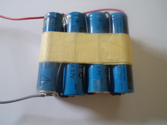

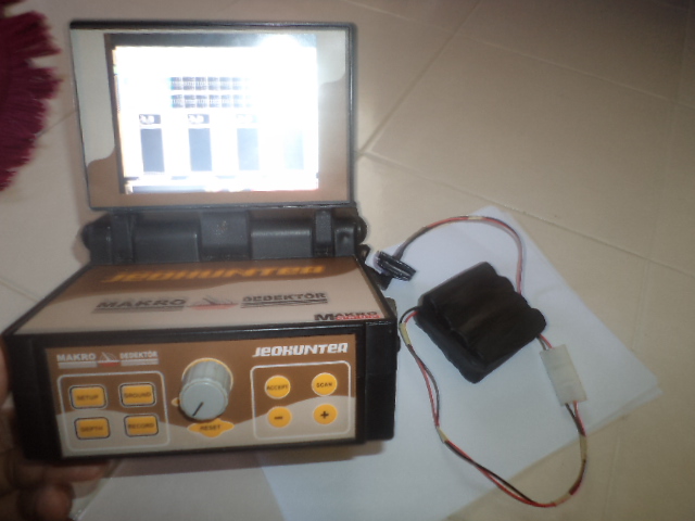

    hello my Friend Fun Finder this are the picture you ask of the new accu pack that i build and don't have enough volt and the loading cable the charger privides and with the setting set set of the device . volt output li pro charger only have 5.A and the volt current 3,6v(1s) 7,2v(2s) 10,8v(3s) 14,4 (4s) 18,0v(5s) 21,6v(6s) and AUTO the capacity cutt off can be setting 10mah -20mah over
    i hope you can guide me my friend thanks
    geo-i

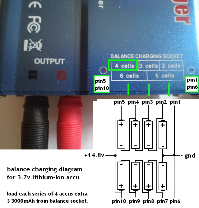

        I created a diagram for you. good luck!

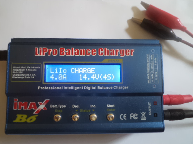

        Your charger has enough power for single cell balance charging.
        this way you also will get the best performance and power.
        The voltage difference is no problem, you will measure more
        voltage if the accus are connected at the charger and almost full.
        If you cannot set it to 3000mA manual while balance charging
        set it to AUTO cut off at 10mAh over.
        But usual this is for
        NiMH only. Li-Ion loading has a cut off if the power has
        reached 4,2v.

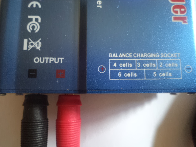

        short info:
        - solder cables at your accu-pack with useful contact for the
        balance charging connectors (2times 5 cables and connector)
        - switch on the charger and set to li ion balance auto or 3000mA
        - connect correct cables with the plugs for balance charging
        Start at the (-) (PIN1 or Pin6) and use the 4 following plugs left.
        - wait around 1h until the first 4 accus are fully charged and
        then connect the other 4 accus and load them, too.
        Have Fun!!!

                  Very good luck with the accu-pack and later have really fancy
                  adventurous search-expeditions for finding the treasures!!!
                  btw. it should be possible to load the accu-pack with the
                  2 wires at 4000mA @ 14.8v - but it would take ca. 1,5h
                  to get them completly full.
                  Some Lithium-Ion accus also need a longer time for charging:
                  The original Jeohunter accu-pack needs around 6-7hours
                  with the loader I have (I guess the new one is faster).
                  You may try to load the accupack with the 2 wires at 14.8 v
                  but only with 2000mA automatically within ca. 3 hours.
                  geo-i, if your fully loaded accu-pack only lasts for 2-3 hours
                  at the Jeohunter perhaps one or two of those cells are bad.
                  Have fun my friend.
