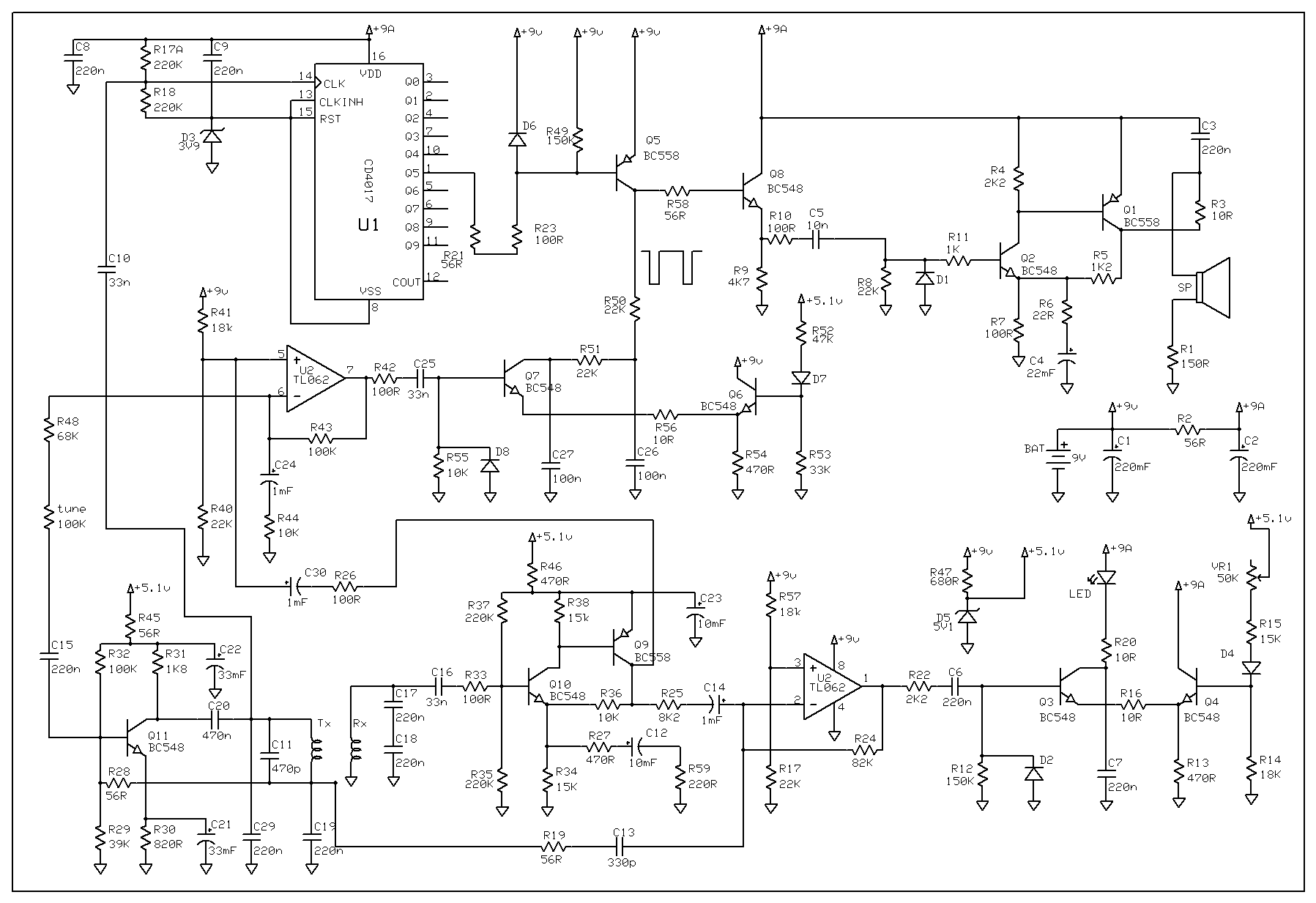

    Hi all
    All you have heard for "Myth " arado120.
    I make this two years ago, with fine results and new design PCB . This machine has voice for all metals and Ameter for discrimination. With this method, we can heard a detection target and with eyes, we can see dicrimination
    Here is sch diagram without errors and full analytical PCB (101,60mm X 81,28mm) without errors too. The next post i publish infos for (how make Tx-Rx coil). My machine work with O-O coils 20cm diametre and detect a euro 36cm distance on air, a box 20cm X 20CM 95cm distance on air . Maybe with D-D coil is better... we want try for this. In practice never i use, only inside laboratory. Easy make PCB, with easy coils and difficult calibration "null".
    I don't answer questions, why I believe this is very analytical, only you want make PCB.. put parts and finish
    In next post I will present photo's, Method of calculations coilsand method calibration "null"
    I wish good success
    best regards
    Andreas

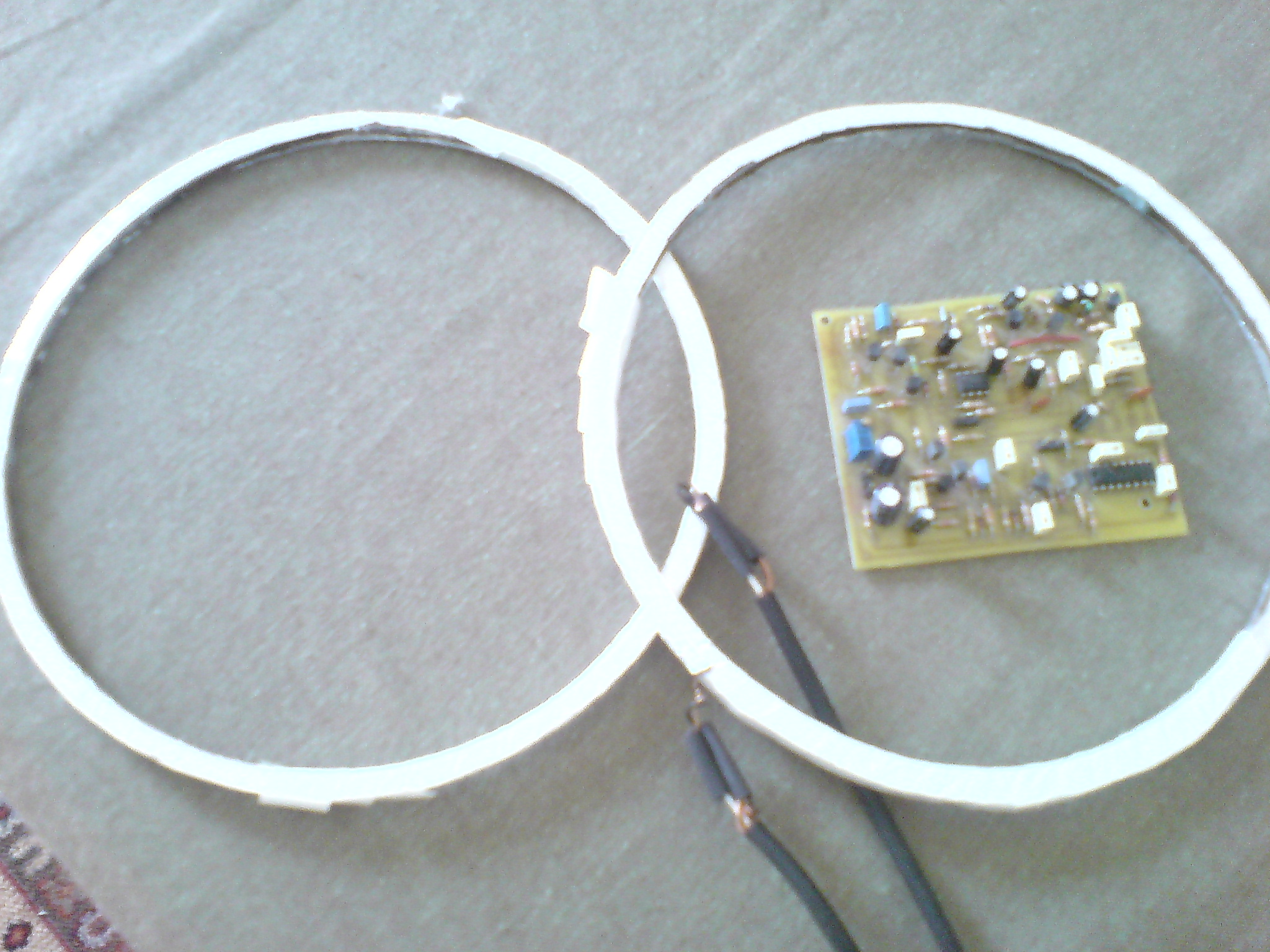

          If you want have "excellent" results, you should be manufacture coils with fine resonate - tune.
          For this MD, you don't need at first step osciloscope, only a Freq-meter.
          The "magic" frequency for this MD is oscilator work 4680Hz.
          How we can this frequency of work?
          Diametre Dcoil between 15-30cm is fine for this MD
          Now a example. You have a form for make Dcoils diametre 25cm.
          Put in this form 200turns copper-wire diametre 0,28-0,35mm. Diamtre copper-wire is not critical, but you cannot use <0,28 or >0,35. Now connect C19-Tx coil your Freq-meter. You see freq-meter example 3400Hz. You start now abstraction turns from Tx coil. In one point example -36turns you see Freq-meter 4680Hz. Thats all.
          Only you should be know, how much turns abstraction, because the RXcoil should be have this formula. RXcoil(turns)=Txcoil(turns)+45turns. With this method, you have two excellent Dcoils for this MD
          I think you understand well all steps for make easy this coils
          best regards
          Andreas

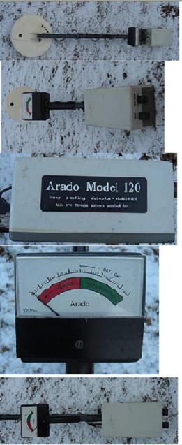

            Here some view on original (taken from web):

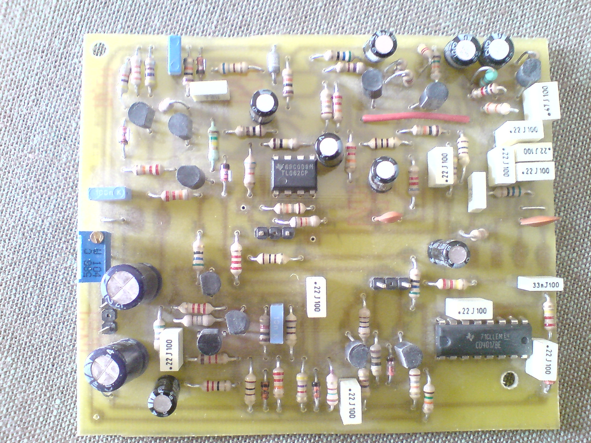

                          Two photo's
                            Originally posted by ANDREAS View Post
                            Two photo's
                            Nice pictures. Can you measure inductance of RX an TX coil?
                              This is not essential. Depending on the diameter coils and knowledge freq-osc
                              we have different induction for resonate osc-circuit .
                              Here we want osc work 4,68KHZ
                              Only we must be try for make out this freq.
