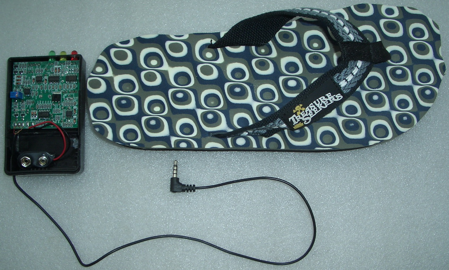

The idea with winding the coil-wire around the shoe-sole was a nice inspiration.

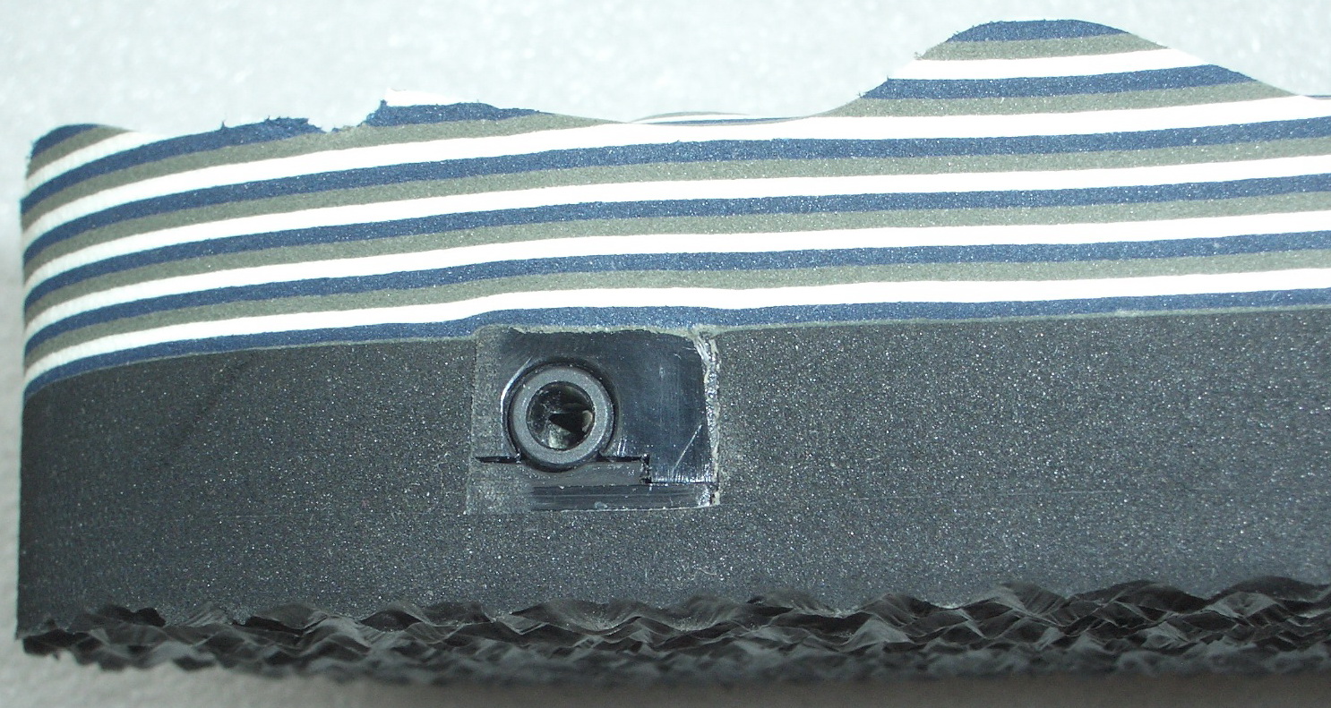

The easy way is cutting a small crack around the outside of the sole,
deep enough so the windings have enough place and seal it from the outside.
attached the design of the used shoe-profiles.
To eliminate walking disturbances only one shoe should be used and
the sole must not be too flexible or even better:
it should be sold stable like made from wood or very hard plastics !!!
Because if the coil gets bended while walking it will gives failure-signals
or it would reduce the sensitivity alot.
So better throw away the idea with using the sole directy but
lets think about a waterproof eliptical ring that includes the coil
and fits the shoe-size from the outside !!!
This also has the huge advantage that it can be used for many different shoes.
The shoe-attachable coil should contain directly a litte lipo battery including a wireless transmitter.
If its possible to bend each of the coils of the XP Deus DD coil like a banana so it fits left and right around the shoe,
the foot or shoe can be used directly as the coil-holder.
If the shoe-sole is high enough, attaching such a coil is no problem -
just cut a gap on the tip and back of the shoe into the flexible material and make the coil in a size
so it can be clamped simple there - if the coil is a bit stable and flexible it will hold perfectly by its on housing-tension!
