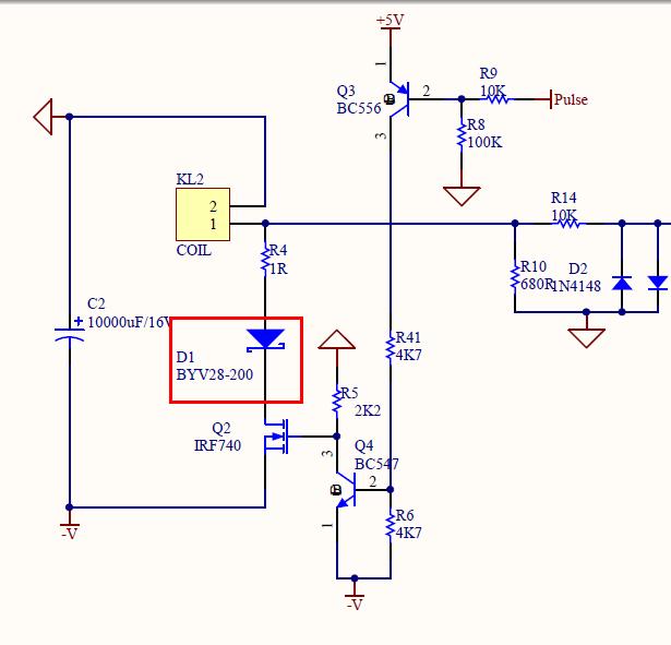

              Hi i cant find this shotkey diode in my country can i remove it from schematic thanks br!

                Salim, don't search for "shotkey" ; search for "Schottky"!

                  it is NOT Schottky diode, may be Fast Recovery one. take oldie VGA-SVGA monitor and find those a bunch.

                        SEE ABCELECTRONIQUE.COM OR ALLXREF.COM FOR BYV28-2OO EQUIVALENT
