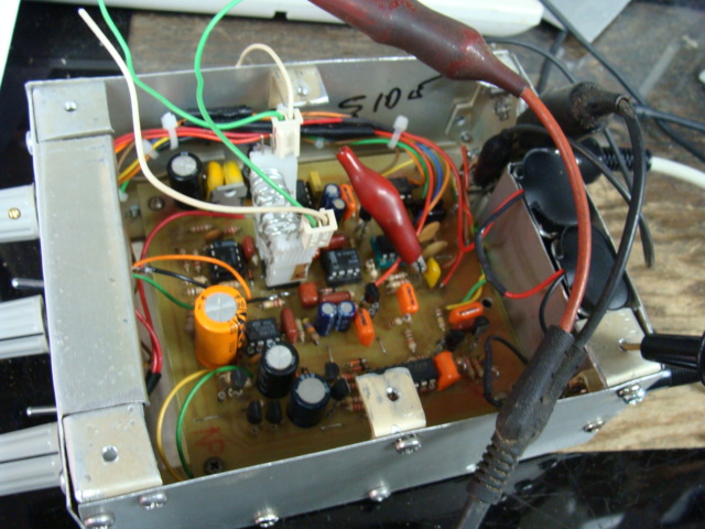

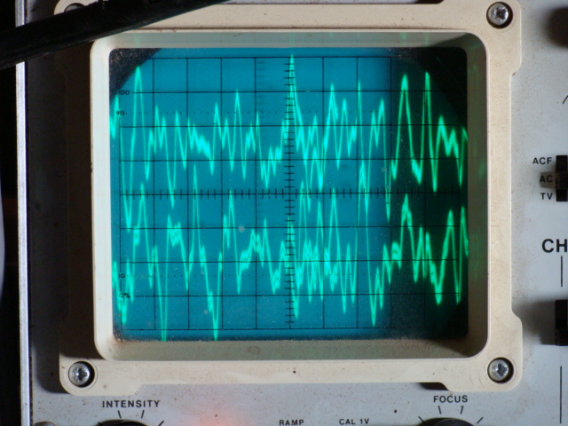

        Well here is what I got this evening. The camera drove me crazy for a while trying to set the shutter speed, but I finally got it.
        The scope was set for .1 sec/div and 10 mv/div for both channels. I have no idea on how accurate those numbers are, so I measured the Disc channel with my DVM and it varied from .2 to 1.0 mv. The scope will be showing peaks the the DVM will not respond to but it is not a large signal.
        The camera shutter was set at 2 sec.
        The second picture shows an alligator clip jumpering J2.
        The exposure starts towards the right of the screen and wraps around. I was expecting something a little different from what I had yesterday because of the longer exposure. I didnt have time to put the signal generator on channel two for reference but now I am not sure what that would prove.
        I thought I had something yesterday, now I am not sure.
        Jerry

          Hi Jerry:
          Thanks for keeping at it. That looks more familiar to me as noise with no coil. Hang on to it, it is a good reference for comparing our basic "PCB noise" levels. Unscientifically I would call that a "15 mV pp" range noise.
          The two signals seem quite well correlated if you look closely. I'll have to think about what that means. It depends somewhat on the DISC and GB pot settings. It might be interesting to increase your sweep speed one notch and then play with the pots and observe how the correlation changes.
          I was thinking - a good way to test for noise from the 4024 chip would be to trigger your scope on one of the 4024 output pins, for example Q7 (the lowest frequency). Then any "noise" signal from it should be very locked and stationary, no drift left or right.
          Final thought -- on your previous ferrite tests (with the whirly-bird), I saw one trace that seemed the inversion of the other. I'm thinking now that perhaps I would expect to see both traces the inversion if the null phase is flipped from one side to the other. However, this may depend on the exact phase of the nulls you picked and the sync pulse phases, so would need more data to fully analyze it.
          Your pics are very good, that was a success.
          -SB

            Hi Simon:
            The biggest thing to get used to with that last picture is we are looking at a sub-audible noise. The entire length of the trace shown is two seconds. Because of the digital camera delay in starting the exposure, it is really hard to judge when to press the trigger button. This particular one starts one the right and wrapps around.
            Will keep experimenting.

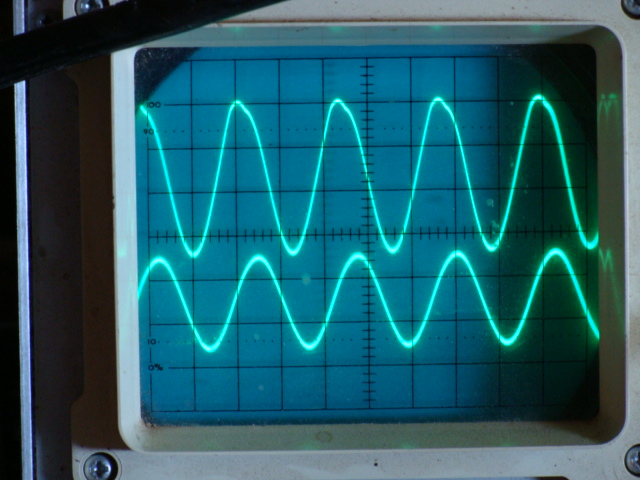

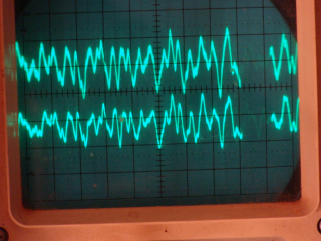

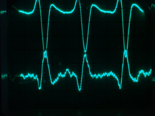

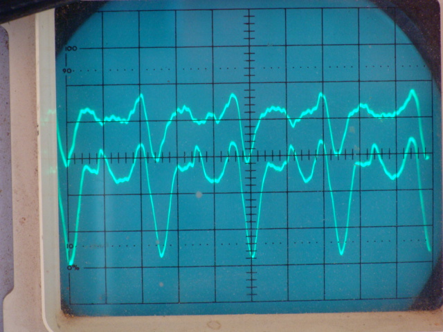

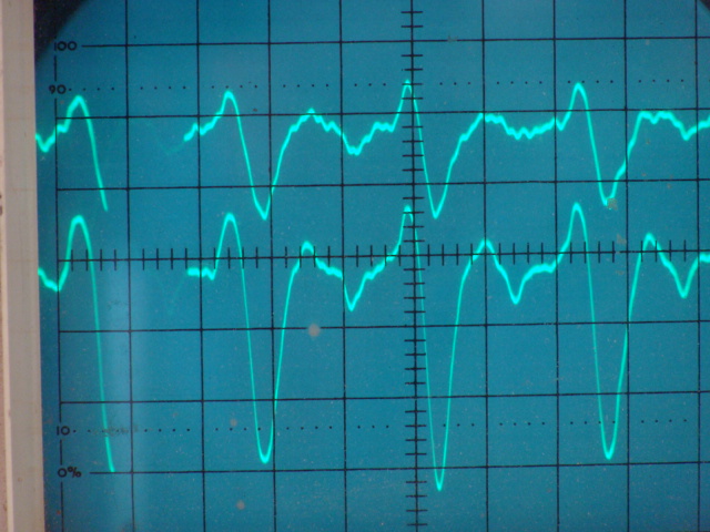

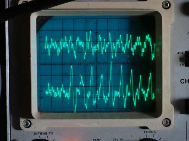

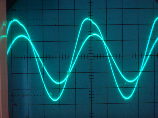

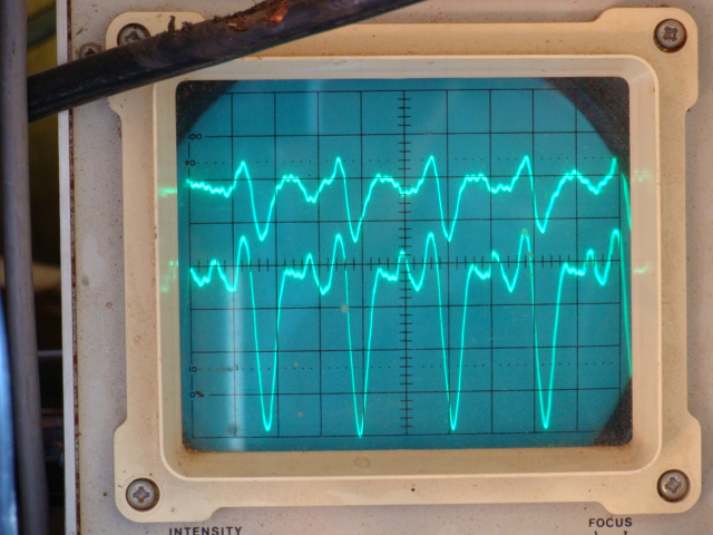

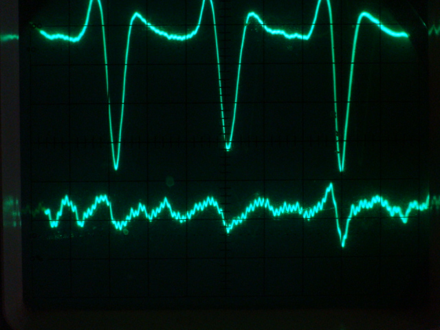

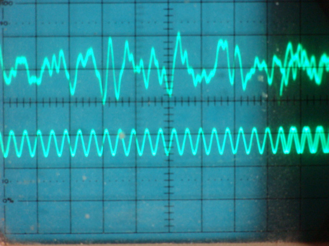

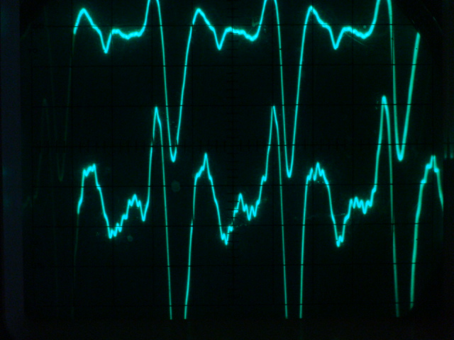

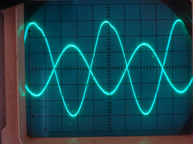

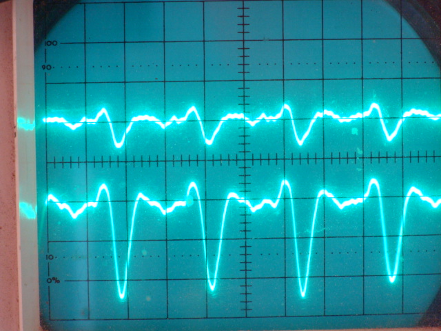

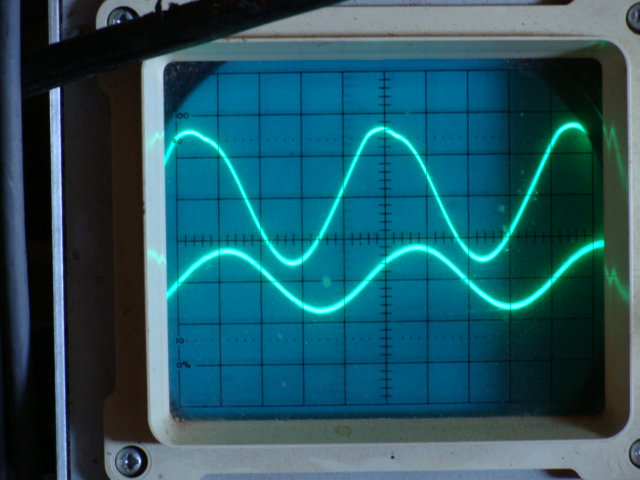

                Here is the next installment I am starting to get the hang of capturing these traces. What works real good is a darkened room, camera tripod and a programable shutter speed. I sped up the sweep just a bit to show the sine wave and used a 1.6 second shutter speed.
                Picture #1 shows a 16 hz sine wave with the GB channel on top.
                Picture #2 is the noise on both channels with the input jumper removed.
                Picture #3 is a 2 Euro + Nickel at one end the stick and a nickel on the other, turning at 28 cm. The GB channel is still on top so the coin signal shows up on bottom trace. I switched the scope so GB will appear on the bottom for the rest of the pictures.
                Picture #4 is with the ferrite stick turning at 14 cm. GB is 50% rotation and still getting beeps.
                Picture #5 is the same but with GB fully CCW.
                Picture #6 shows the ferrite tuned out so speaker is silent.
                The signal voltage on the ferrite at 14 cm was really strong so I turned the scope back to .5 volts/division.
                I hope this is getting closer that what you were looking for.
                Jerry

                  Very nice photos, you've got it down. I would be interested in the vertical scale in each if you remember.
                  Is the first photo GB with RX coil shorted?
                  It looks like maybe double the sweep speed would show your rotating target signals a little better, but advantages to both speeds. The more data the better.
                  It looks like in photo 4 if you turned the GB pot just a hair more it should quiet the ferrite. But ferrite is not always consistent.
                  Photo 5 seems to show how the null signal is "in phase" for one sync pulse and "anti-phase" for the other -- roughly.
                  Given your acquired skills, here is what I'm curious to see:
                  A) Using un-potted coils, null them to one side of mininum, so fairly stable phase.
                  With GB and DISC pots at minimum (CCW?),
                  A.1. Take a photo showing null signal (LF353 pin 7) as lower trace, TX coil ungrounded lead as upper trace. Adjust the vertical resolutions so both signals comparable magnitude. Position them to make it fairly easy to see phase offset.
                  A.2 Then do the ferrite-go-round test showing the outputs of LM308 chips as you did relative to eachother. Maybe twice the sweep speed you used. Note the vertical scale.
                  B) null the coils to the other side of the minimum, about same signal magnitude as before.
                  Take same pics as A.1 and A.2.
                  I can't say this is earth-shattering data, so don't feel pressure to do it. There are so many interesting signals to take and you already got some valuable noise data.
                  However, it should help me confirm my understanding of the effect of ferrite and get some ideas about how our choice of null might affect practical use in the field.
                  Depending on how those photos look, we might want to repeat the test with GB in middle and max positions.
                  Wish I could help more! I'll keep trying to find ways to experiment in noisy environment, or reduce the noise.
                  -SB
