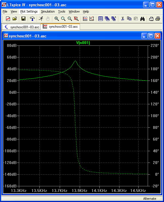

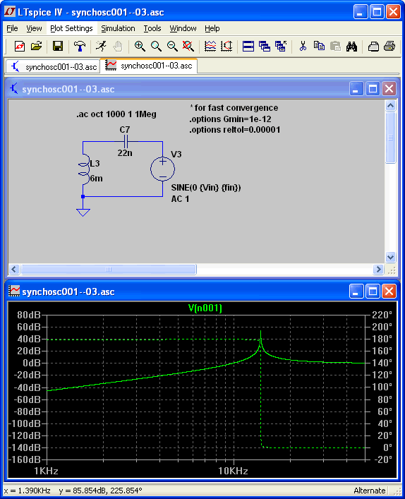

      put this little code into the spice model:
      Code:
      .options Gmin=1e-12
      .options reltol=0.00001
      And step through the input voltage to see the phase shift of the output.
      Make an AC analysis to see the frequency response (at resonance +25 dB, BW approx. 200 Hz)
      Aziz

          Hi Simon,
          the basic idea behind this is as follows:
          Just reducing the bandwidth of the amplifier. Yes, a resonant circuit is also an amplifier, which has it's maximum gain at it's resonant frequency. Outside the resonant frequency, the gain of the amplifier suffers. Totally outside, the amplifier attenuates even. The phase shift at resonance frequency is always 90 degree. The Quality (Q) of the resonant circuit is defined as:
          Q = freq/BW, where
          freq = Resonance frequency
          BW = Bandwidth (3 dB mark)
          What happens, if you reduce BW? Q gets bigger. This is the objective in such applications. Making Q as much as possible.
          Consider, you have a input signal with it's own additional noise on the spectrum. The noise spectrum has a frequency density called noise spectrum density. It's definition is for bandwidth 1 Hz at specified frequency.
          Now, what happens, if you reduce your bandwidth? Let's say to 0.01 Hz! Ok, Q gets quite big. What happens to the noise spectrum? Nothing - still there. Noise spectrum stays same, but the effective output noise (integral over frequency bandwidth range) gets lesser. If you have a very high Q, then you go effectively below the noise spectrum density level.
          High Q means also that the phase is very sensitive to frequency changes. Look at the pictures below for a series resonance circuit. If you reduce the coils resistance, the BW gets low, its gain increases, Q gets higher.
          High Q coils achieve nearly same characteristics.
          The circuit (sychronised oscillator) just implements a very short bandwidth filter (more gain at resonance frequency, lower gain outside the resonance frequency).
          Aziz

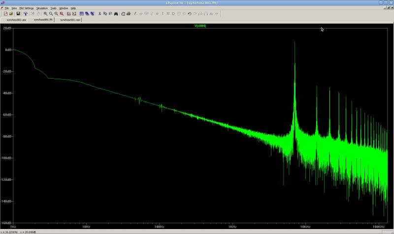

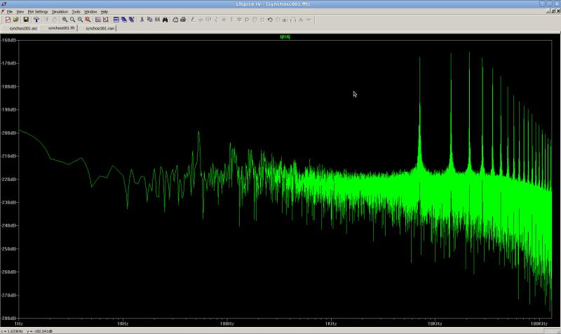

              Hi Simon .... err why are you doing the subtracting ? .... I may have confused you by calling it an amplifier .... it is an amplifier of sorts but in the Frequency domain. Plot a FFT of the input ... then plot a FFT of the output. You will see that the spectrum is "lifted" or amplified by around 100 db or so.
              Actually what you have done though illustrates an important principle. addition and subtraction of Frequency domain signals in the time domain is the same as multiplication and division in the F domain. So you have modulated the signal by attempting to subtract it in this way !!!! vice versa addition and subtraction in the F domain corresponds to multiplication / division in the Time domain.
              See below how the spectrum is amplified ( ie the amplitudes of the spectral peaks are amplified but the phase and freq is not disturbed .... well not too much ... all amplifiers add noise ).
              Below you can see the frequency of interest is "lifted" from -170 db to about +10 db a gain of nearly 180 db !!!! So if you are going to do adding or subtracting to work out gain .... do it in the Frequency domain.
              It makes sense that this is not a voltage amplifier or it would lock onto itself as the output signal is 200db higher than the noise floor and you could never isolate such an amplifier.
              Because this is a phase "amplifier" it is insensitive to a large degree to input amplitude changes .... I think this is a bonus. To implement in a detector ... you need two oscillators one for TX and one for RX .. they need to be frequency locked but not phase locked ( as the coupling and target info is going to do the phase locking )
              For my modification hashup which is not ideal I just set the two osillators to nearly the same frequency and did some testing before the TX oscillator drifted away from the centre frequency of the Rx oscillator but if feel that a frequency locked loop could do the job.

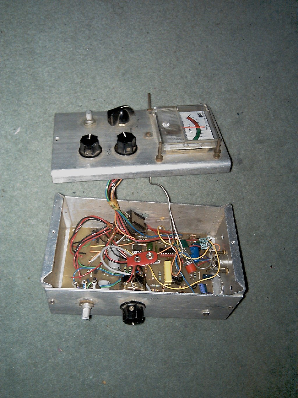

                      Hi Aziz .... yes a successful implementation of the lock-in amplifier would be good to see however I am only looking at the sync oscillator as it is in line with Simons KISS principle. And I may be able to use it for a two box solution as it is very sensitive.
                      Simon .... here is my test bed .... a very old VLF / TR ETI 1500 ... I will see what I can do with it
                      Also attached is a patent describing a Frequency locked loop which uses a different principle than a phase locked looped. So to implement this idea the TX would be frequency locked to the RX and the RX would be phase locked to the TX ... sounds a bit dodgy however in the frequency domain Phase and Frequency can be independant of each other. ( sort of like voltage and current in time domain )
                      I will however try and find a non digital solution to match the simplicity of the sync oscillator.

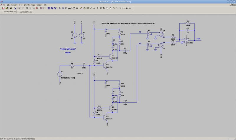

                              FFL control solved ... maybe
                              Hi Simon ... no need for digital control loops ... the FLL loop can be implemented with a simple op amp integrator and two switches. Can you see how it works ...
                              <<explanation goes here ....>> however its late and I am off to bed.
                              The TX oscillator and the RX oscillator are fed into the frequency detector. When F1 = F2 the output voltage = 0 if F1 <> F2 then the voltage will be + / - dependant on whether F1 is less / greater than F2. Use this voltage to adjust one of the oscillators. What is important with this circuit is that phase information cannot pass through only frequency control unlike a PLL ... Make the integration time really long so the oscillator frequency will only change slowly compare to target frequency. This circuit gets a KISS rating of 9/10 I have not drawn the VCO loop yet.
                              Moodz.
