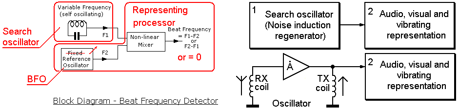

    POWERFUL SEARCH OSCILLATOR for BFO
    (R)EMI group renamed BFO metal detector "REGEN MD" because its search oscillator operates with regeneration (positive feedback). In a specific case (induction balanced regenerator), the amplifier starts to oscillate when there is target. The opposite is also possible (amplifier stops to oscilate when there is target).
    Oscillating circuits invented by Armstrong and Meißner have two windings, ie TX coil and RX coil with mutual inductance. If we place both coils in induction balance, the oscillation stops and TX current is only noise. For sensitive metal detecting with search oscillator, it should use an amplifier having very high gain (A>60dB) which can not be achieved with only one transistor. The amplifier should excite TX coil with large current (i >10mA), which can not be achieved with single CMOS gate.
    Oscillating circuits invented by Colpitts and Hartley are specific case of mutual inductance because is used self-inductance (monocoil). In this case coefficient of coupling is allways maximal k=1 and amplifier always oscillates despite amplifier use only one transistor. The target can cause frequency shift and amplitude change (absorbing metal detector).
    I will use block diagram of Pebe to explain the general block diagram of REGEN metal detector. 'General' means that diagram is valid for all kinds BFO MD. Their block diagrams are variants or specific case of shown below diagram. Note that here block 2 is more complicated than oscillating block, however in project HOUNDOG the block 2 is simply a buzzer.
    The term BFO is used in amateur radio for reference oscillator as shown below.
    Most sensitive REGEN MD is motion type. It uses PLL circuit (for example 4046) for BFO (reference oscillator). The PLL slowly makes beat frequency zero without target (or without motion).
    I stop here with explanation because all is described comprehensive in other my postings.

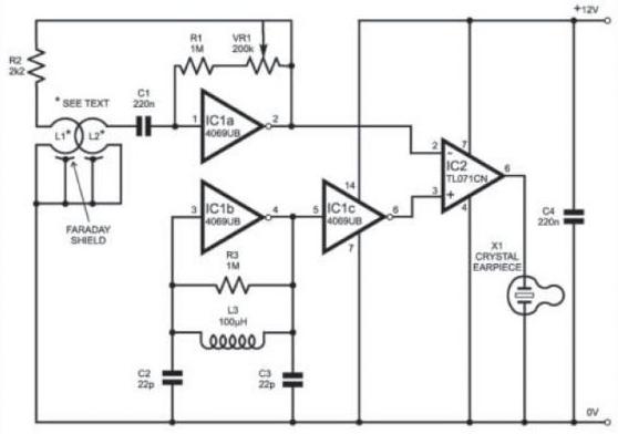

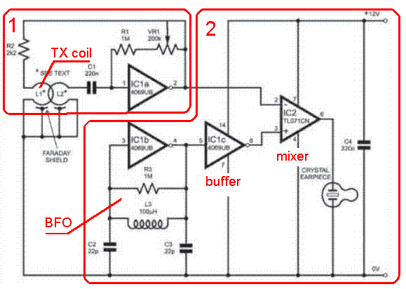

            Some basics for you (who is speaking about two TX coil?):
            BFO (Beat Frequency Oscillation) - Metal Detectors using BFO technology have two coils of wire, one large coil is located in the search coil of the detector, the other small coil (act as RX antenna) of wire is located within the System Control Pack. Each coil of wire is connected to an oscillator that produces pulses of current. These pulses of current pass through the coils generating radio waves. A receiver housed within the System Control Pack receives the radio waves and makes a series of tones based upon the frequencies of the radio waves. When the detector search coil passes over a coin or other metal item a magnetic field is created around the coin or metal item, this magnetic field causes interference with the frequency of the radio waves generated by the search coil. And changes the tone produced by the reciever (of radio waves, and radio waves can be received only by antenna, not by finger, and antenna is coil - always - in this case RX coil).
            PS: Telescope antenna act electrically as coil (inductor) too.
            According to your philosophy on this figure has three coils (L1,L2 and L3). Perhaps it is a hybrid of "BFO-TR"?
                  The "phylosophy" is shown above as two blocks. In other my postings is explained why the circuit of search oscillator operates with reduced TX power with DC loaded output because of incompetent design.
