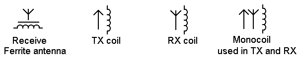

              See below the symbols used in radio world for receiving ferrite antenna, TX coil, RX coil and monocoil (operating as transmit and receive coil). Is it correct to use such arrows in MD circuits to describe TX coil, RX coil and monocoil?
              The old radio term TX (transmitter) at metal detecting should be "driver", or "exciter". The correct term for TX COIL is "Excitating winding" and for RX COIL is "measuring winding". Such terms are used in NDT with eddy currents.
