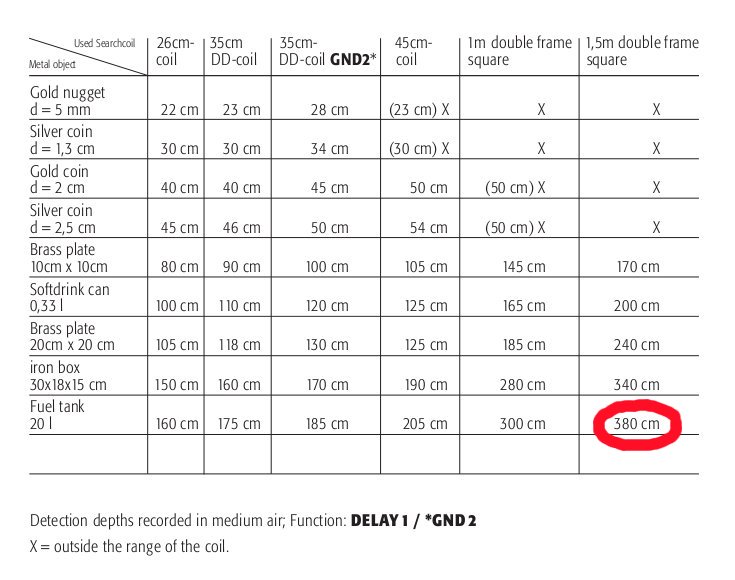

                  According the user manual the maximum depth for the largest test target (a 20 ltr fuel tank) is 380 cm when using the 1.5m square double frame. This is 12' 6", not the 40' claimed earlier.

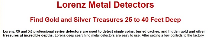

                    Here is what one of the dealers claim:

                      Lol, you are right!!! However, I have heard stories (and seen on TV) where people used backhoe and bulldozers for treasures they "detected" at such depths! Of course, they found... nothing. One of them was in Greece, just a couple of weeks ago.

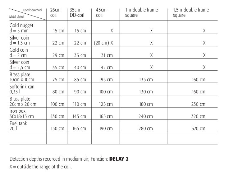

                        From the user manual ->
