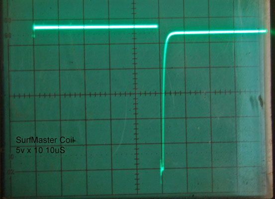

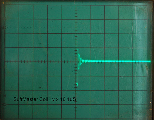

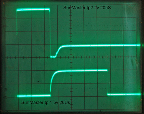

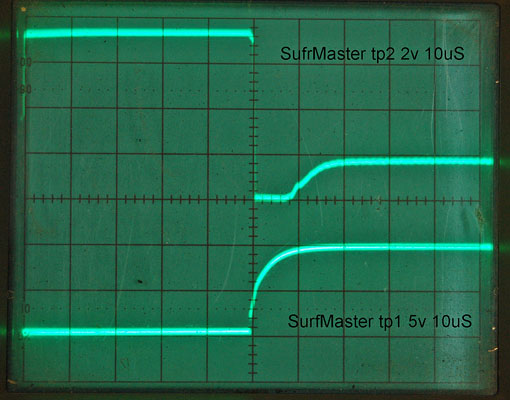

    I have finally finished with the tuning of my Surf Master and wanted opinions on how it's doing. I have also included some o-scope pic. My coil is 7.5 inches (190 MM) OD. Made with 30 stranded Teflon wire. 27 turns 372.8 pF 5.5 Ohms. Made with poly spiral wrap and 3m copper mesh shielding.
    Air Testing:
    Aluminum soda can 15 inches (38 cm)
    1 Euro coin 7 inches (17 cm)
    1 us penny 5.5 inches (14cm)
    It sounds to me like your detection distance is short for all of those targets. It my be partially due to the coil diameter. I'm used to working with 9" to 11" coils on the unit, but I don't think that's the whole answer.

      Probably good for a 7.5" coil. Detection range for a 1 Euro on mine is about 30 cm for my 280uH 10" coil.
      With my 240uH, 9" coil, it drops to about 25 cm, so big difference!

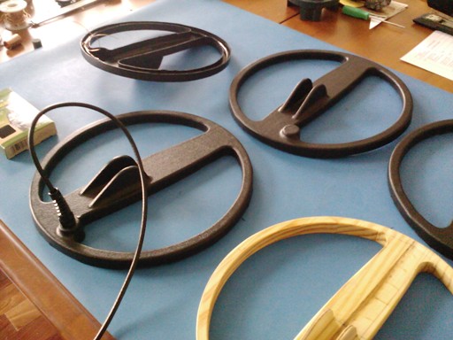

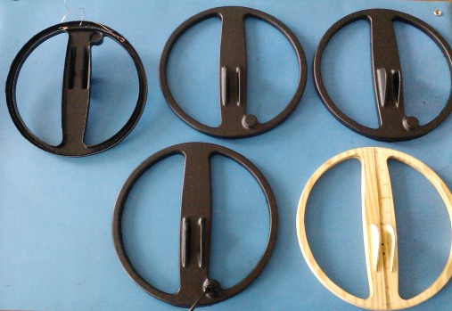

          My coil is 22 Gauge solid copper enameled wire (I think) from Radio Shack. It measures .025" (.64mm). It's the standard "magenet" wire that Radio shack sells in a 3 pack of assorted gauges.
          I wind 19 turns on a 10" I.D. form. I like to use conduct mylar for sheilding.
          Coil measures about 280 uH, 2.4 ohms. I have it set up for a 20us delay using the standard "kit" supplied by Silverdog.
          Cable is RG-58 but a USB-2 cable seems to work just as well.
          Hope this helps.
          Don

                              My real-deal surfmaster needs the Tuner control to be adjusted so that you hear a background "motorboating" tone for most sensitivity. The manual calls it a "click".
                              I'm curious where this repetitivity really comes from, but I don't hear that in your video.
                              Do you use 10 cells? Are they Alkaline? New ones would put you then over 15V but maybe the internal resistance drops that down?
