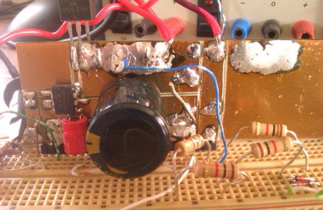

            PCB obviously the way to go when you're design's perfected, but have you ever tried "carving" one with a hobby knife to get the benefits early on?
            I take double sided FR4 and trace out "lands" for parts then cut narrow strip channels to isolate them. Make two parallel scores about 1mm apart, lift the copper with the blade then grab with tweezers and pull up to remove. It usually comes away like magic! Drill through lands to link to the back side (ground plane) and then surface mount parts on the lands. DIP packages can have legs splayed out (or DIP sockets) and proper SM or leaded components can be added at will. I find this a great way to knock up simple(ish) circuits for development while retaining low-impedance ground and switching paths.
            Attached Photo shows Mosfet and driver front-end for rapid test and development on a carved PCB as described. 0.1" header goes off the bottom edge on to breadboard for more circuitry in groups of two or three for easy carving
              nice!

              That sounds like a really good idea.
              I've spent hours trying to file out traces for smd components in double sided 2oz pcb's and would often cut to far and ruined the things, I'm a perfectionist and it seemed I could never get it perfect, The only thing i ever completed using the filing method was a lipo charger (3 attempts later) .
              Cutting sounds like a MUCH better idea then filing though, I'd never thought of that
              Before moving to etching with muriatic acid and h2o2 I would do the toner transfer and the use electrolysis in salt brine to eat the bare copper up. worked ok but acid is way cleaner, I just put tape on the other side if it's double sided
                Give it a try then! Like I said, the magic ingredient is the fact that the copper peels off cleanly once you've teased it up off the substrate to start it off. If you get a batch that's not so cooperative run a heat gun over it to soften the adhesive before peeling. If you're a perfectionist run your hobby knife along a straight edge, but I personally like the wavy look
